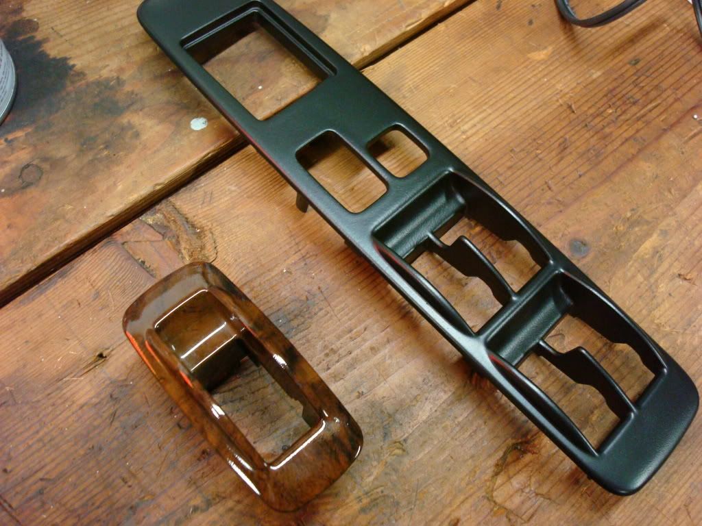

Easiest way to do this is to use Plasti-Dip in a spray can. You can get it at a good hardware store...but probably not at Walmart or Lowes. I get mine at Ace.
No prep (except cleaning, don't spray over grime obviously). And if you don't like it in the future you can peel it off.
Here's what mine looks like...

How has this held up in the interior? Been thinking about painting my wood trim since I got my truck but I have seen these projects turn out poorly more often than not. I like the idea of plasti dip for this project even tho I actually hate the idea of it for most anything but just not too sure about it durability?
plasti-dip holds up pretty well. had it in the inside of my sedan for over a year.
hear are some tips:
-remove the parts. it holds up best if it 'wraps' the part. edges tend to peel, especially in areas where you might be rubbing/touching it a lot
-also be careful what interior protectant you use. i don't recall which brand it was, but it basically softened the plasti-dip, making it really easy to rub off. so, i wound respraying.
-the nice thing about it is that it is easy to peel off and respray if something goes wrong.
