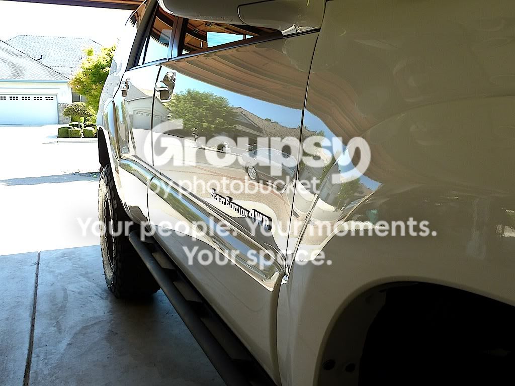

It seems every time I come back from an off-road trip I have "pinstriping" from going up against brush and tree branches. They do a number on the side of the 4Runner. To buff out the pinstriping, after washing the truck, I clay bar it using detailing spray for a lubricant. The clay bar does absolutely nothing to help with the pinstriping or oxidation but it's necessary for removing surface contaminants like bugs, tar, sap and general pollutants that cover the paint (the paint feels like glass after the clay bar). Then I hit it with my Porter Cable Random Orbital Polisher and 3M 39003 Finishing Machine Polish. For areas where there's no pinstriping (like the hood) I'll skip the 3M polish and just clay bar and Zaino it.
mediawebserver
Change out the foam pads and put a few coats of Zaino Z2 Pro. The more coats of Z2, the deeper the shine. Then I finish it off with Zaino Z6 Gloss Enhancer and a micro fiber cloth. Not to sound like a commercial, but over the years I've tried all sorts of different waxes and polishes. This combo has worked the best for me.
Before
P1020666.jpg~original
After
P1020761.jpg~original
P1020748.jpg~original

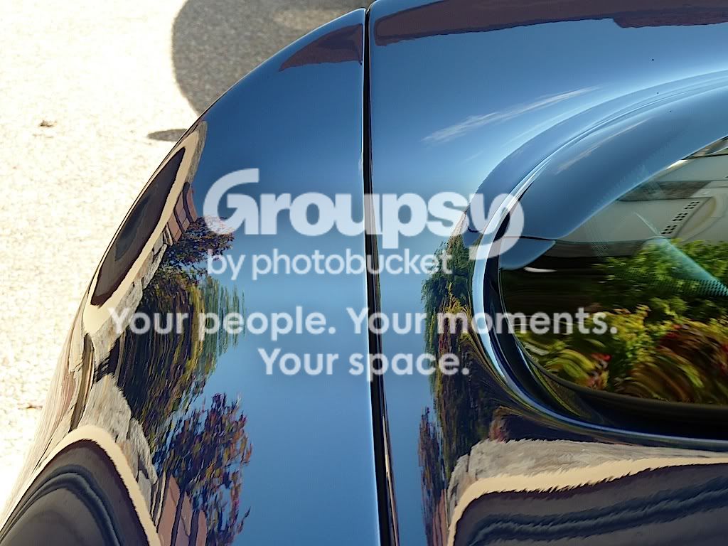

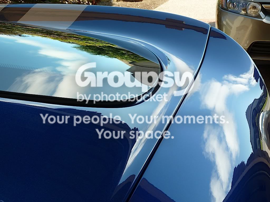

It's hard to demonstrate the gloss under fluorescent lighting and a point and shoot camera but you get the idea. Here are some shots of my Viper after clay bar and Zaino.
P1020759.jpg~original
P1020742.jpg~original
P1020753.jpg~original
P1020755.jpg~original
