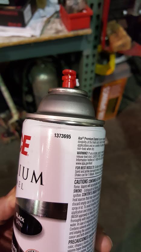

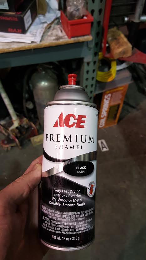

Hey folks, I e-mailed metal-Tech & this is what they said.
"This is what we use in our shop.
ACE Premium Enamel Black Satin. P/N 1373695”
Thanks!
JD
