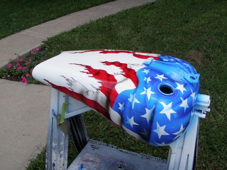

I have quite a bit of experience with painting metal/plastic filler, but almost none on plastic pieces. Here is a pic of the last thing I did that involved paint.
I stretched the gas tank on a honda shadow;
