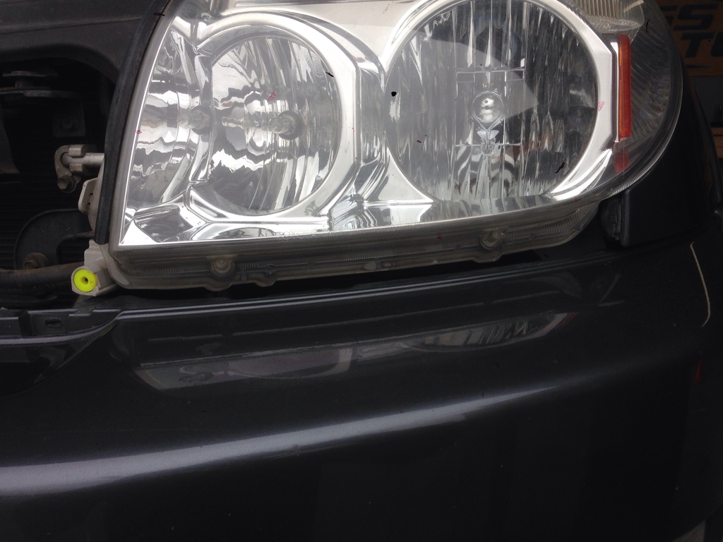

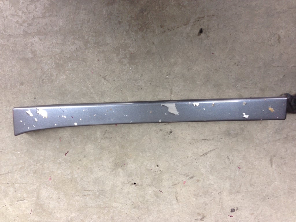

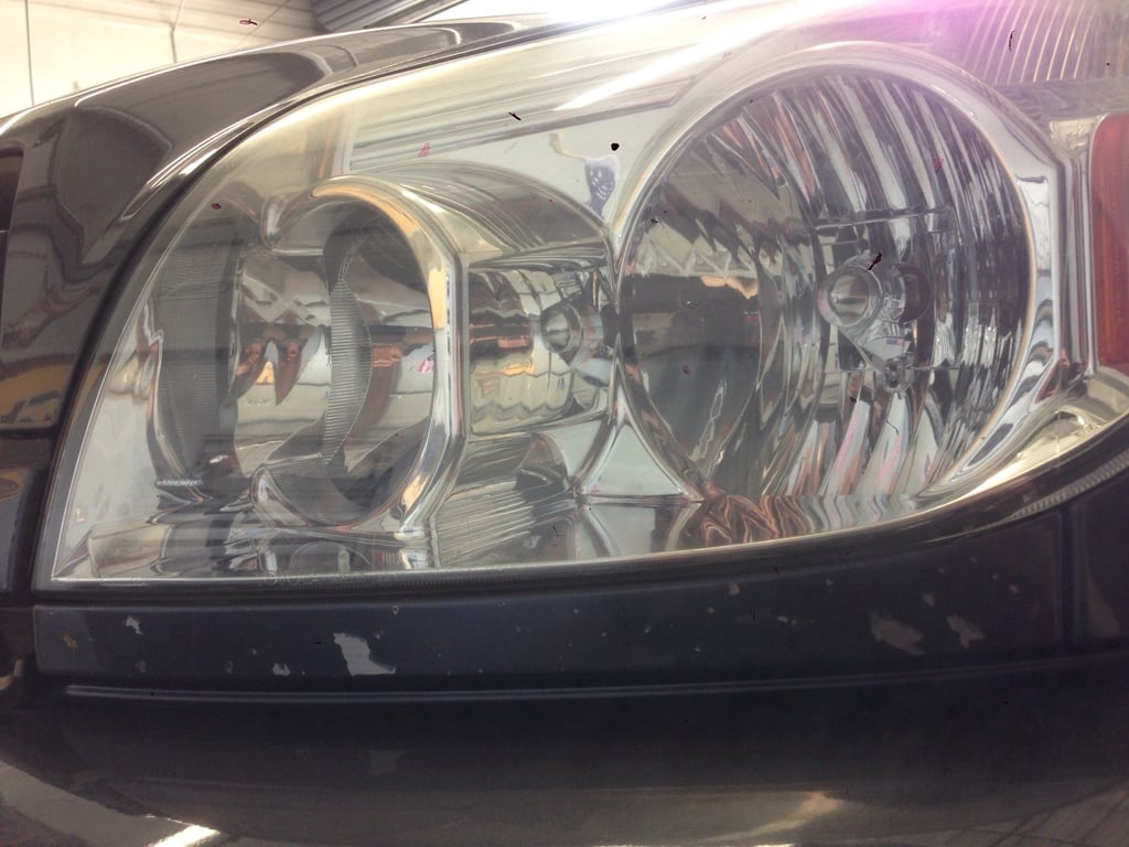

Located just under each headlight and looks like it's independent of any other body part. Anyone painted it by taking it off of the Runner? Is it a pain and do I need to remove the headlights as well? I am wishing it just pops off.

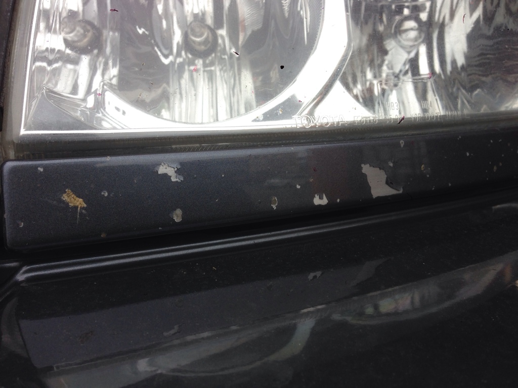

Before:

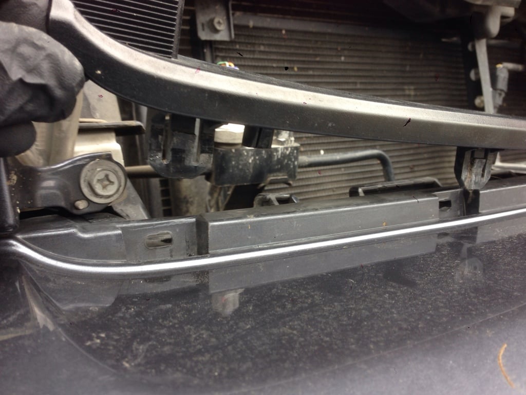

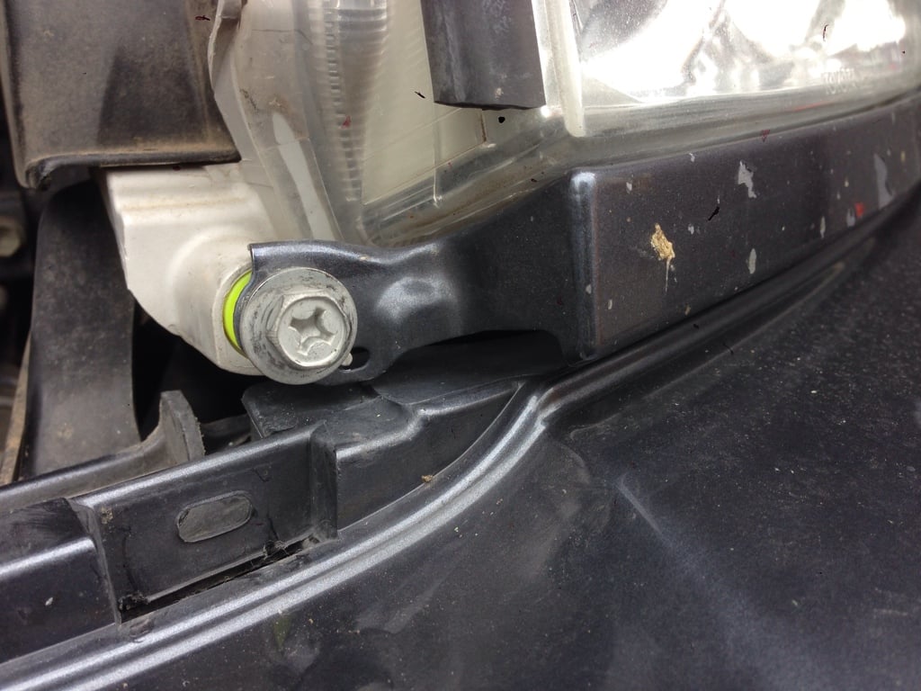

Filler piece between the hood and top of bumper. Unclip by pressing on the tab with a plastic fiber stick and pull up simultaneously.
Remove 10mm screw.
Push tab in to release the panel. Careful to not bend.
Naked.
Removed.

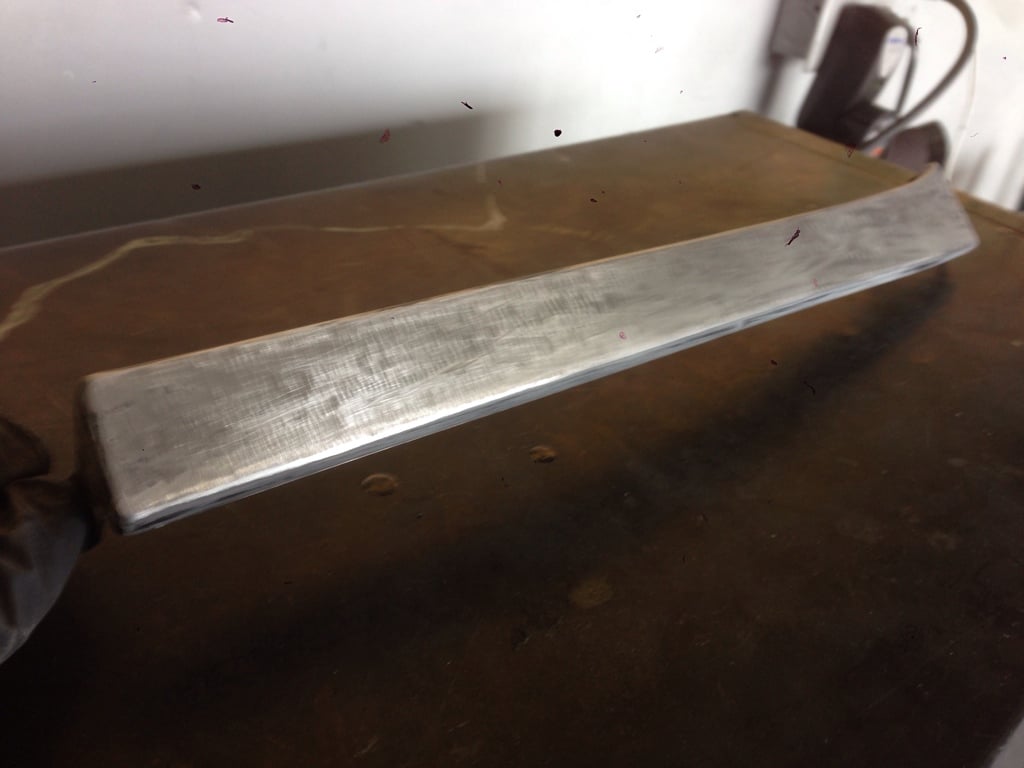

Sanded (I just hit it with a grinder).

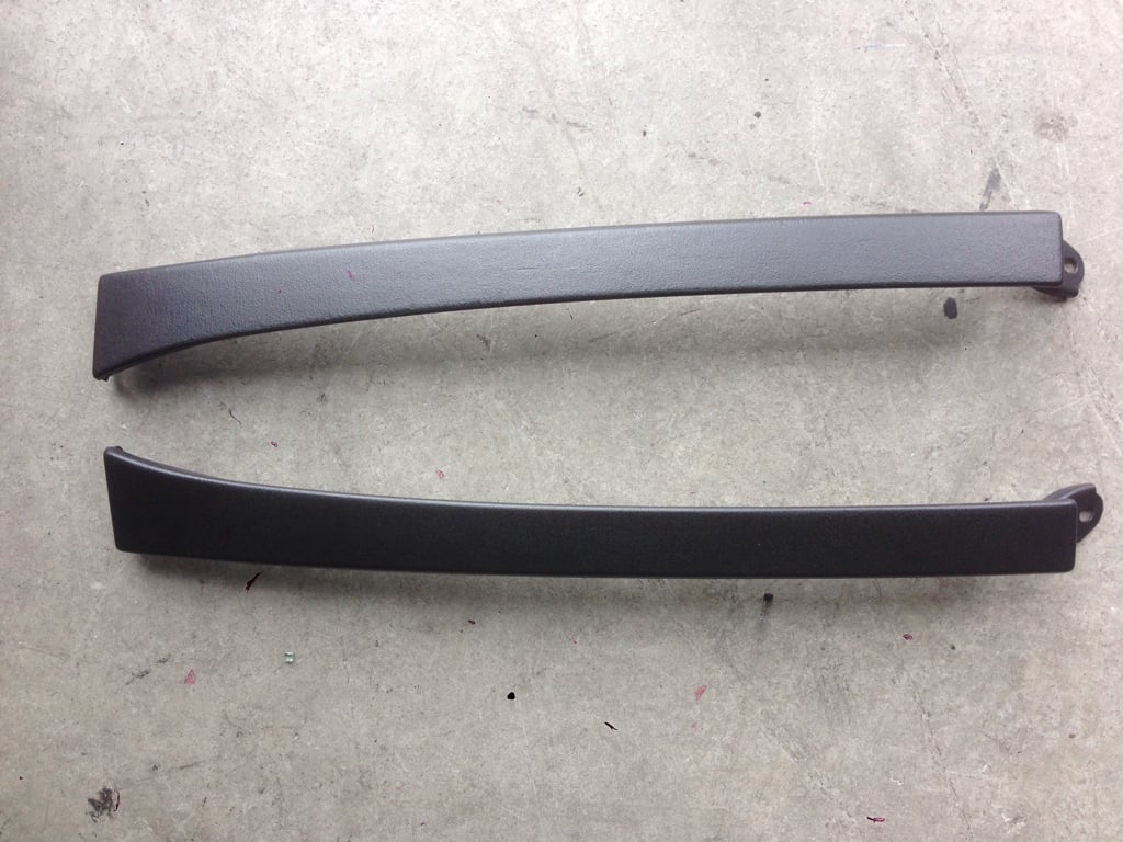

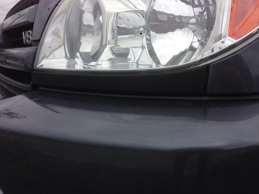

Painted. First started with flat black spray paint, didn't like it, ended with PlastiDip.
To install, simply reverse the process.
Done.

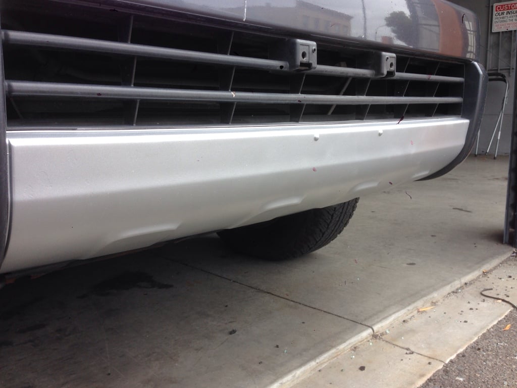

Don't have a before picture, but I also sanded/painted the silver portion of the front bumper as well. Had lots of nickel to quarter size chips.
