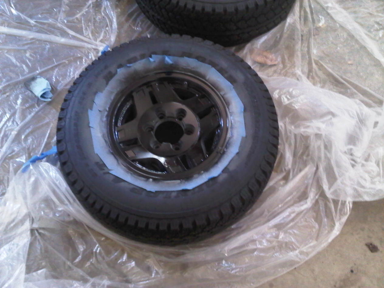

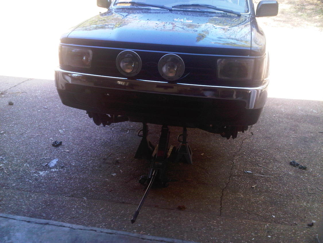

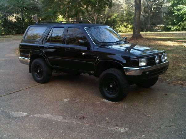

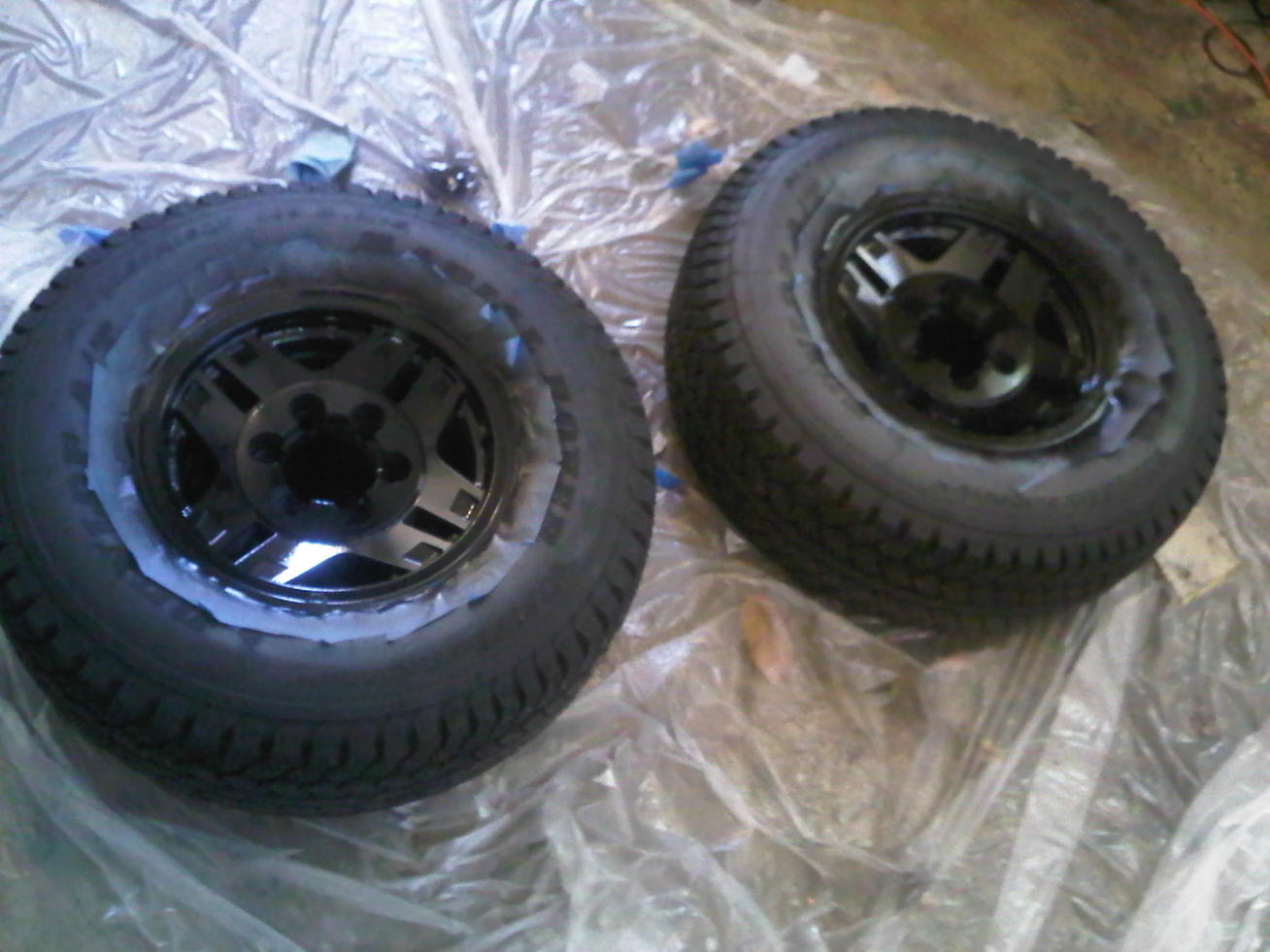

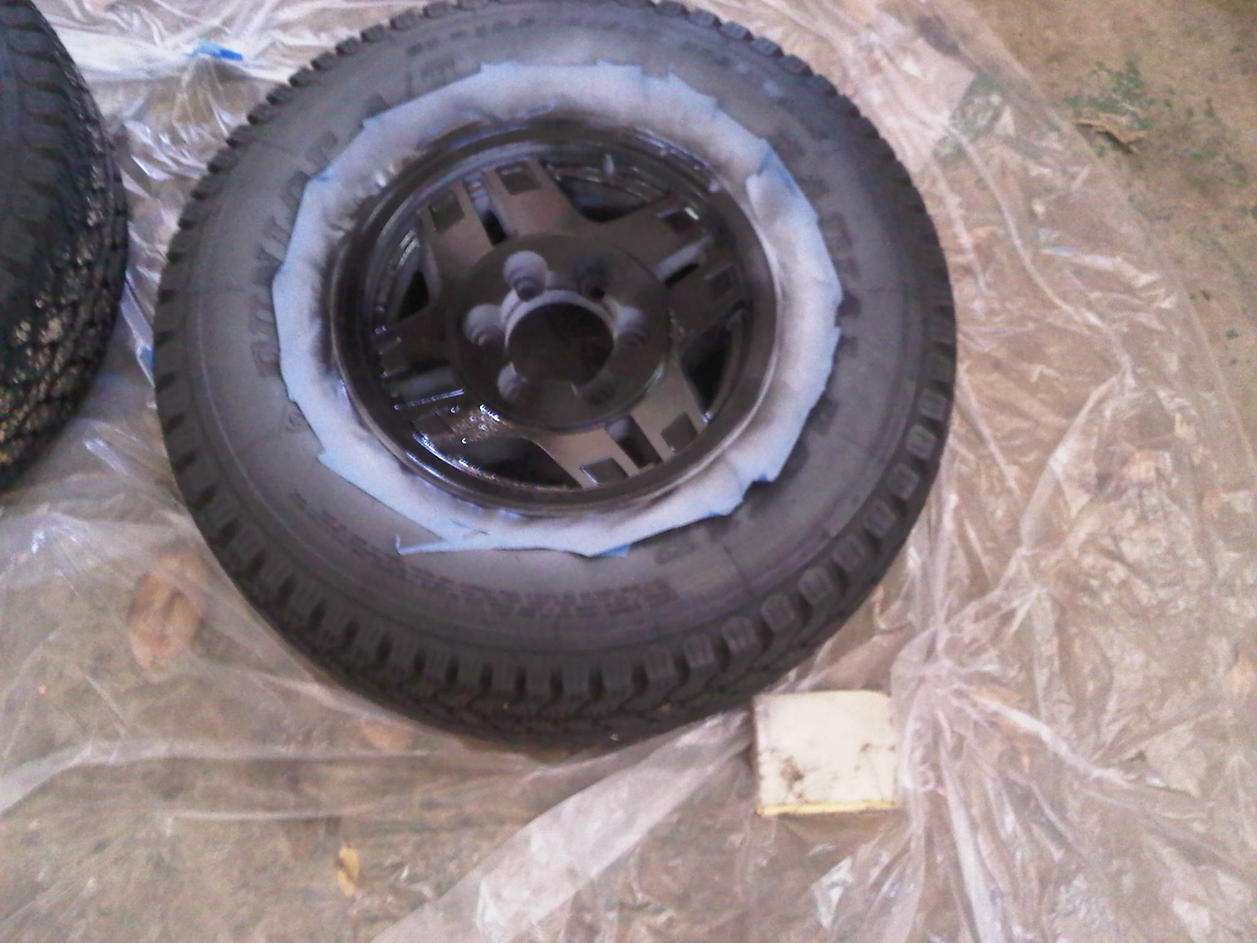

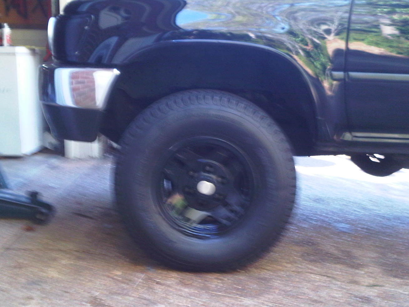

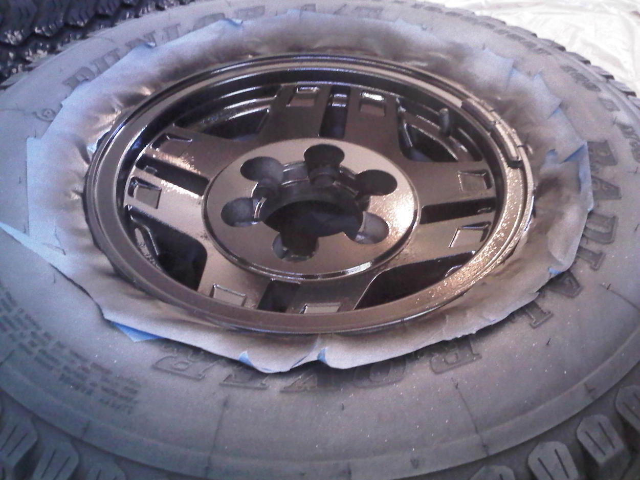

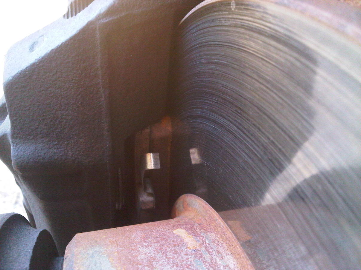

hey guys i decided to finnaly paint my rims this week and i did i them in gloss black . I havent seen any 95 runners with these alloys painted black so i did!! the paint is tough also and hasa super smooth glossy finish here are some pics of the progess i hope to have the rear rims dryed and mounted in the morning!!I also did a front break job myself:frog:

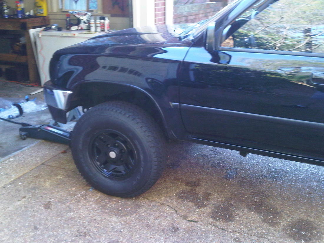

at first i didnt like the gloss look. but then once they were on the runner it looked sick matching the runner itself. well done. :hatsoff:
thanks guys! ill add a pic up today with the rear rims on !:hungry:

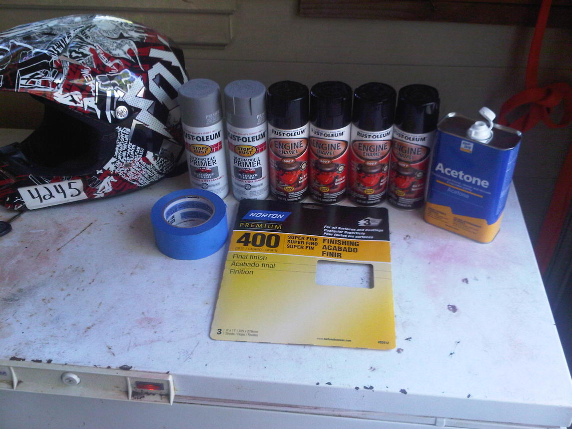

ya man!its oretty straight foward

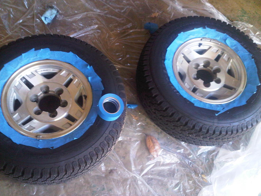

-prep rims_ take the acetone and a terry cloth and wipe all the dirt and grim off then take the rims and wash them with soap and water to make sure there are no chemicals on rims
- masking_ you going to want to take index cards and place them all around the rims in the groove between the tire and tape them down with masking tape
-sanding_take the 400 grit sand paper and sand down the rims you have to do this so the paint has something to bite into make sure to get ALL or the corners and tight spots i also used water so i wouldnt burn throught the sand paper
-primer_ just make sure you use a good primer and you want to apply 3-4 coats not heavy coat or the paint will drip and run allow 10-15 min in between each coat after you have covered the whole rim with primer and it is all smooth then allow for primer to dry for 30 min
-paint_ ok now you can use nay color paint you want i used engine paint because its durable and will resist a beating. you want to be 6 to 10 inches away from the rim so the paint is evenly applyed i used about 5-6 coats checking for drips and runs each coat allow rims to dry 35 min let them dry over night in your garage and then mount them in morning
GOOD LUCK! and one more thing make sure you got the whole day to kill and plenty of beer!:beer::beer:
