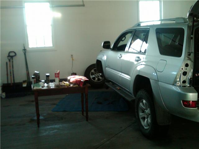

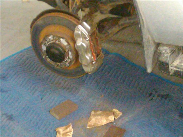

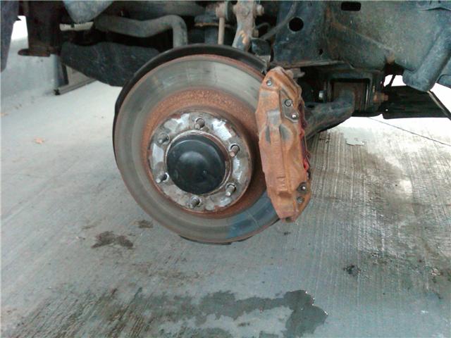

Got started today but managed to only get the rust off one caliper before I ran out of sanding pads :dammit:
Hopefully have it done tomorrow.

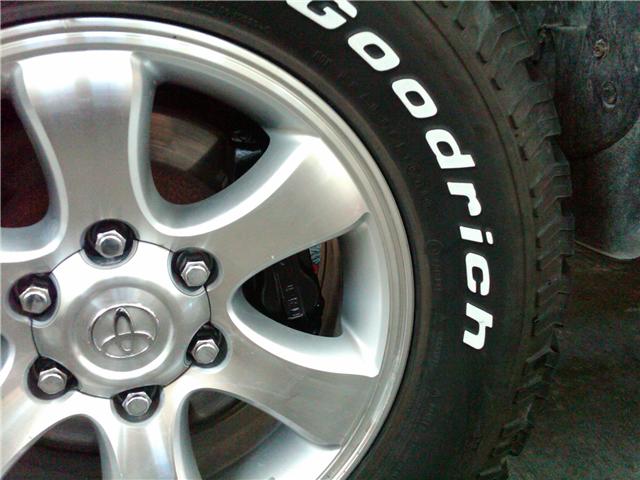

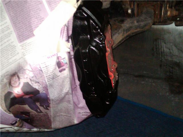

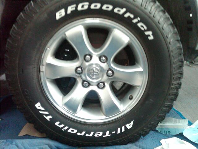

Finished this project today. Took about 4 hours. Very easy to do and I'm happy with the final result.

Hey that really looks great. Though since we both have Titanium Runners, I wish you'd have painted the red so I could see how taht would look. :naughty:
