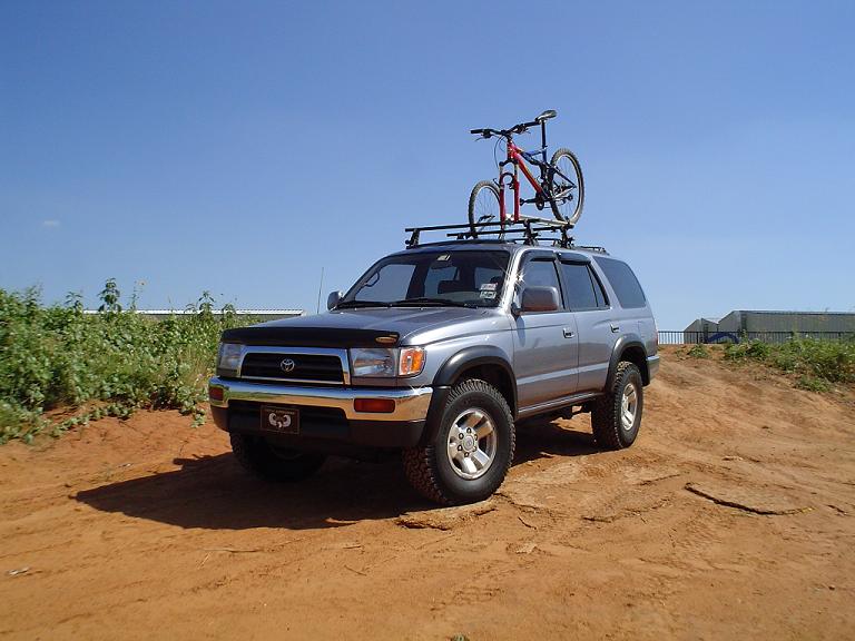

Got them installed. Should I paint them or leave em alone?

on that color imo id leave em alone.
best thing to do is kinda put a blue sheet or something over it to see what they would sort of look like from a distance.
they do look mighty fine though

Are those bushwackers? They look smaller to me than the limited flares. Do you have some closer pics?
Either way, I think it looks good black. Unless you plan on matching other pieces such as your bumper, I'd leave them the way they are.

They are the Extend a Flare. I think there was a set bigger though.

yea really they just look like sr5 flares.
you should paint them an intresting color thats not stock for fender flares for 4runners

I looked at the pic again and they are bigger than SR5 flares. Also, I'm not sure if bushwackers make a bigger set of flares but I doubt it.
To me, they look good but they don't look as beefy as the limited flares look b/c they're not painted. The bushwackers I've seen have been painted so they look like the limited flares. Something to think about but w/ your color, it looks good as is...
I like the Bushwackers over the Limited since they don't stick out so far past the width of the wheels and are a nice fit inbetween the pre '00 SR5 flares and the Limiteds.
