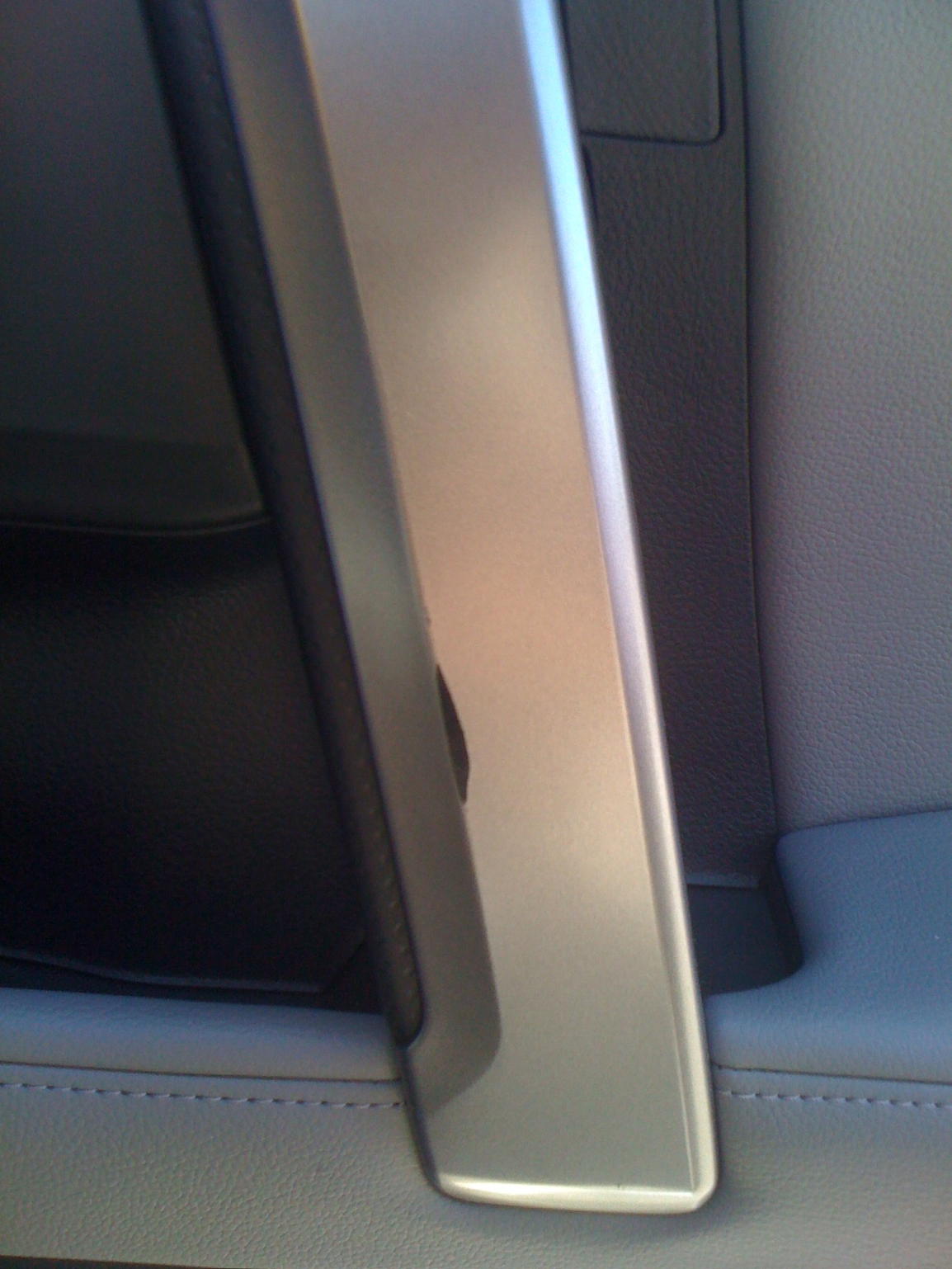

I don't have a pic of my own door pull, but found one from someone else's thread. This is the part I'm trying to remove without breaking so I can wrap it. It really would look so much better with silver or graphite carbon fiber on it, and protected too.

Hydro-dip is a solid option for sure, but wouldn't have the carbon texture (i.e. real effect) that you would get with the wrap. At the Di-Noc price point, I would just re-wrap it if it ever started looking like crap again. My trouble right now isn't whether to hydro-dip or wrap... it's how to get the damn piece off without breaking it (and going in the hole $900+ for replacement). Reading over the threads since I bought the truck, you guys have all been super helpful. Y'all have done some amazing mods... far beyond my capability and resources. I'm just hoping for some guidance to get this one little itty bitty piece of plastic removed safely. Any additional help would truly be appreciated.

Those silver door handle pieces are part of the door panel assembly and not meant to be taken off. That didn't stop me though as I drilled the plastic rivet tails off that were heated and squished to hold them.There are some screws too .I had to take practically the whole door panel apart after taking it off to get the handles off ,including the switches and window seal/felt to get them off and mostly a bunch of screws and little clips. It was not a 5 minute job!I used a drop of 3M 2 part epoxy in place of the plastic rivets tails I drilled out.
Damn, this is what I was afraid of... not the easy answer (or the way Toyota should have designed the piece to be removed given such crappy paint)... but excellent information as always [MENTION=8206]harper7[/MENTION]. That's a sick vehicle you've built for yourself. If you ever want to share pics of what you did to those door pulls, I know me and others on the forum would be real interested to see them. May just motivate me to do what you just described. Thanks for your time and info. :thanks:
