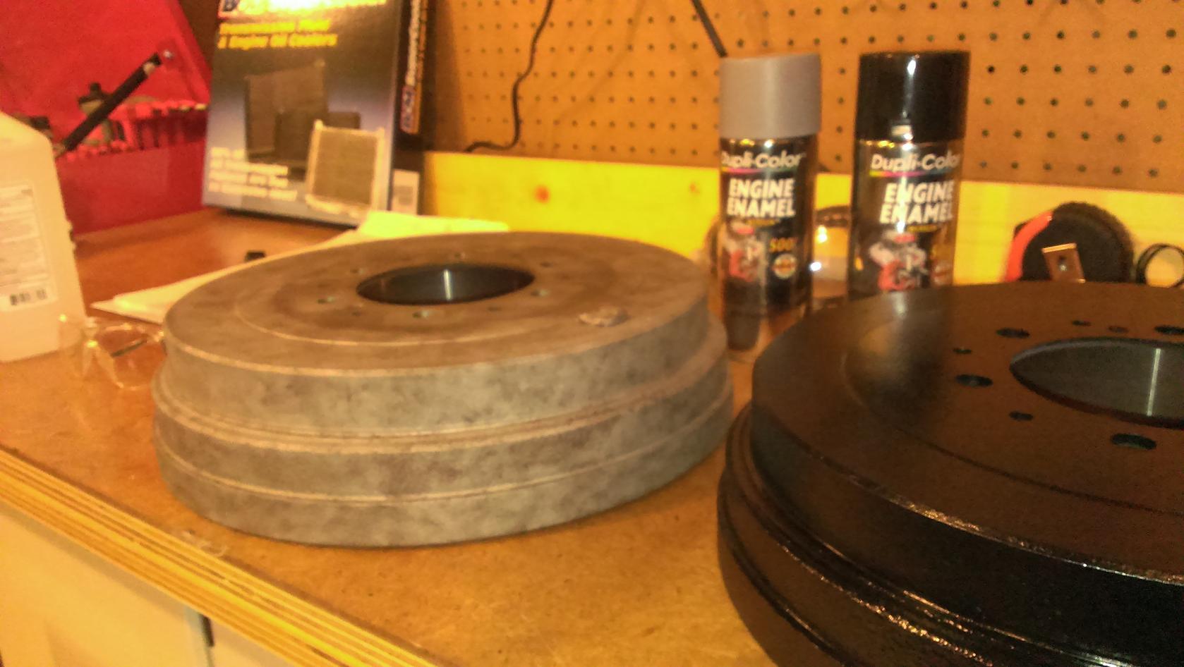

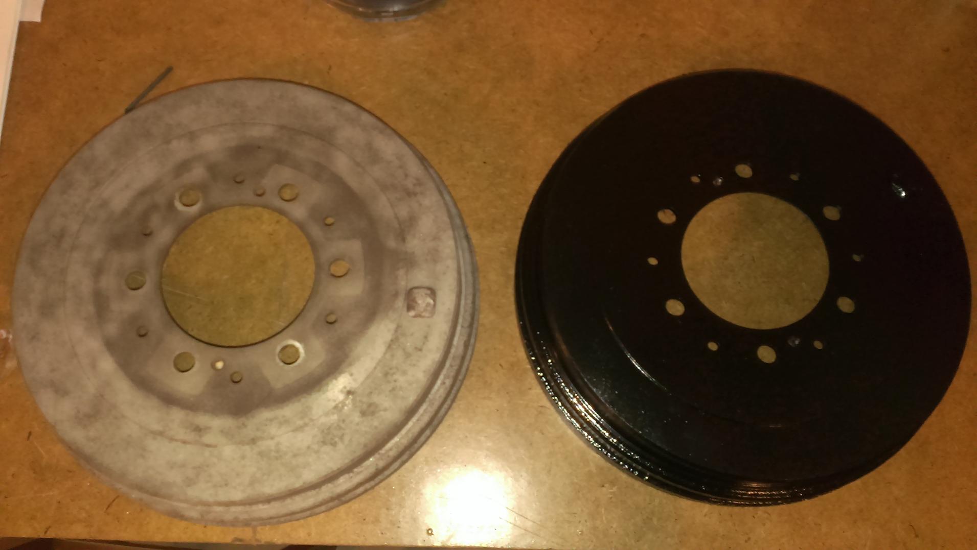

lets face it, there is nothing sexy about drum brakes, the only thing you can do is just make them look a little better, I like the black gloss look a lot better than rust, I painted up my drums this weekend mainly cuase I just wanted to figure out my new sandblaster ( in preparation for some underbody blasting next week prior to some por-15 rust converter ). ive had drums powder coated before and even used non- high temp paint rattle cans and have had great success with both of them, but I wasn't in the mood to drop 100$ on powder for some old nasty drums, and generally stray away from eye catching colors like red, when it comes to the calipers that's a different story. there isn't a right or wrong way to do this but my drums popped right off no problem, hit them both with the sand blaster for a little bit till ( most ) of the rust was gone, then gave them a wipe down with some acetone and sprayed them with dupli-color engine enamel primer, and gloss black engine enamel. they came out pretty nice, ill post pictures of them on the truck later tonight.

you could paint them with them still on the hub, but I found it much easier to sandblast and prep for paint with them taken off, there are tons of ways to shimmy them off the hub. even cheap rattle can black drums look way better than rusty ones, even if they need re-done once every year or two, other than some elbow grease youll only have 5$ bucks in high temp paint invested in the project

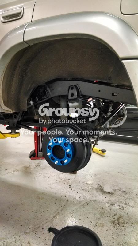

I just did mine yesterday, painted them on the hub..although it was easy because I replaced them and the leaking axle seals...
