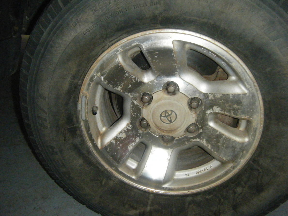

These wheels were in horrible shape. Just cosmetically, no curbing or deep scratches. The finish just had a bad spidering corrosion thing goin on and it looked like crap. I like the wheels themselves and decided just to paint them instead of swapping for new ones.

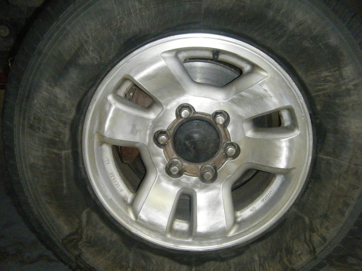

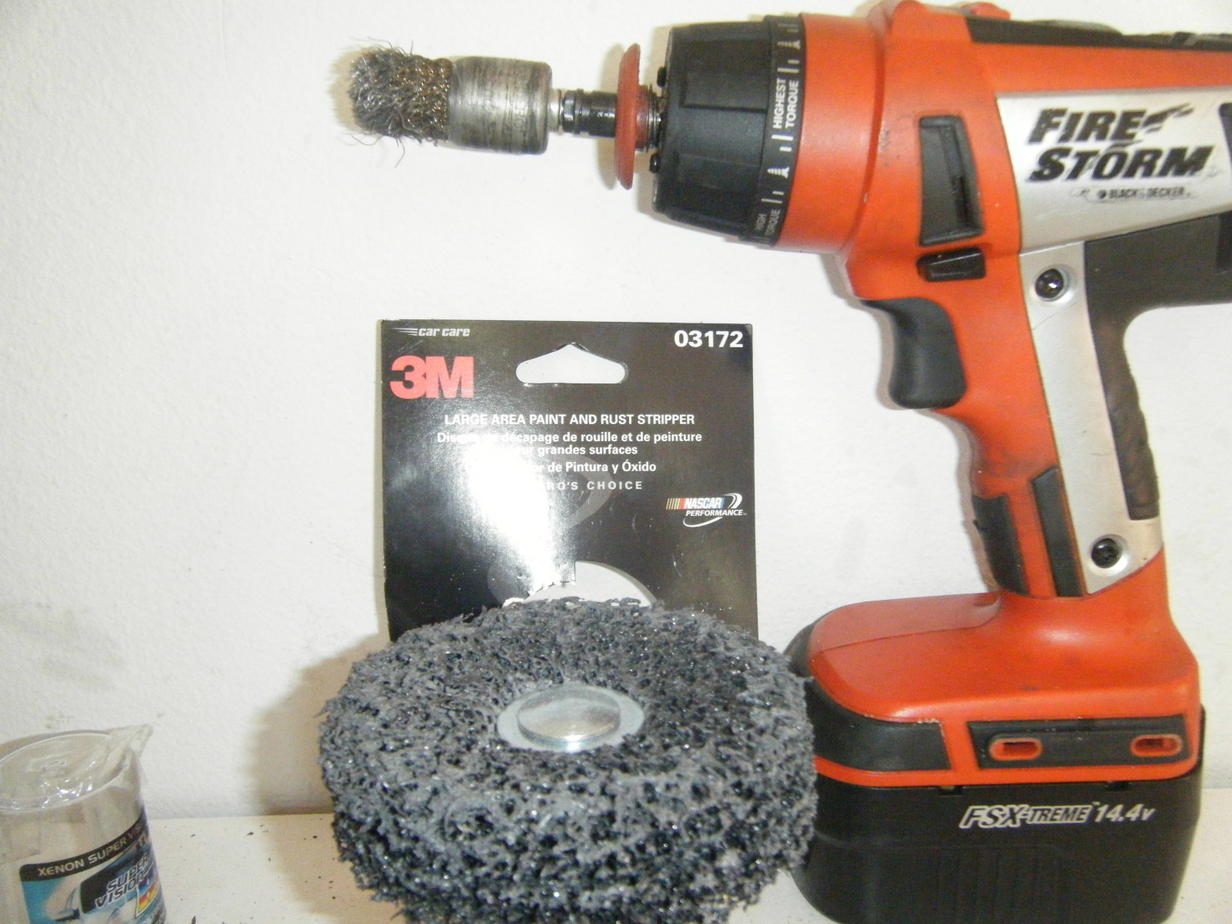

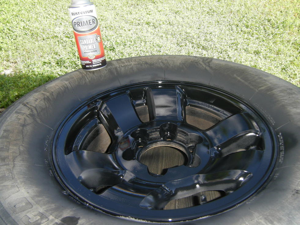

The worst part was getting the old finish completely off. Bought a nice sanding wheel and it worked out great. I did end up giving up on the drill and opted for the air gun (more RPM and the batteries don't die). Cleaned them up with brake cleaner and then went to priming and painting. I used Rust-Oleum black primer and Charcoal Gray for the finish. I didn't bother taping the tires off as I have received my Kumhos and they will be on shortly.

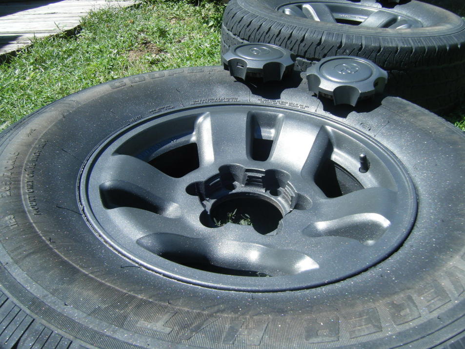

I don't know if I like the "flat" finish or not. Maybe it will grow on me, or I may have to fine sand it and clear coat.

I only have the two done right now. They're actually drying as I'm typing, just sprayed the 2nd coat. I'll get install pics after the weekend when I'll have the new Kumhos and Toytec lift. I highly suggest getting the 3M Stripper wheel, it worked 10x better than my wire wheel.

Yeah I know the oversparay looks like dirt for a couple days but I'm slipping the new Kumhos on tomorrow if possible. That's why I didn't care about the overspray
