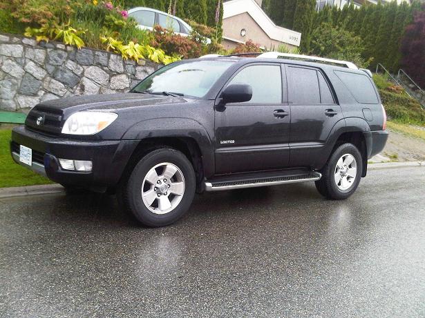

Hey JAC...
I want to paint my from and back middle bumper pieces on my 2004 limited. Would you mind giving a little step by step on how you painted yours. Did you remove them ? What exact products used?Have they chipped? Do you think you could paint the roof Rack?

Thanks JAC, I actually saw that pic in the thread I was reading the other night. The lighting seems bad in that picture because the bumper disappears in the shadow/grille. I think in daylight it would be easier to distinguish and that the contours in the bumper would also be visible. Also in the other thread, like this one, the idea was suggested for a white 4runner which is what I have
I believe that is the only 4r here with the middle section of the bumper blacked out. I just posted it for the interested to have an idea.
There is Simple's white runner but he just got the grill blacked out. I think it looks awesome.
That looks good, but we're all talking about the silver piece. I'll just be the guinnea pig and paint the silver piece black later on this week for the white 4runners.
