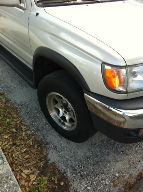

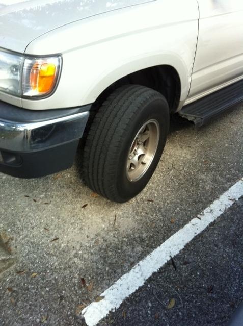

Well, i've decided it's time to paint the faded fender flares. After thorough research through the forums, i'm unable to find an answer to my question:
1. What paint do you guys/gals recommend? I've heard a few things about Rust-O-Lieum, but it seems that the better product is SEM (according to a auto paint supply shop).
2. Is the color just a flat black? Only reason I ask is because the fenders look to have a grayish tent to them (probably due to age, sun, etc.).
Below are a couple photos, one with them on, and one with them off. I plan to sand with 300 or so grit, then a wet sand with the same grit, dawn soap to remove any grease, and let dry.
Any words of wisdom would be greatly appreciated! :guitar3:

I used a bumper coating as the main paint instead of traditional paint since it should hold up better and I didn't want a real glossy look to them. I cleaned them with the prep spray and then used a solid coat of adhesion promotor and then laid down 5 coats of the bumper coating. Came out looking close to OEM but if it fails to hold I will give straight paint a try but so far they look good after a few months and a couple of snowstorms. I do still need to try it on the lower valence but that'll have to wait til spring.

@RonMAIDEN - That looks real nice. So Dupli-Color is what you went with.
It does look very close to OEM. I spoke with a SEM rep, and he said the black was more of a satin as opposed to a flat, but not a gloss. I'm a little worried it may be too glossy..
Overall very nice job. Thanks for the response.
I have one vote for Dupli-Color, anyone else?
I used SEM on my trim/bumper but they did not sell duplicolor where I bought my paint. They are prob equal is terms of quality.
