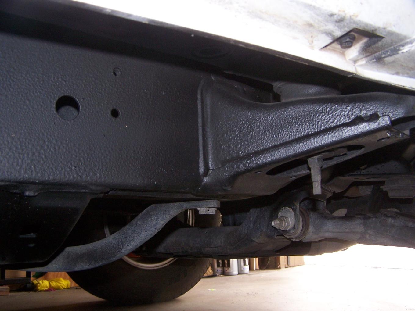

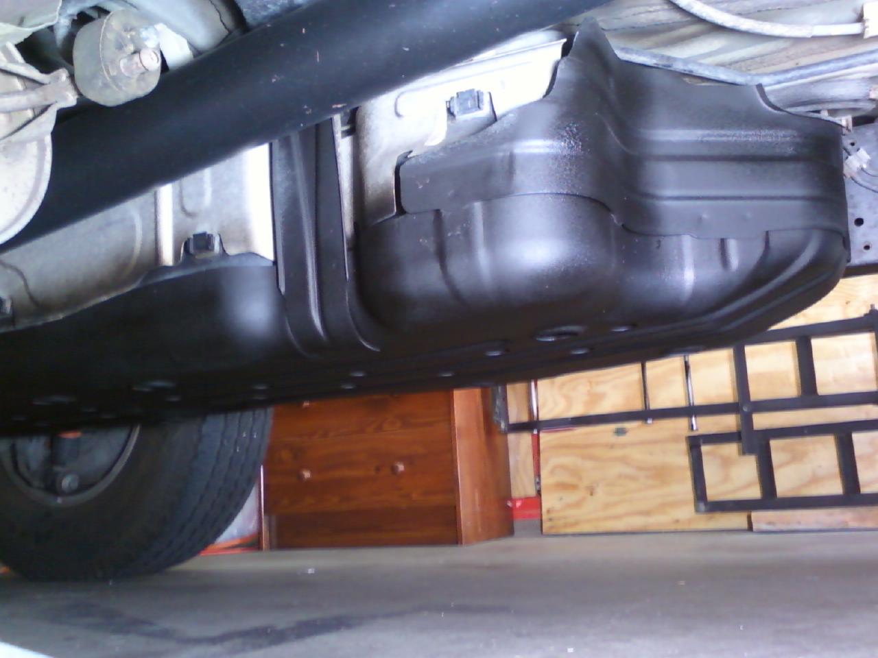

What kind of apperance are you looking for? I would personally reccomend an dedicated undercoating or truck bed liner as it will protect the undercarriage. It might not look as nice as smooth paint but it will help proctect the vehicle if you take it off-roading.
go to walmart and look in the automotive section. they have spray cans of rubber undercoating for about $4.00. do not use the "pro" grade, just buy the cheaper cans and go to town. i have done the entire underside of the truck and it holds up great.
heres a few pics of it so you can get an idea.

Thats great, just what I'm looking for. I don't need it to be perfect, I just don't want that faded gray look. Should I avoid the diffs and t-case where the drain and fill plugs are? And also the oil drain plug? I don't want to paint those shut obviously...
just make sure the metal is somewhat clean before you start and have a wet rag handy incase you get some overspray some place you don't want it.
you can spray over the plugs and then wipe it off. i sprayed over mine then cleaned them off with the wet rag. even if you don't, it's not going to hurt anything. get yourself about 6-8 cans so you can do the fender wells also.
best of luck and keep us posted.
