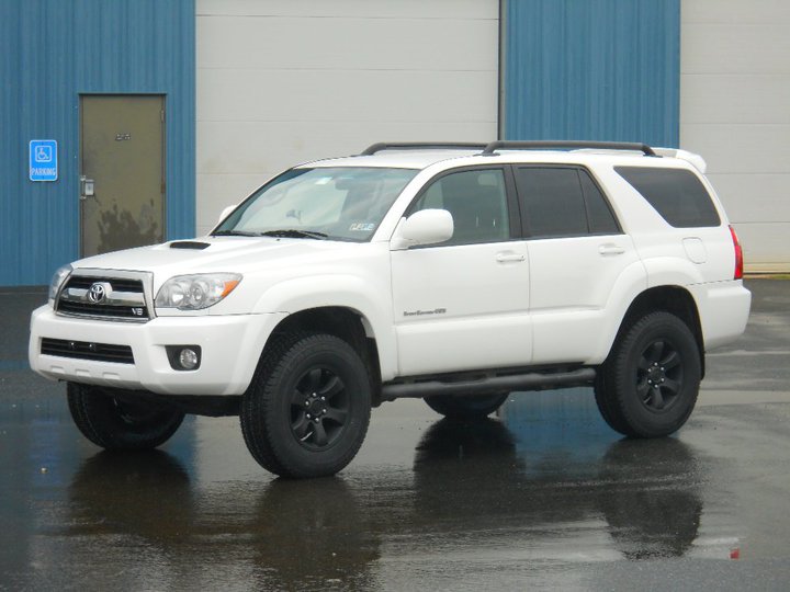

i sand blasted them and painted them myself. I sand blasted the center caps too. I primed and painted them with rustoleum spray paint. they came out great. You'll want to use fine sand as the course makes larger pits in the aluminum.
here is a pic of mine painted

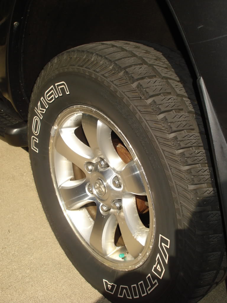

I recently purchased a '04 4Runner. In general, It's pretty clean. But the rims have some pretty nasty corrosion. I'd like to get them restored (assuming that is possible). Just wondering how much it would run to have them sandblasted and powder coated. Any info/opinion is appreciated.

Cost me less than 50 bucks with plastidip. Light sand. 5 or 6 coats. Or a can a wheel.
What's the best way to address one or two areas on the wheel. I have corrosion just where somebody used non coated wheel weights... is there a color chart or touch up for wheels vs auto paint???
Color?
Hey mizak82 what color Plastidip did you use? I like that gunmetal grey, but wanted to know which color you used. So, just sanded it down and then started spraying lightly? Wow, it looks great!:pop2:
Gunmetal looks too flat grey. But it's cheaper than the Anthercite grey.
I used a few base coats of gunmetal. I used a half a can a wheel. Then a few coats of Anthercite grey.
I did not use the glossifier. I was up in the air about it. I prob will do that eventually. But I will say this matte/flat color does not show brake dust.
