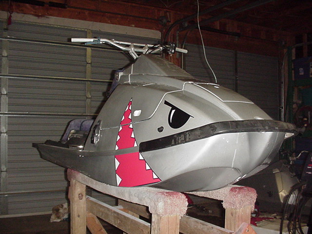

yhis is cheap ass Nason clear coat over vinyl stickers. been on there for 10 years, no problems. Unless you ever want to change stickers...

I've seen the decals under the clear coat on newer bikes, thinking technology may be advanced enough to allow for this. The jet ski is a good example too, I might do it.:lightsaber:
