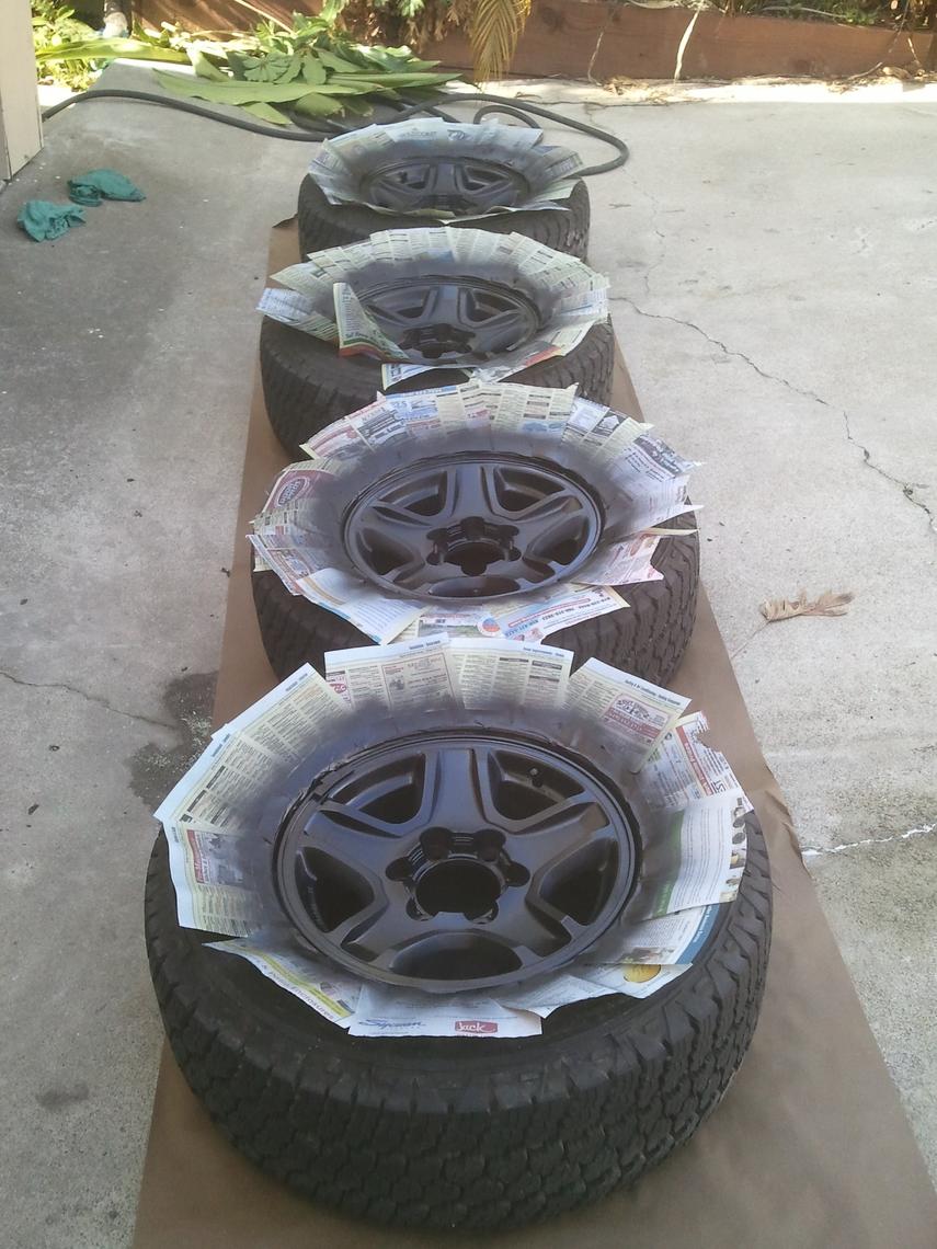

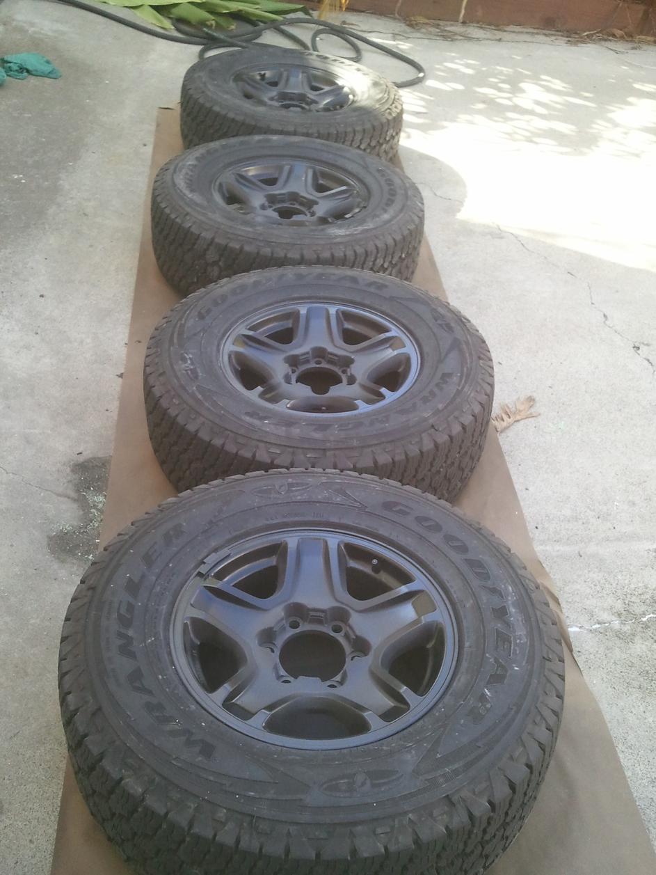

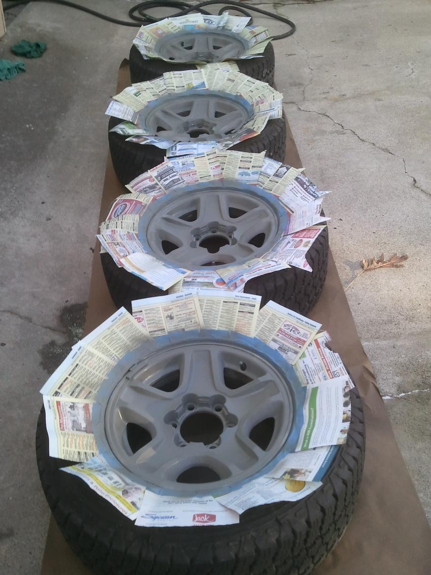

I don't know much about the look and durability of plasti-dip, but I painted my wheels and they came out great, and have held up extremely well through 4 months and 8-10 off-road adventures. I sanded (futile) then used aircraft aluminum paint remover (TAL-something). Primed with self-etching primer (2 coats):
2 coats of flat black rustoleum primer:

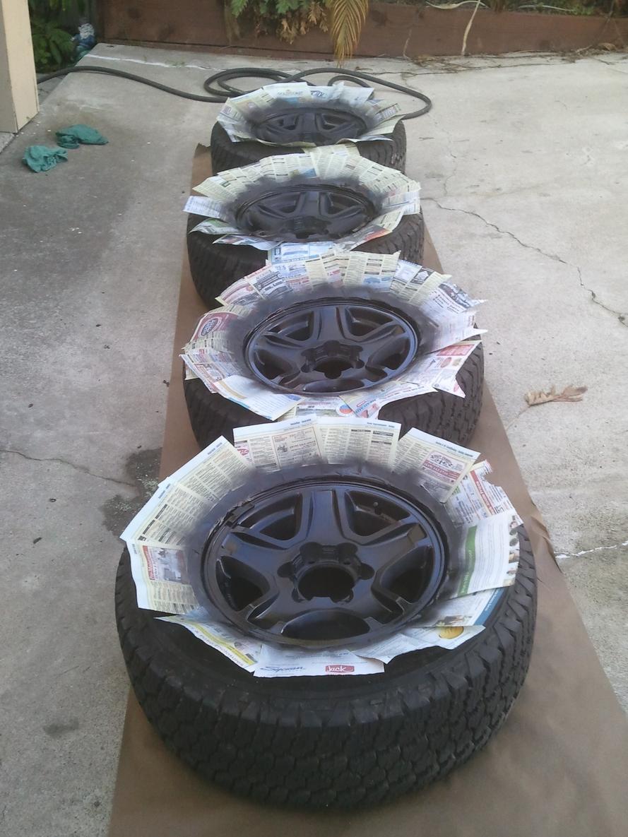

3 coats of satin black rustoleum top coat:
3 coats of satin clear rustoleum clear coat:

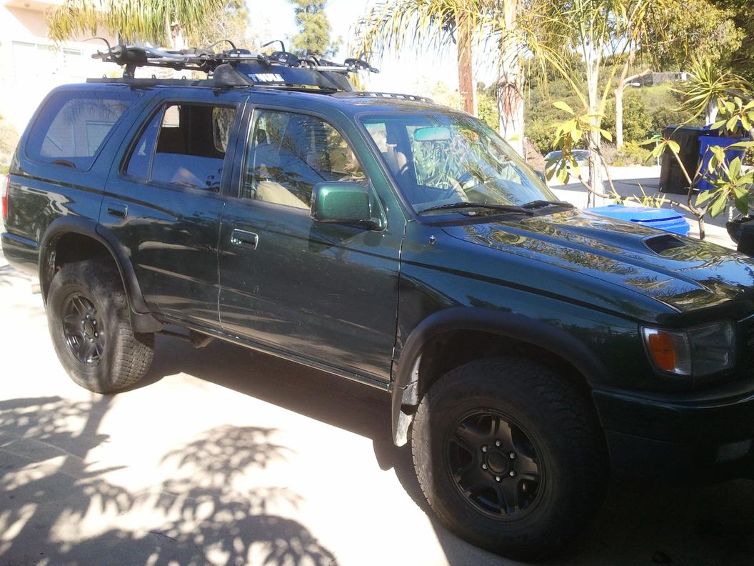

End result was very clean and durable:
Took the entire day though, and that was blocking my whole truck up on stands which made me nervous!! Good luck!
