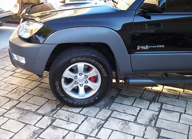

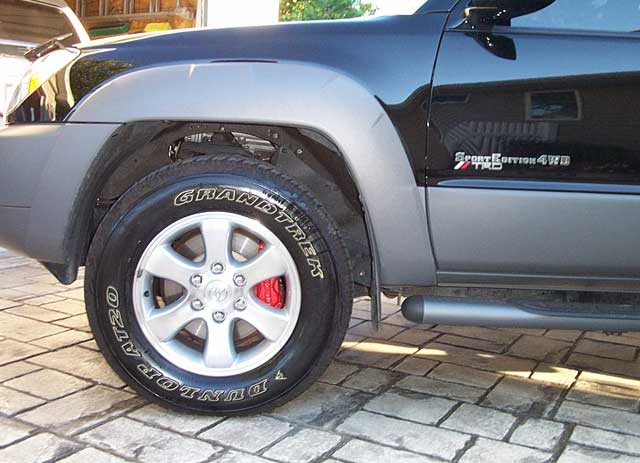

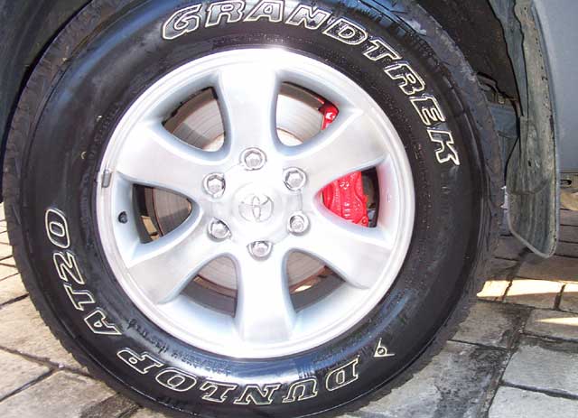

Here are a couple of shots Live4swell, from yotatech, took of his truck after painting his red. They look really good, especially with that TRD logo.
