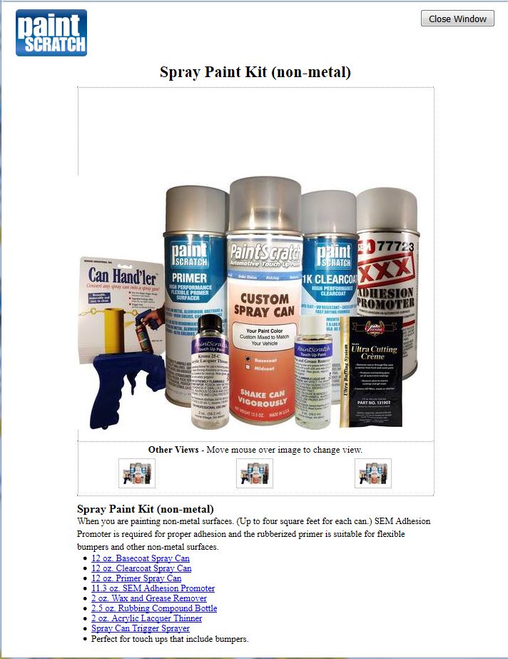

Gotcha. A couple questions for you;
1. Did you buy the Paintscratch.com "non-metal" paint kit? (see pic below)
1a. If yes, was one kit enough for both fenders?
1b. How difficult was it to do it yourself?
2. Did you have a shop do it the 2nd time?
2a. What did that run you?
Thanks for the feedback!

I did not buy the kit. I purchased individually. I used one can of primer, paint and clear for each fender. So two of each. You can even go 1.5-2 of clear as you'll need to wet sand and polish to really make it shine.
It wasn't difficult at all, the hardest part was being patient between steps and coats to fully ensure I was doing it right.
I had a shop strip my work and paint it with a custom mix of my color to match my doors. They charged me $450. Well worth it in the end but I wouldn't have had it repainted if the color was closer out of the can. In their defense it's really faded and that's not paint scratches fault.
