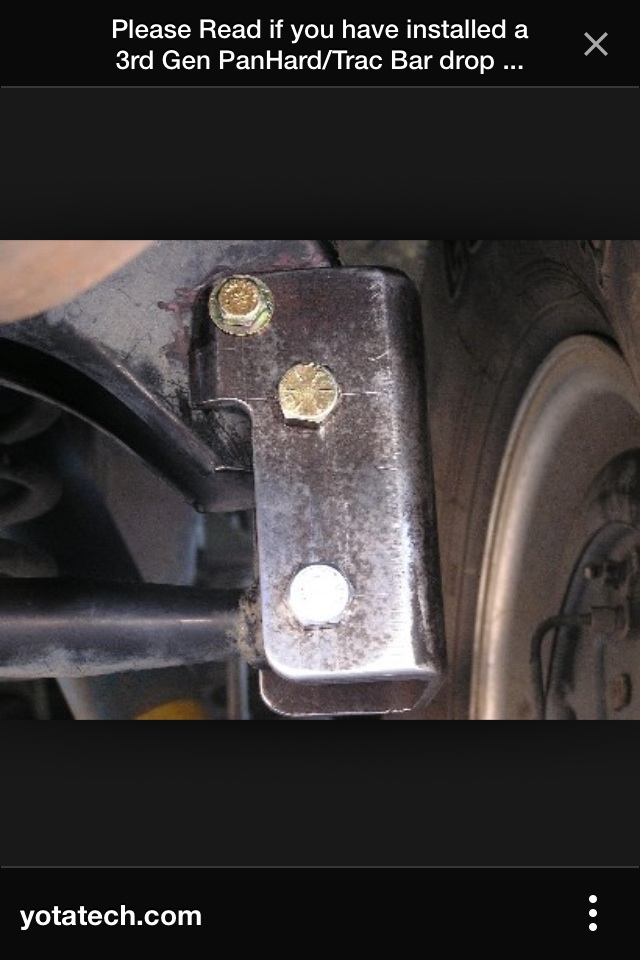

3. the proper way to fix the panhard angle for a lift would be to raise the mount on the axle side, but this would cause the panhard to hit the cross member on these 4runners.
4. Lots of people have had both the drop bracket and the adjustable panhard work for them (either, not both at the same time).
5. If you use a drop bracket, you need to have it welded on, not just bolted on. This is part of why Sonoran steel stopped selling the drop bracket.

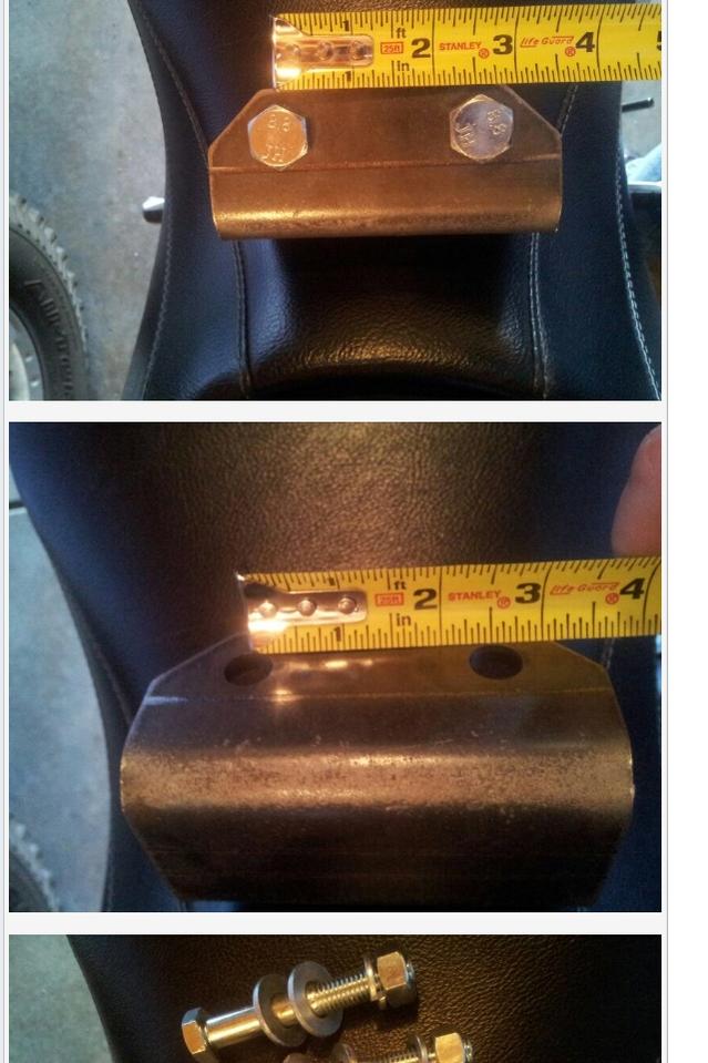

I think I will make a bracket and a gusset,I can save 200 buck and put that towards Mstuds end links(I think that would be a better use of my money sence this is a daily driver.
I will end up with about 3.25 lift it says with the superflex springs,do you think I should make the hole spacing 3 or 3.25 on the bracket,toytecs is 2.5?
You can also extend the factory panhard like I did, I think it was 15/16" solid rod that slid in tight with some persuasion, there is a chart somewhere on the internet that tells you how long the panhard should be for the amount of lift.

What do you think about the last pic without a gusset,whats the chance of shearing a grade 8 bolt,also putting some spacers In between.Would that be strong enough for daily use and mild off-roading?
