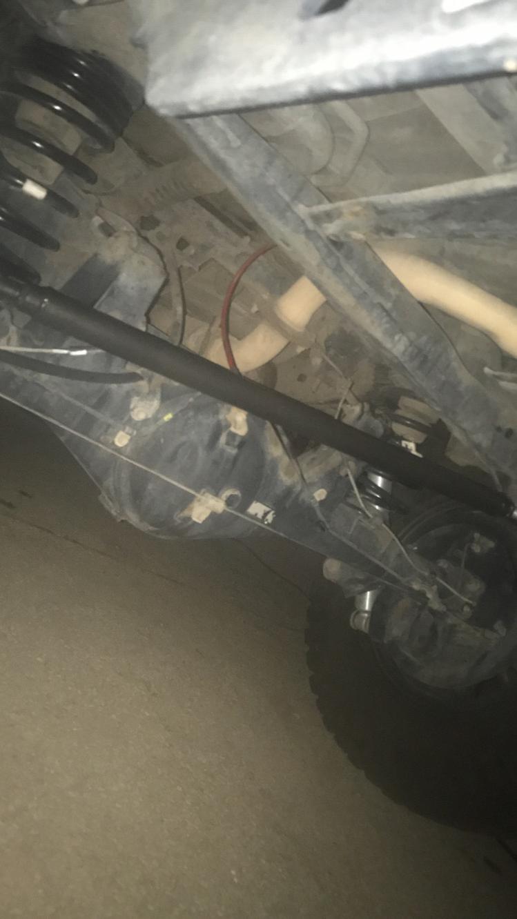

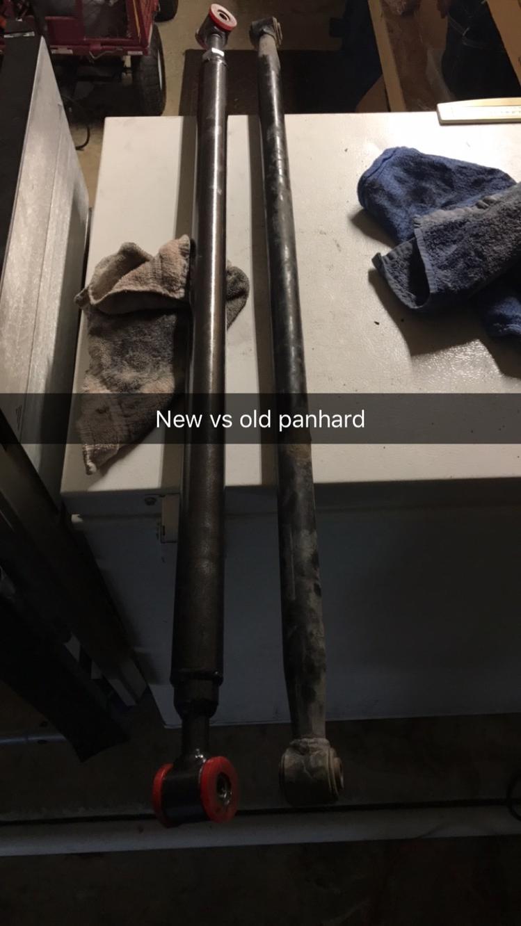

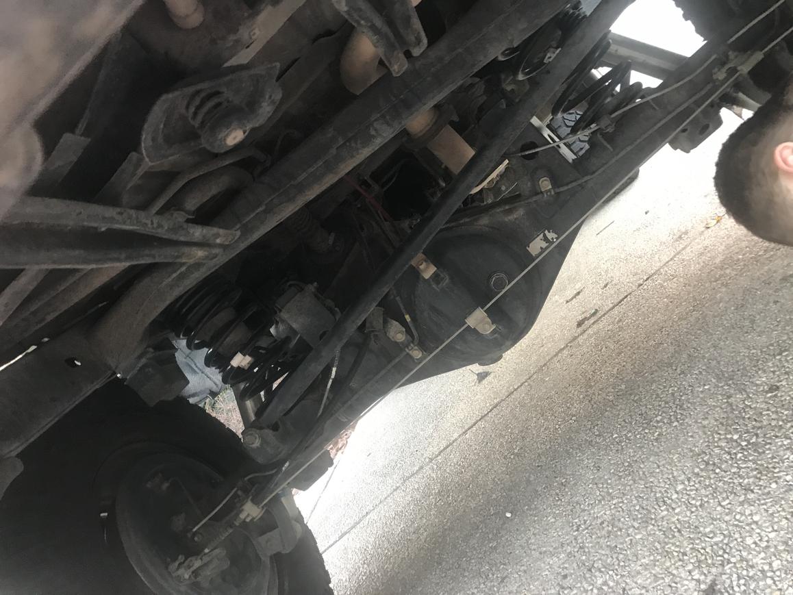

So I just installed my Sonoram Steel Adjustable Panhard Bar and my axel didn't recenter itself. But the ride is a lot more solid and I'm very happy, I was really looking to recenter my axel, how do I do so? PS. I installed the new bar with all wheels on the ground and the truck wasn't jacked in the air,the instructions told me to keep it on the ground so I kept it on the ground.

If you read his instructions he gives you the amount to adjust the bar for the amount of lift you have. It got mine close but not perfect.
The best way to align it is remove the stock bar. Lift rear end in the air. The axle should recenter when no bar is installed. Measure from panhard mounting bolt hole left to right to the the amount you need to adjust the bar too.
Install the bar and drop her down. Then find an alignment shop that will do a 4 corner alignment. They will adjust the rear tires to be aligned perfectly with the front tires. I did this and my highway ride is pretty much perfect.

So the axle was off-center with the rig sitting on all 4 tires, on level ground, and no panhard? If that's the case, something else is wrong. How are you measuring the centered-ness of the axle, anyway?
Shouldn't be anything wrong. The panhard just controls lateral motion. I didn't remove mine but took out the bolt from the driver's side and rolled forward and backward. Then I eyeballed it from how far it was sticking out on either side mainly using the fender wells as reference.

He said it was off center with his new adjustable bar installed. He did not lengthen the bar correctly to fix the offset.

But he said he installed it with the weight on the axle/tires/rear end/suspension/whatever you want to refer to it as, and unless he forced it to one side or the other, the axle should rest at center.

I agree there shouldn't be, but if it's off-center at rest- something is wrong.
If you have your truck on level ground- on its own weight, with no panhard- the axle should be VERY close to center. Close enough that you wouldn't be able to tell it's off unless it's on an alignment rack.
If you adjust your panhard such that you can slide both bolts in without prying anything, it should be VERY close to center.

The install instructions told me to put it to I think it was 38 7/16" and that's what I didn before I got under the truck. Then I struggled to get the old one off and when I was putting the new one on I A) the instructions told me to put the bolt in from the coil side, but there was NO way I could fit a ratchet or impact back there to tighten that, but it put it in bumper side. And B) the adjustable end of the panhard was at 38 7/16", then I got under the truck and it wouldn't fit like that so I just unscrewed it to where it would fit properly, so it's not really 38 7/16"

I think you may have misunderstood the install instructions. He states to use the 1" mark on the tape measure in the center bolt hole as the starting point & the other end of the bolt hole will show 38+. If you use the 1" mark on the tape measure then the total length of the bar (center bolt hole to center bolt hole) should actually be 37+. I think he suggests using the 1" mark instead of the 0 because the 1" will be a clearer & more defined point to see on the tape measure.

Damn, both methods seem like a logical way of getting a baseline centered axle when adjusting the panhard. Wish you guys could have read my mind and suggested this several weeks ago when I was trying to find out if my axle was truly centered with my panhard adjusted to SS recommended length. I had it lengthened to SS guidelines but thought that visually my axle still looked like it was slightly off center. I used 2 long levels using my fender flare and center wheel hub as my measuring points & it turned out my axle was centered the whole time per SS recommended length (even though I thought it LOOKED off).
I was able to slide the bolts in/out by hand with all 4 wheels on the ground when I removed my panhard last weekend to refresh the paint. I guess that will help confirm that my axle is as centered as it can be without actually getting a rear wheel alignment. I appreciate the insight.

When [MENTION=102606]infamousRNR[/MENTION] and I installed a Toytec lift for [MENTION=146244]phokingchink[/MENTION], we took the old panhard bar out, put in the adjustable one and put the rear wheels back on. To get the rearend centered, we simply measured from the frame to the outer part of the tire tread. We made the necessary adjustment by twisting the panhard bar the appropriate direction. We'd re-measure, adjust a little more until the length from the frame to the outer part of the tread was equal on both sides. We tightened the lock nuts and we were all done.
Unless i'm missing something, this seemed like a pretty straight forward process to me.
