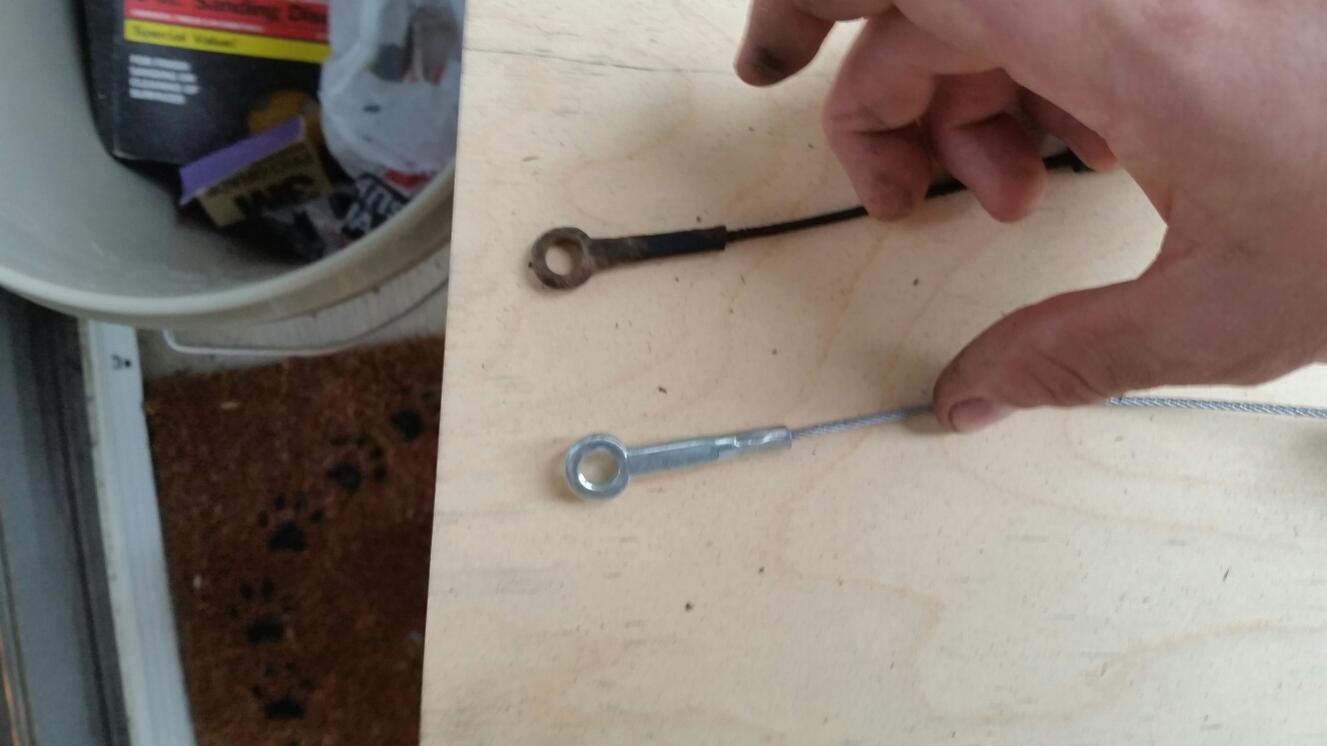

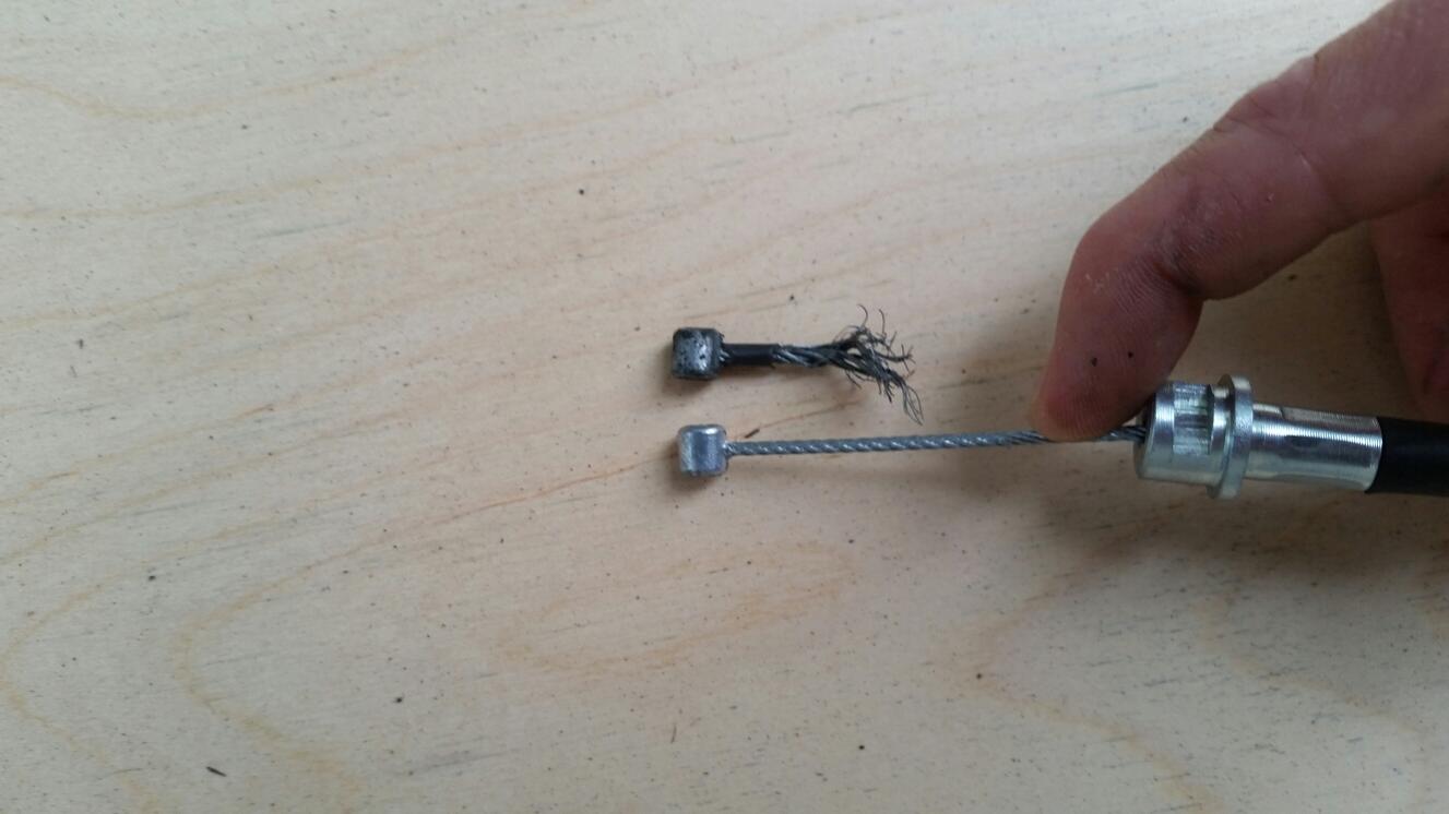

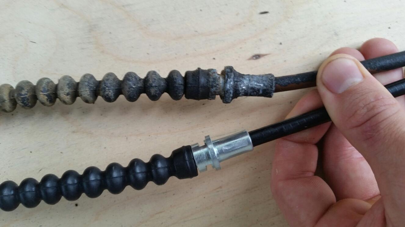

Once the part comes in i will take comparison picture of the two parts and post them here so that, if there are differences, they will at least be documented for future searchers.
Picture comparisons:
