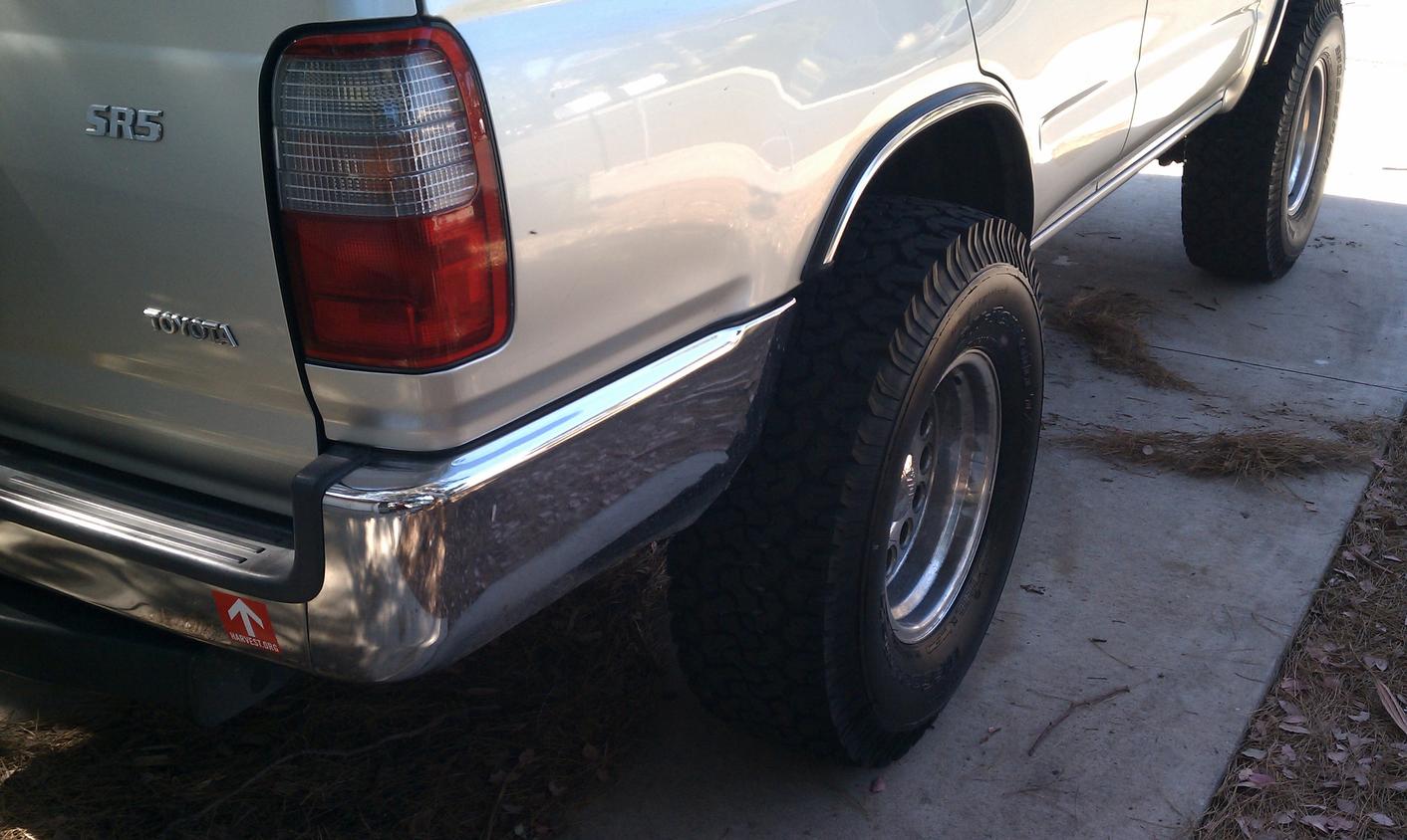

and it is off. Previous owner put a bit larger than average tires, Only rubs though on a sharp left turn....just just slightly. Don't know if this has anything to do with the parking brake coming on. I was hoping maybe there is an adjustment somewhere. there is a Fab Tech 3 " Lift on it

X2 brake fluid is low. Also, check your break pads. They may be getting low and the light is coming on because the brake pistons are pushing the pads way out of the caliper which is using more fluid.
