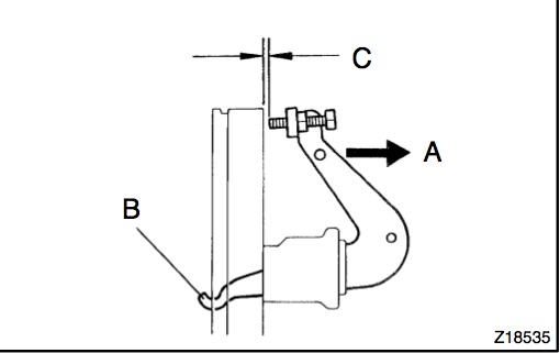

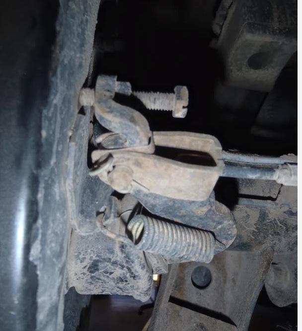

The issue I'm having is my e-parking break light will not turn off even when the parking break is in the off position this happen when I put everything back as it was. Can someone tell me what trigger this e-parking break light in the display instrument and how to fix it.
I check the distance from the lock screw in this photo(drawing) and its in spec.
Both drum has a pretty tight fit I can move them in and out without hesitation. What else is there to check.

Front break did not touch or removed.
Rear break removed only the axel, the break shoe are intact with the axel for pressing in with new bearing, I left the break shoe in with the axel for pressing bearing. Could something might have trigger the dash light to come on after the bearing press. I install both rear break as is when I removed to do the bearing.
Should I removed the drum and check the break again.
