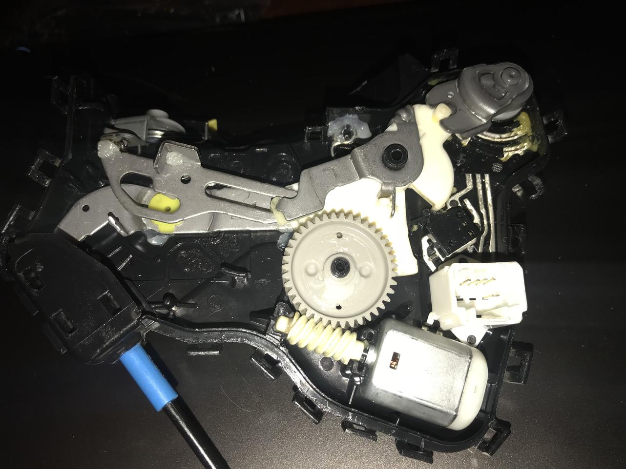

Guys, I need help if you can. I replaced everything and it appears to have fixed the issue. However, once I put everything back together, I couldn't use the interior door handle to open the door. I have taken apart things again and I think the issue is with where the cable attaches. Does everything look correct?
Please see my pic here

I had that happen
... when I replaced the actuator in the rear door. It's been long enough that I'm vague on details, but I seem to recall that it was related to the cables & the "state" of the actuator when I put it in place... by "state", I mean whether the cables where pulled out or pushed it. Sorry for vagueness, but it's the best I can do... I had that same situation where the door handle/lock or something didn't work, took the actuator back out, messed with it a bit, put it back in and it was working OK.
Maybe whatever isn't working, move the cable so the actuator is "different" & try again?
Dave
