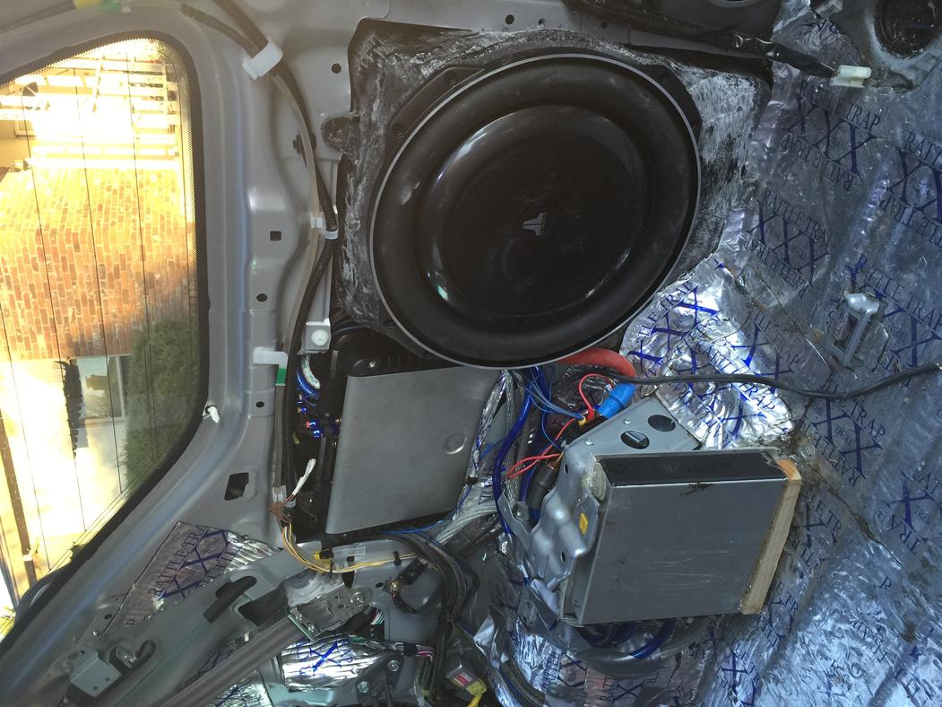

Went with small amps ...
So i don't have a build page up yet I'll try to I am running dynaudio esotar 3way 8" 3" 1" in the doors with crossovers ..in the front . In the rear I am running dynaudio comp 2 ways a 7" and 1" tweet .. For sub bass a jl 13.5 in a custom box . Jl hd 600.4 and 1200.1 ...
Here's a shot of it

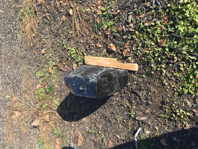

How do you like the 13.5? I did a set in a tundra system I built for someone else and was kind of impressed. Just figured there was too little airspace there for that sub
I am still breaking it in . So but so far I like it a lot . It isn't really deep bass but it really Krisp so I will give it 3 weeks to really break in .. I'm running a decent sized box tho
