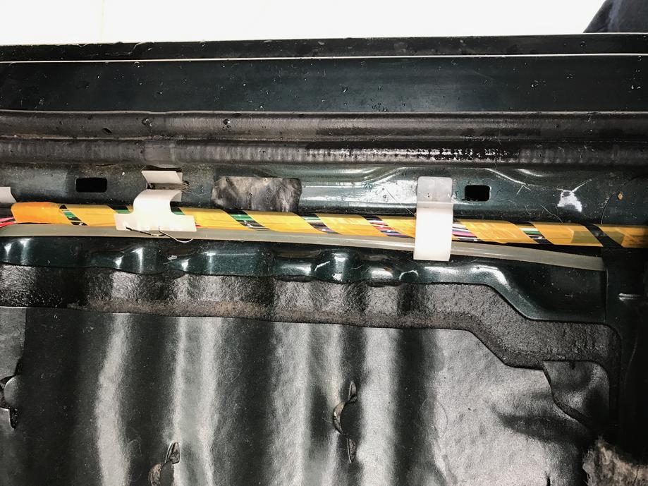

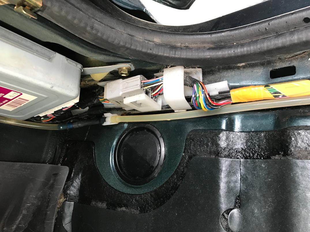

Ok so this little tube is soaked. I got up and cleared the two front drains. But now only time will tell.
For the life of me though I cant figure out where this little tube is connected. Any info?

Dude ! I had the same problem with a wet floor board.
That lil tube is the line to the rear windshield wiper fluid.
Mine was disconnected for the longest time. From time to time I would run my rear windshield wiper just to see if could get it to work, little did I know I was shooting windshield wiper fluid under the padding and carpet....
Anyhow, now reconnected tube, no wet carpet and my rear windshield wiper fluid sprayer works ! [emoji16]happy day, hope this helps.
