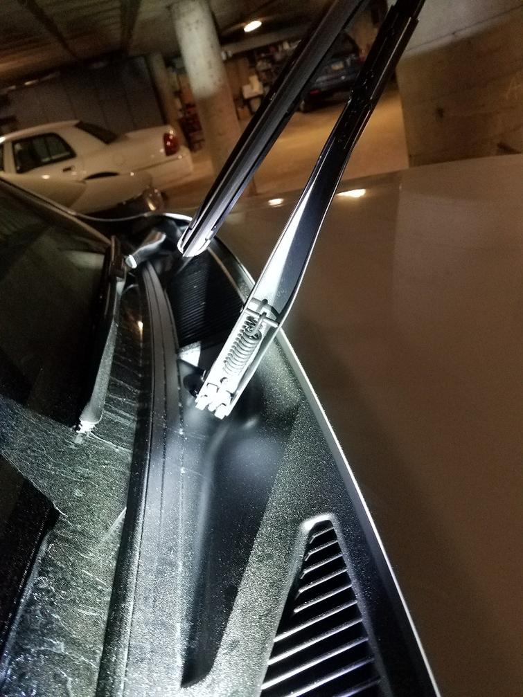

Did you try to see if the pressure of the wiper blade against the glass is the same for both wipers. If the pass side pressure is lighter it could explain why it works with rain but not when perhaps a little more pressure is needed. There might be an adjustment for this; or perhaps that pass side arm is weak for some reason. A pull test with a thick sheet of paper on both sides and in a few places during the sweep might work for an unofficial test.
I don't have your problem, but I'd suggest two things:
I'd shorten this spring. My guess is that it has gotten stretched somehow. Regardless, IMO you need more downward pressure of the arm. $.02.
I'd make sure the arm is free to operate (that the hinge isn't binding).
