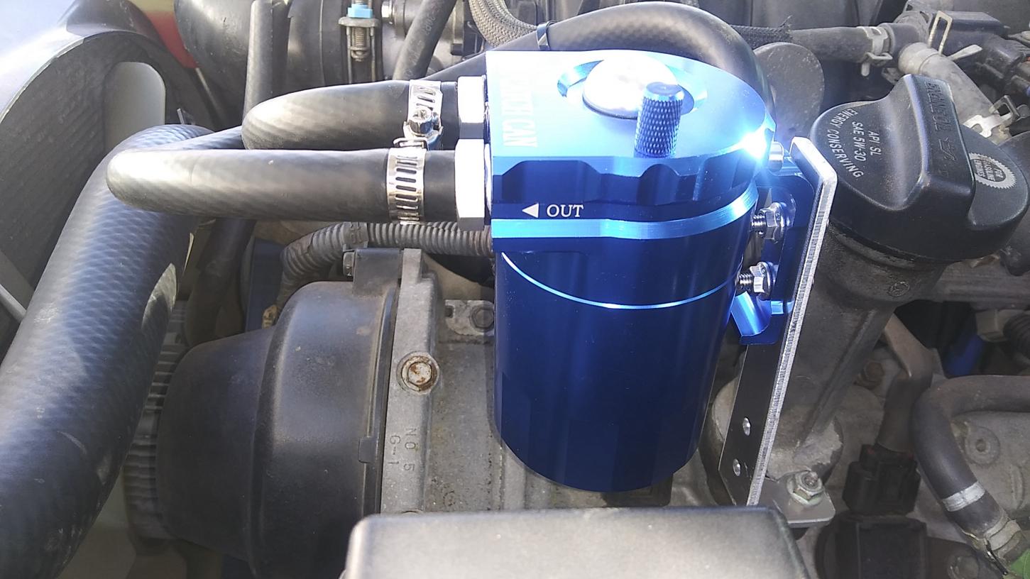

Bought a cheap catch can, since the Moroso I bought for the 5th gen years ago has gone up, costing over $200.
This one was easier to mount anyway. Plenty of clearance to empty it, and I can still pull the front spark plug.

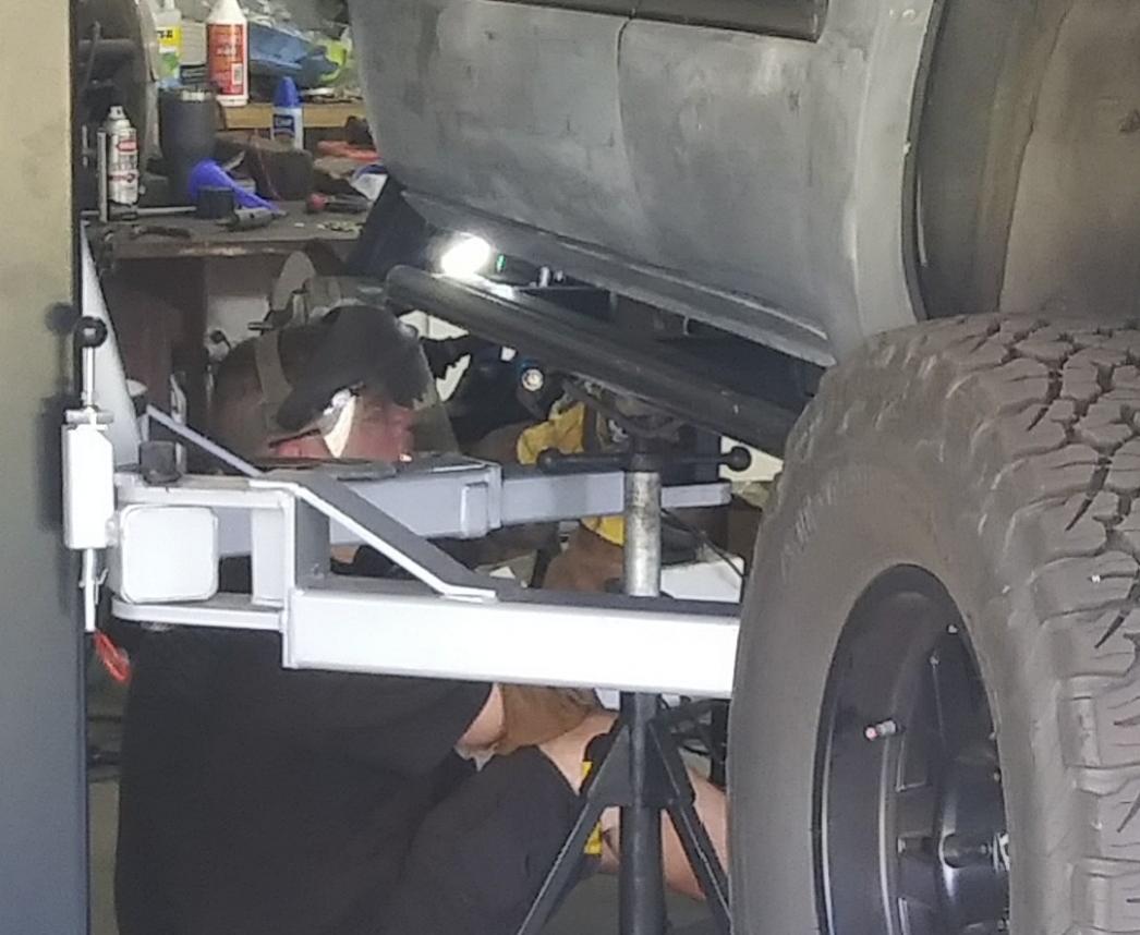

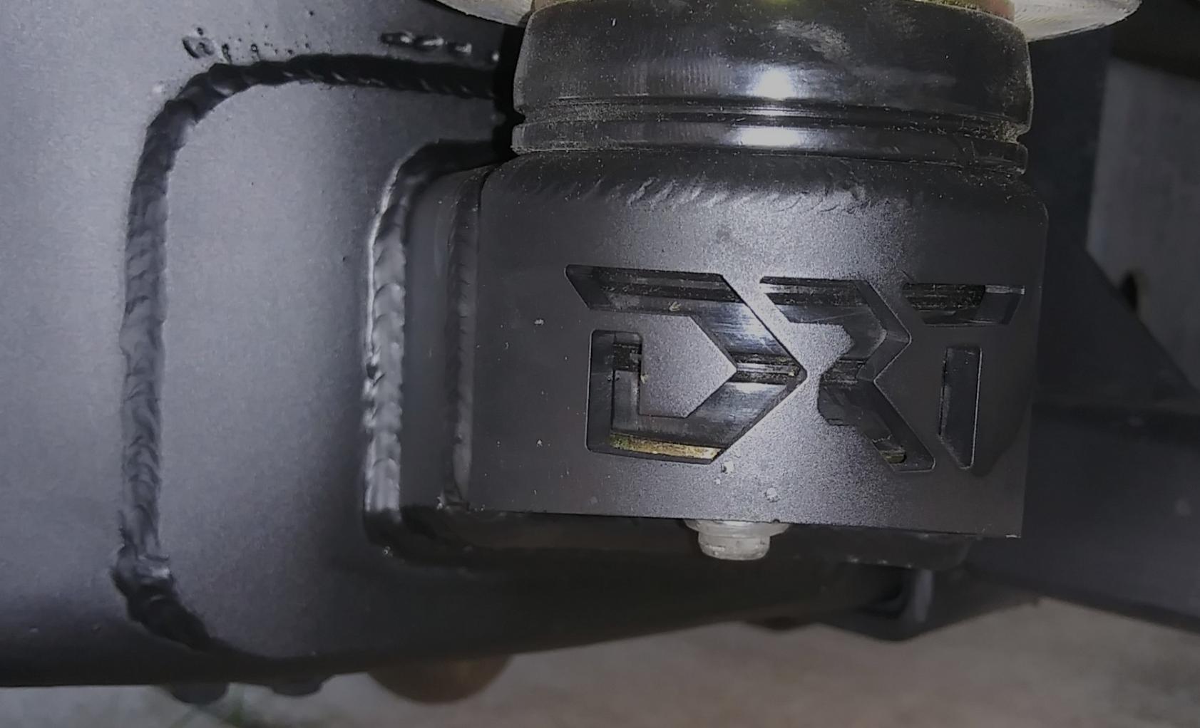

DRT cab mount relocation getting installed.
Timbo's Customs
Auburndale, Florida
He's done several dozen of these and a good dude.

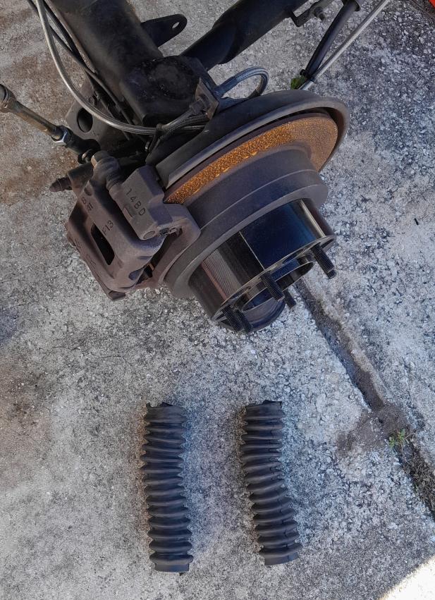

I put this off way too long, as the OEM mounts were butchered when I bought it.
Not just a chop, DRT completely relocates your cab mount.
The other thing I like is the backing plate that gets welded to the frame, instead of just the mount itself.
Other relocation kits were cracking the thinner Tacoma frames after awhile, so DRT designed a way to reinforce and spread the load across a broader portion of the frame.

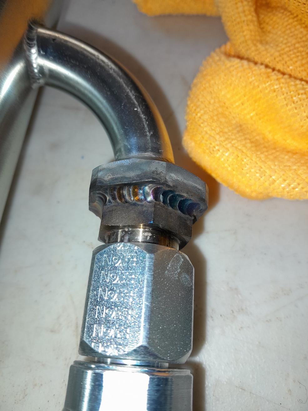

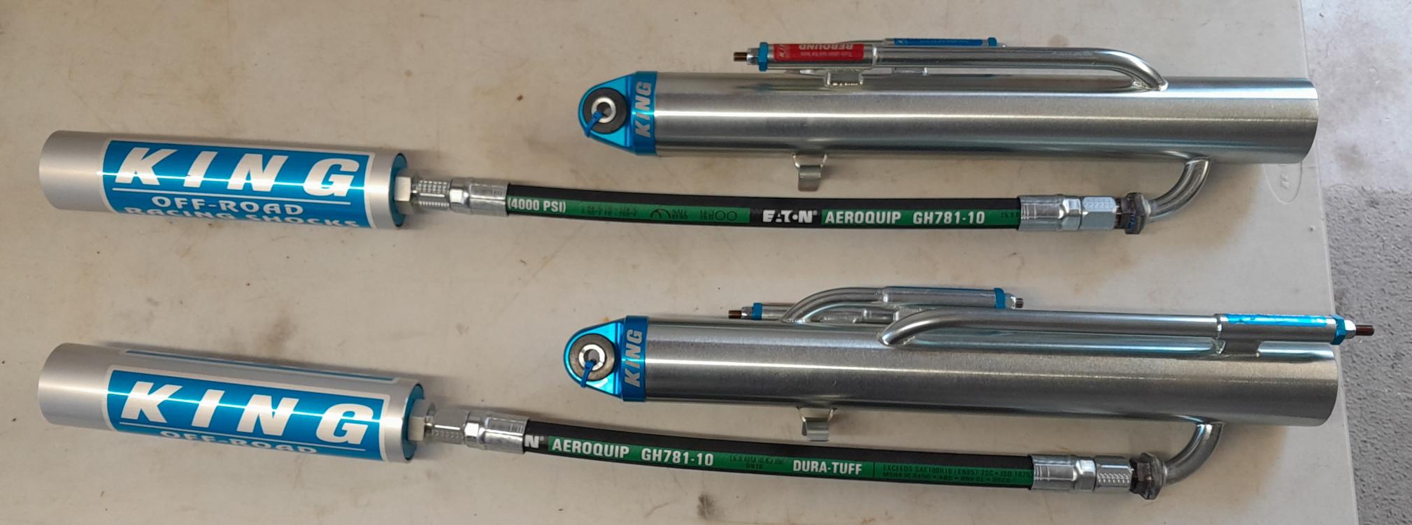

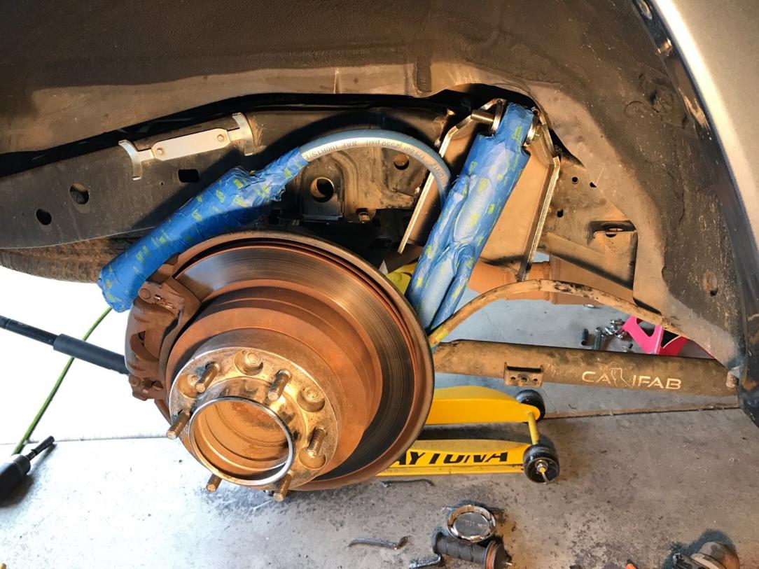

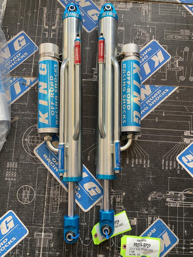

Still working on my idea for the rear suspension. 14" Triple Bypass w piggyback reservoirs in the first pic, is what I started with because I got a deal on them last year.
But they won't work because of clearance between the res and the frame at full bump, so I converted them to remotes. First I had to disassemble them, and pull the resi off the fittings. Then I had Apex Fabrication tig weld a JIC fitting on to the old fitting and had some -10 hoses made.
Also bought some shock mounts from Ruff Stuff. Going to try an idea one of the Cali members had years ago, where he frenched the the old shock mount structure.
Not sure if I can find a way to use all of the 14" of travel, but others have pulled it off on the 120 frame before. I installed the FJ tank to gain more droop, so I think avoiding an intrusion into the cab will be the main limiting factor.

I've seen some rear mounts frenched into the frame on a few builds, definitely doable. Are you against having to clearance into the cab a little? I did see a couple of builds that had to clearance into the cab, but nothing that a little sheetmetal work afterwards didn't cover up. Are you against going into the cab at all? I certainly wouldn't want exposed shocks in mine, but a mild recess that could be fabricated over afterwards wouldn't be a deal breaker for me.
full 14" of travel would be pretty sweet :)
Yea, not sure if I can get the up travel for the full 14", not without a lot of fab work. I think the droop this suspension is capable of might work though.

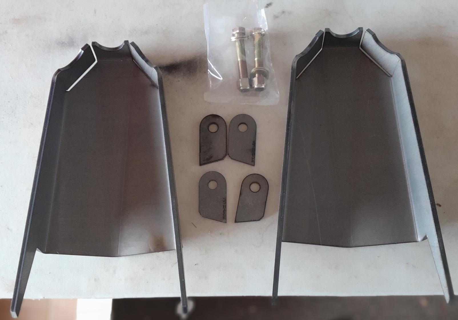

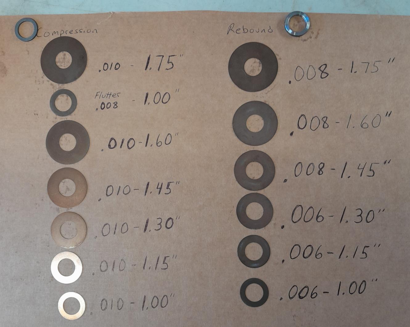

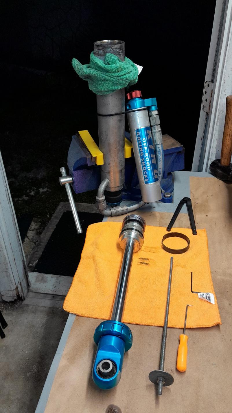

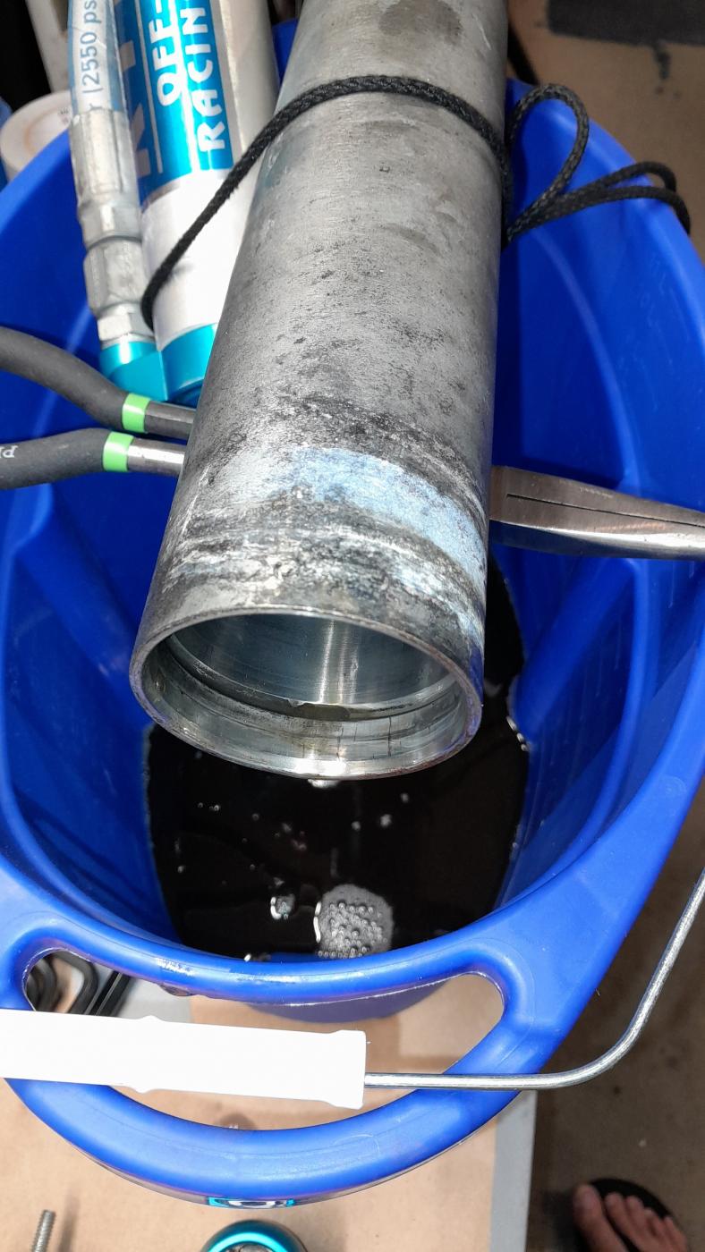

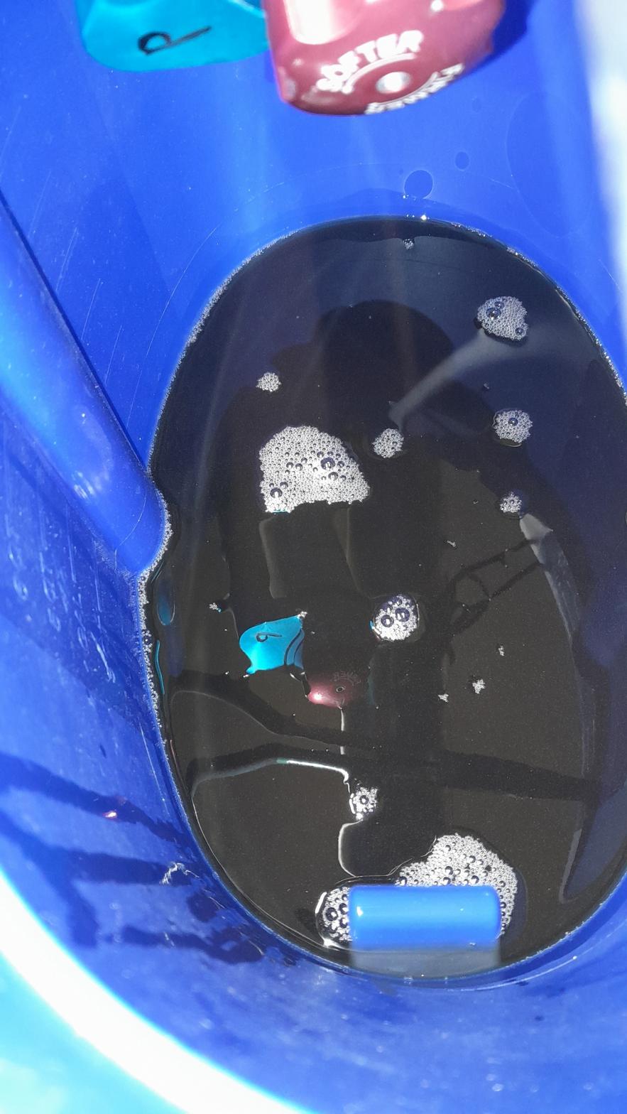

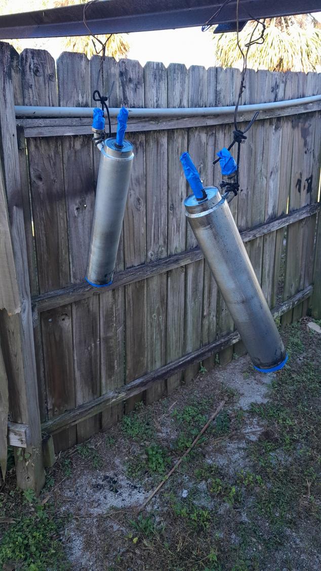

I've been cycling the rear suspension today, really not sure my plan is gonna work out. There are several limiting factors for travel, on top of my lacking knowledge on this subject.
So in case I have to put it back like it was, I'm rebuilding the smoothies.
They will only hold about 70psi of nitrogen, and were fading pretty quick out on the trail. Oil is pretty much cooked from the looks of it. It got pretty frothy when I pulled the piston. A little bit of cavitation is normal but foam is no bien.

Upon further investigation and research, I believe these smoothies were WAY under valved. On top of needing a rebuild and this weak tune, these poor things could never keep up. Ordered some shim stacks from Kartek and will make some changes.

Wet sanded the shock bodies with 1500 and simple green lol. Worked pretty good. They ain't beautiful, but it took the worst of the corrosion and discoloring out. I'm going to hit them with a light coat of engine clear and see if that holds up.

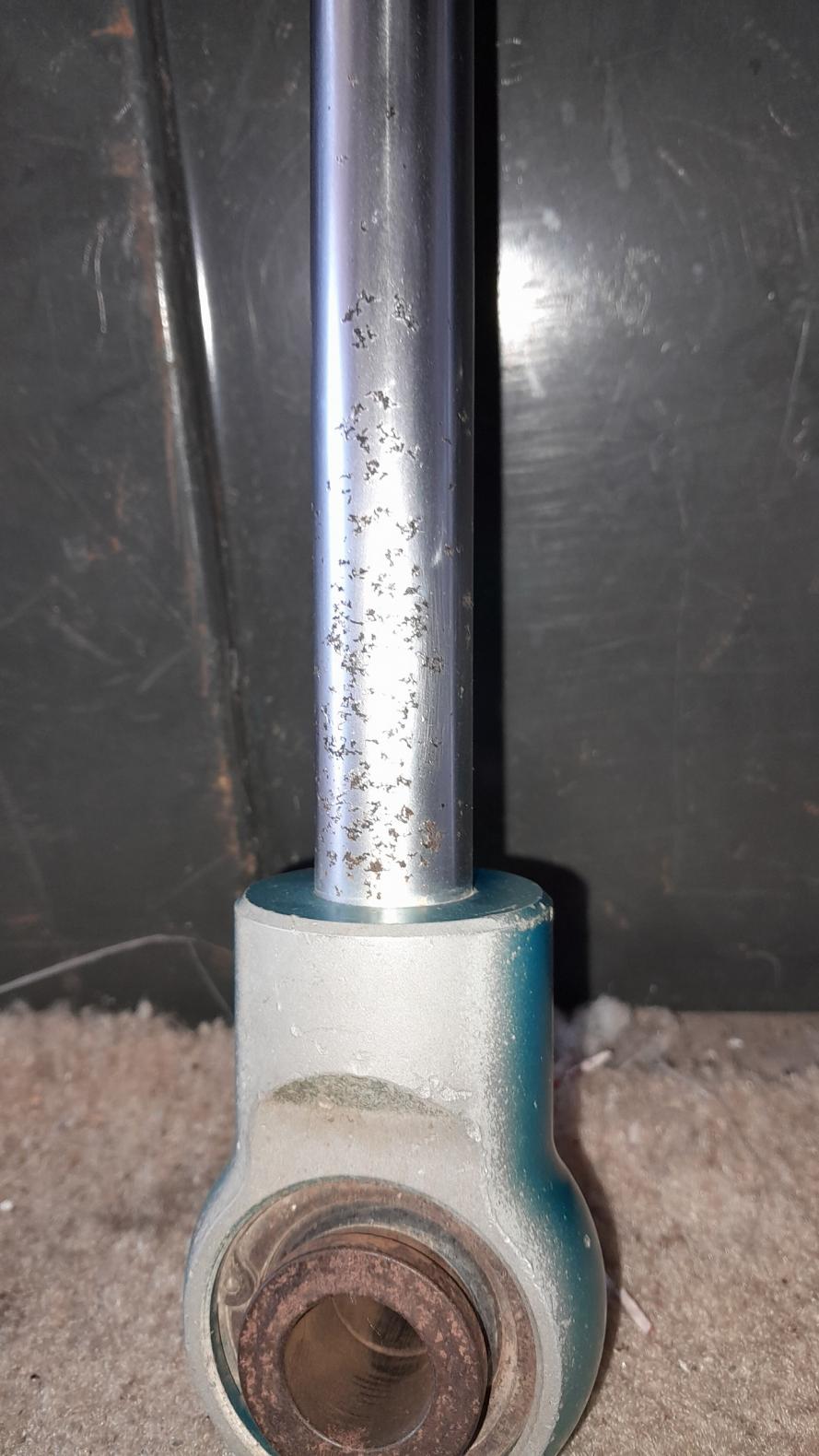

Also want to remind everyone to protect them shocks, at least on the rear. I swear by these Pro Comps just zip tied to the lower mount and the shock body. They have stayed in tack and have no rips or tears, and did their job pretty well because there is no scaring or pitting on the chrome.
2nd pic is from my 5th gen rebuild back in 19'. These were unusable and now they cost $65 just for one. Although ugly, the rod ends could have been reused w new heims and spacers.
