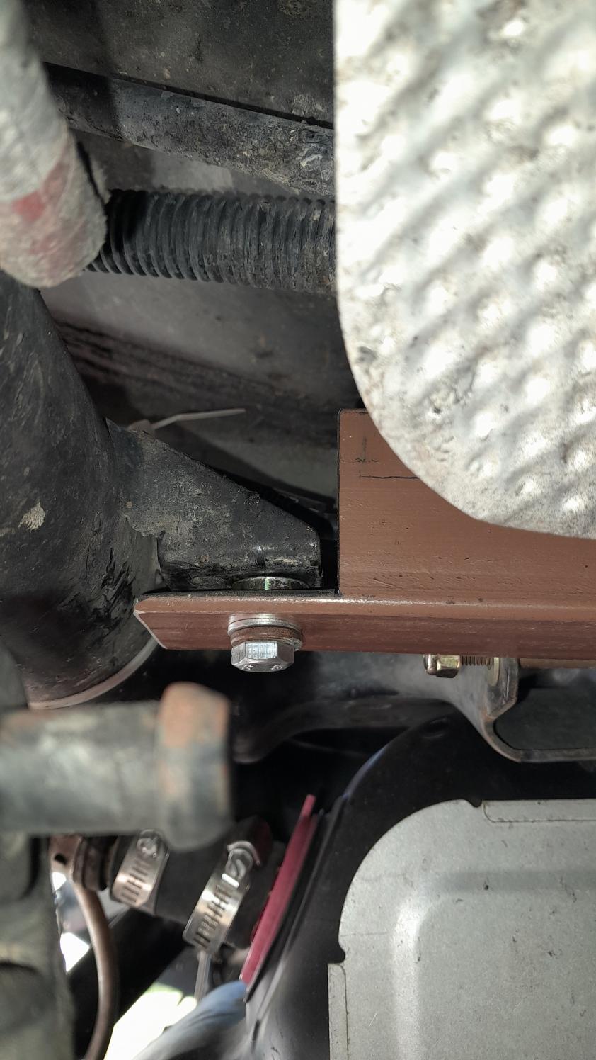

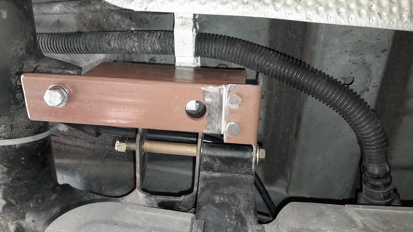

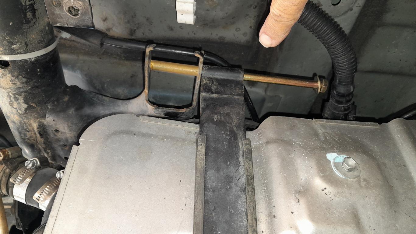

Also readdressing the FJ tank. I had moved the rear strap to accommodate the shorter tank, and didn't really leave a solid mounting point for that strap.
So I found a tab on the upper link cross member with an 8mm nut welded on there, then used some old bed frame and fabbed up bracket. Now I'll have a double shear on a Grade 8 bolt, with a support brace in the middle of the bolt. A little paint and it should be good to go.

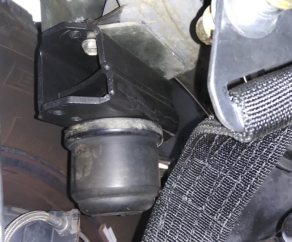

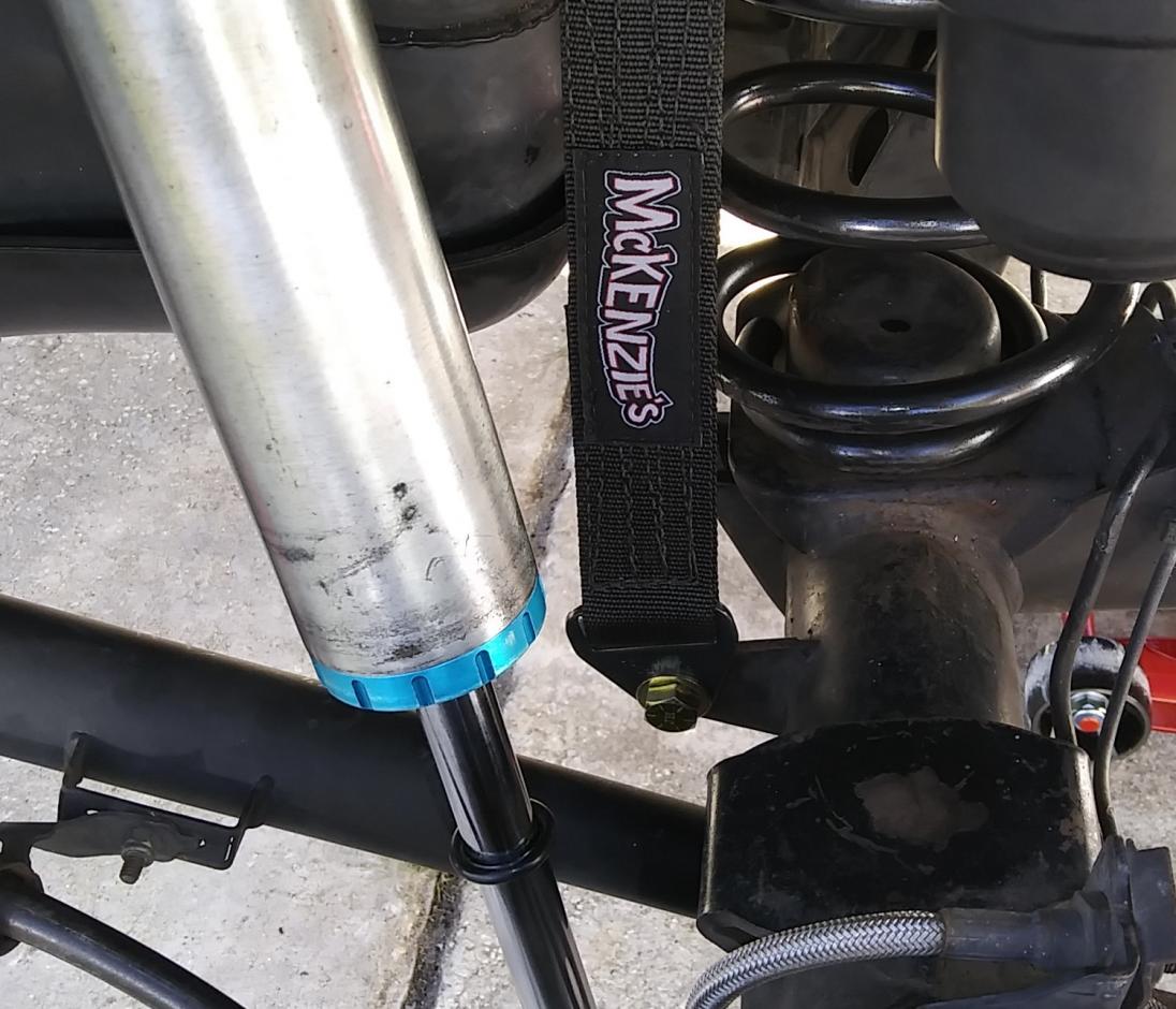

The pursuit of more travel for the rear suspension continues. I still want to stuff those 14" bypasses in there, but each time I go to cut some metal, I get skeered. So the current set up will have to do.

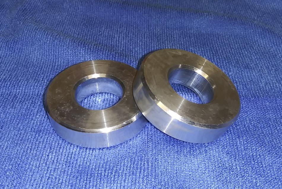

During the process of rebuilding/valving the shocks, I remembered when I ordered these Tacoma spec smoothies, DSM and King were concerned about the 4Runner application. The longer shock would supposedly bring the drivers upper link in contact with the tank. So they put a billet 1/2" top out spacer in there to eliminate some ext length. The Califab upper links open up a little more droop and with the shorter FJ tank, I'm not even close to contact now.
Well I decided to remove the spacers and install some Limiting Straps.
McKenzie's for the win.
I also decided upon cycling the axle, that I could gain some more up travel. So I did about a 3/4" chop on my Metal Tech bump spacers. Now, in theory, I should gain about 1" of travel up and down, once the limit straps do their stretch. Hopefully this will help it keep up with the front now.
I did an initial drive on the street last night and I didn't realize how much the lack of valving in the smoothies were affecting the handling. It's much more stable at hwy speeds now with the new shims. Reservoir adjusters are wide open, so I have a lot more compression if I need it.

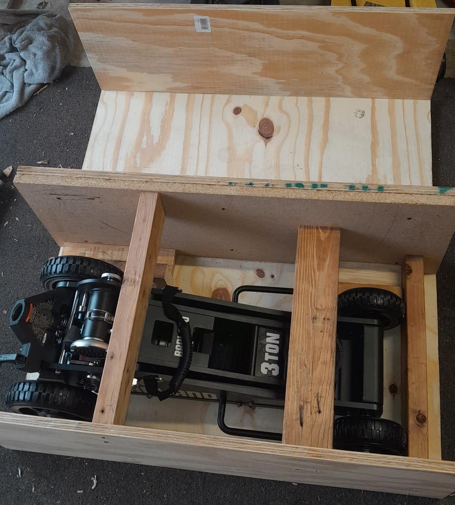

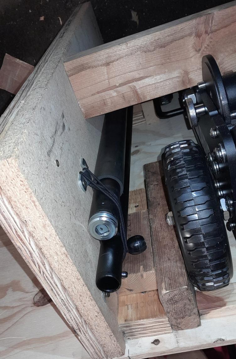

I've got one of those new offroad jacks coming in this week I can put back there. Thinking about building a box for the jack and recovery gear, then the spare will live on top. I don't think a tire carrier/bumper would be happy with the violent abuse it will see in the whoops and I don't want that much weight, so I will stick with keeping it in the cab.

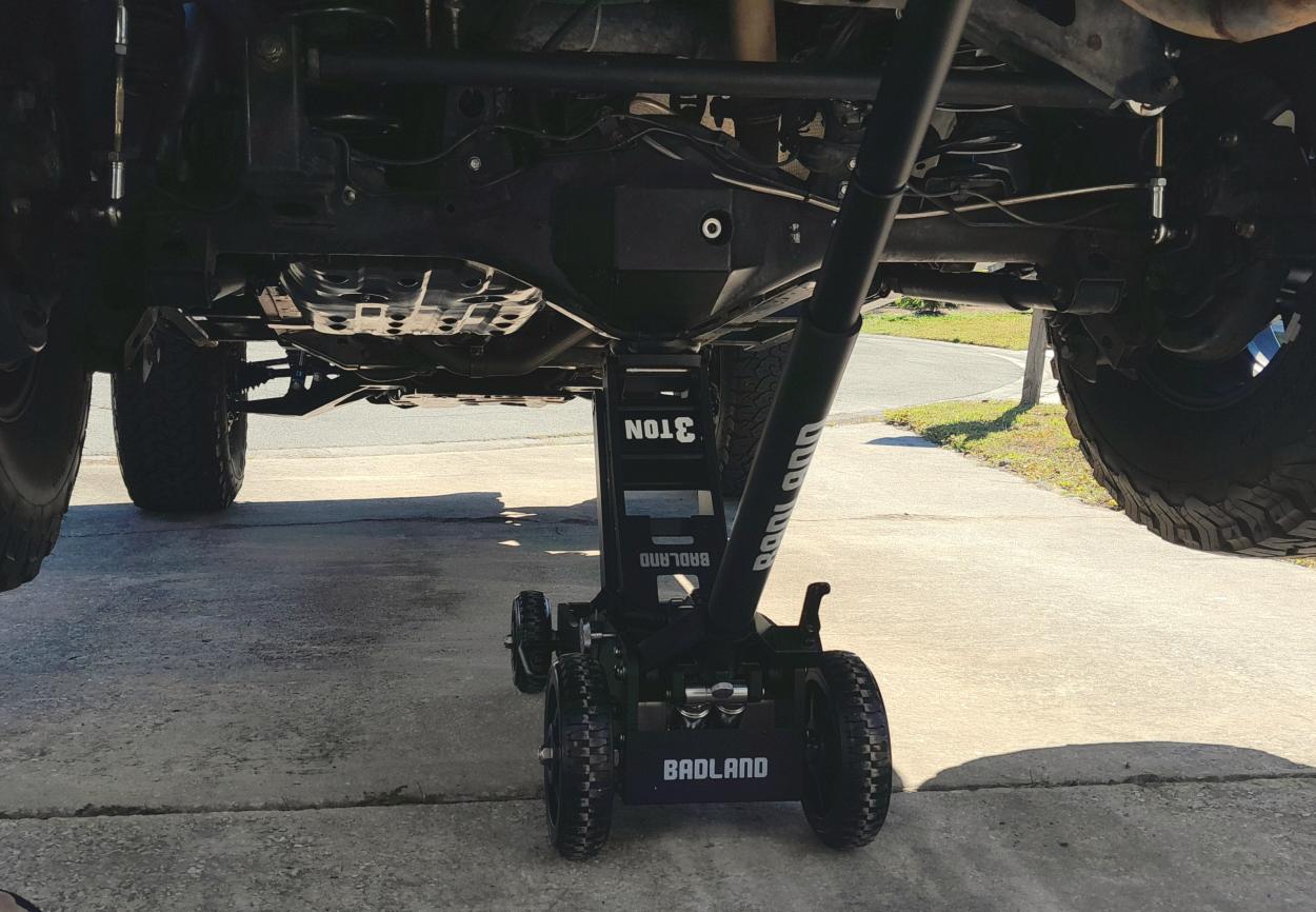

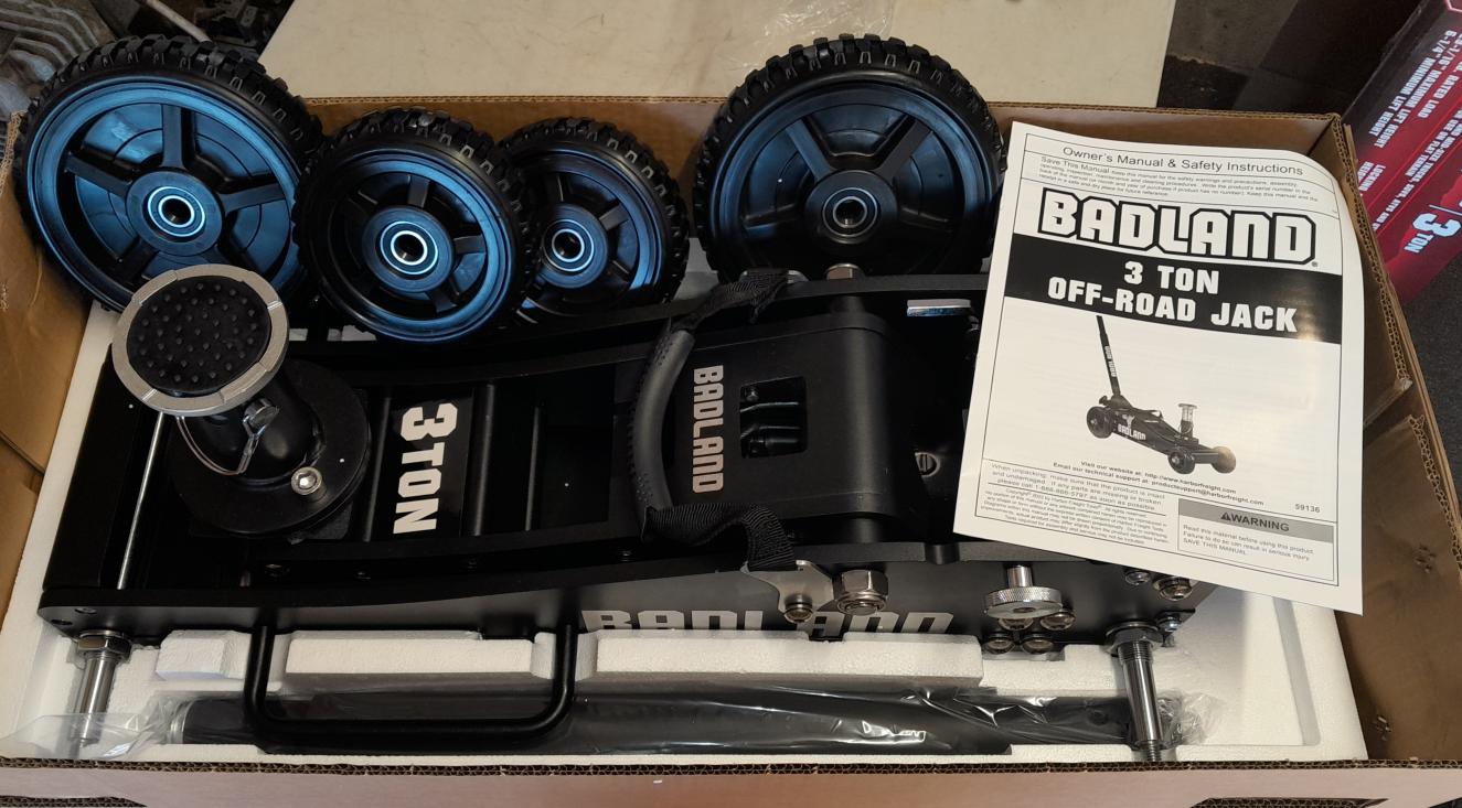

This came in today. Fit and finish is pretty good, we'll see how it holds up.
Whatever change Harbor Freight made internally over the past couple of years has really been working from them. Their product offerings have been pretty damn solid, and with these jacks in particular I know they knocked it out of the park with initial release... they have been selling like damn hot cakes with no stock anywhere around me (not that I necessarily need one... but it could be pretty handy vs my current standard jack for 4runner work).
did you order in store and have shipped to you?
The price point vs the pro-eagle is in line with what something like this should cost... I can't imagine spending $600 on a damn 3ton jack..
My old Daytona (23.5 " lift height) gave up last month, so I bought another one of those at 25% off and bought the Badland (preorder) the next day for the same 25% discount. So I got both of those Jack's for less than the pro eagle.
Even if built in America, $600 is freaking outrageous.

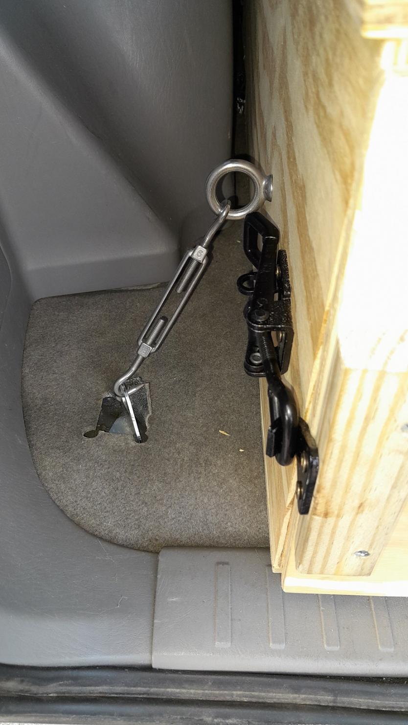

Cargo Box cont

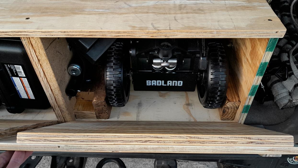

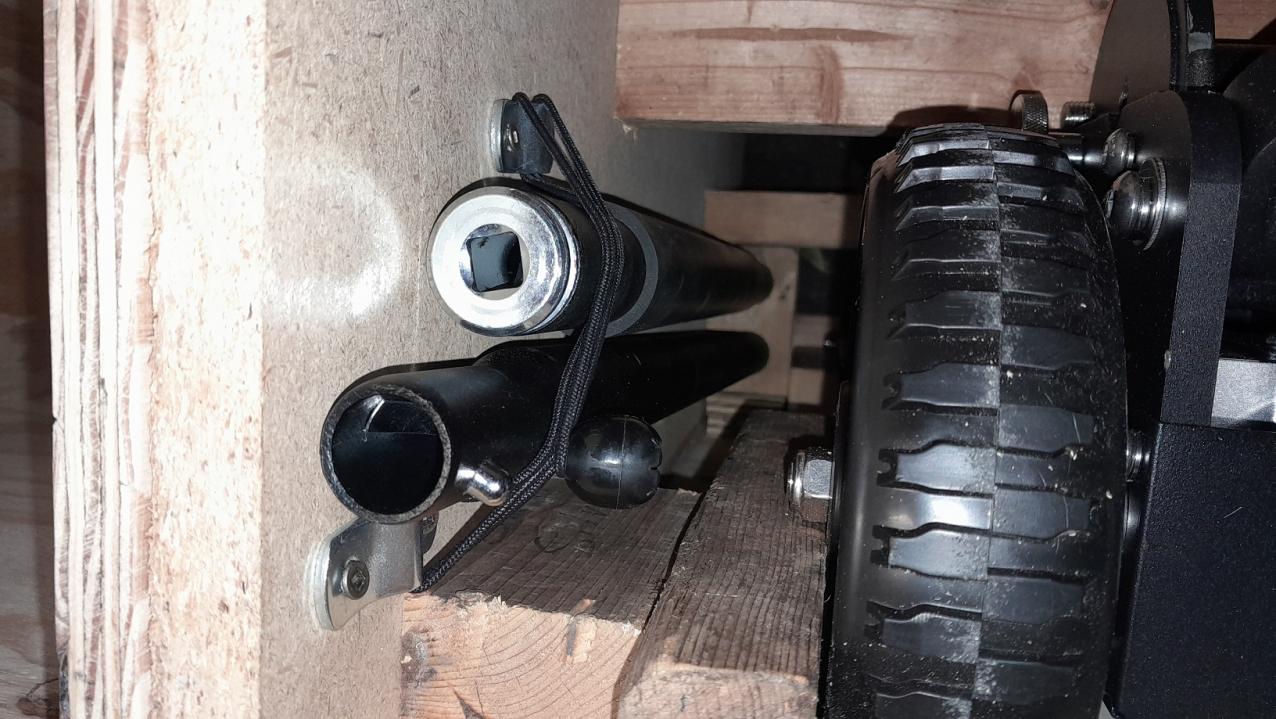

As most of you know, securely fastening down the menagerie of crap we drag around can be daunting. Safety first, rattling noise second.
Here is my solution for the Badlands handle. I added a small block bored with a 1 3/8" hole saw for each piece and of course a bungee at the other end. This should work to keep the rattling at a minimum:

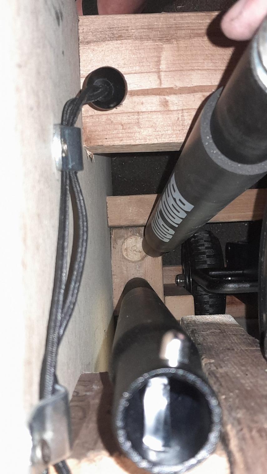

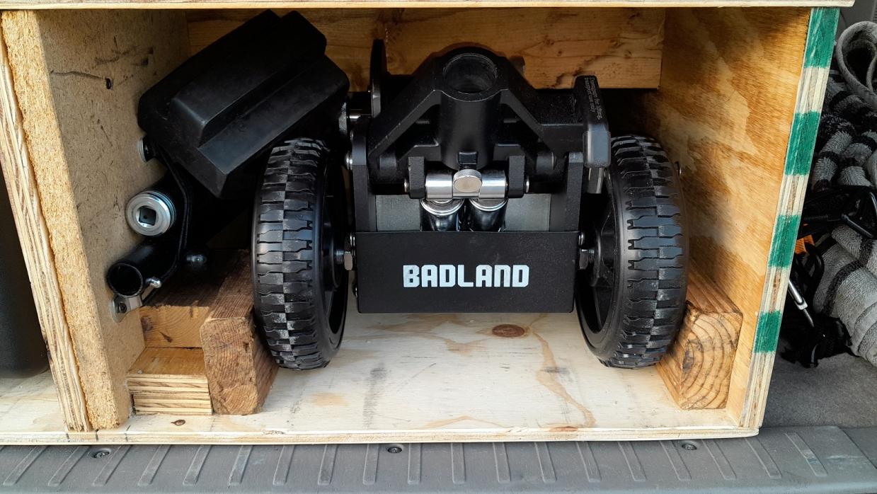

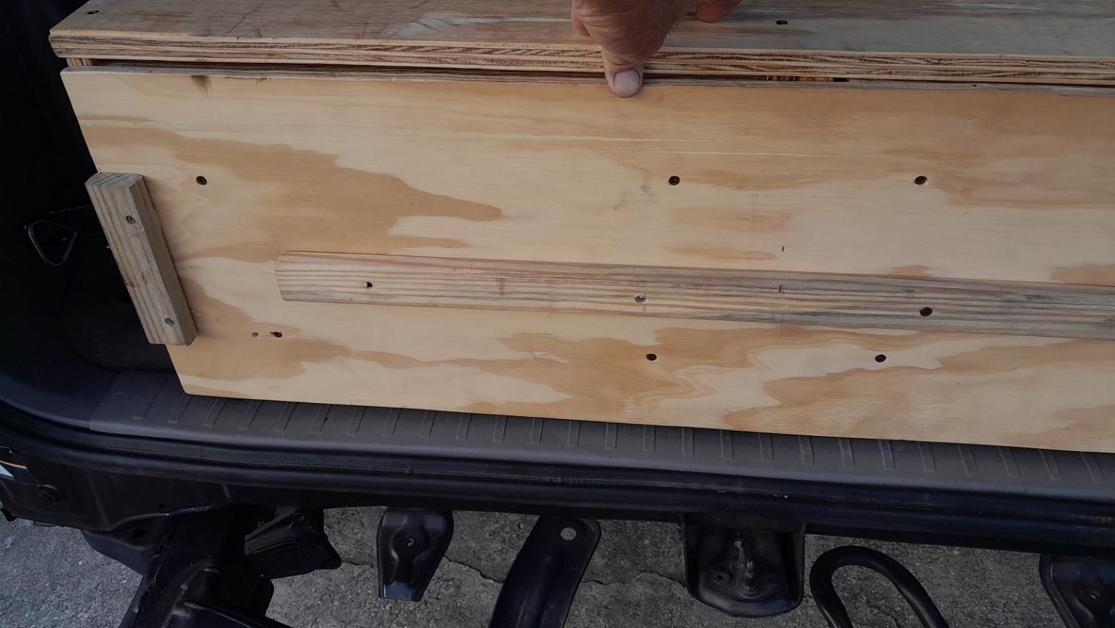

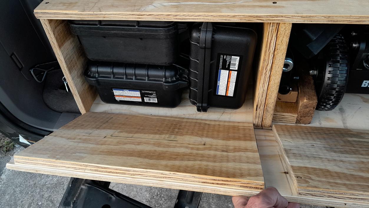

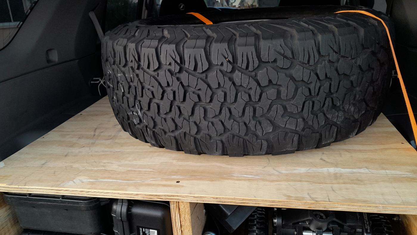

Cargo Box - One more
Well I think this thing will serve it's purpose. I elected to pass on a drawer for the open cargo space on the left. I don't really camp out of this thing much at all, so I don't need a galley.
To fully enclose that end and make it with easy access, I built a lid with some inserts to help secure it, along with some link and latches. I think the 3/8 eye bolts might over kill, but it's gonna take a beating.
I was able to cram a duffle w recovery ropes and straps and stuff it in the front of the box. I then discovered 3 pelicans/apache cases fit nicely for shackles and snatch block, hand tools and a few other things. The Jack is pretty snug in there as well.
I can still see out the back window, even with that big ass hunk of rubber back there.

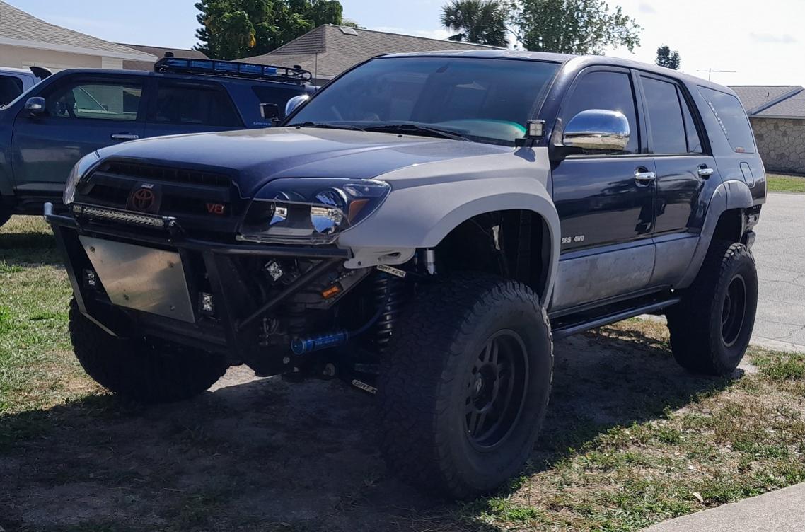

Hideous Roof Rack has been deleted and cheapest amazon headlights (w gobs of 3M 5200 goobers slopped all over the seams) installed. That and I got the ADV glass fitted pretty well and a couple coats of epoxy primer on them.
Never sprayed with air before and quickly realized a 1.4 spray tip is too small for this epoxy with out reducer to thin the mix. Came out a lot like bed liner if your looking for the secret sauce mix lol.
