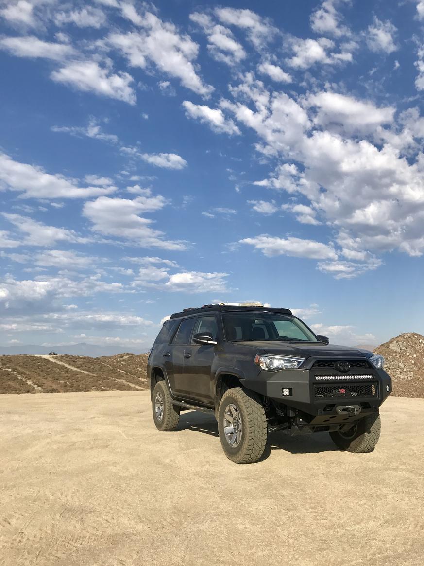

You don't need a relocation kit. The power steering tube easily bends out of the way. I have a Warn Xeon 10S and it fit no problem. I love this bumper.
Yup, I've seen people bend that tube before. Trying to leave things stock where I can though. Your rig looks money btw!
