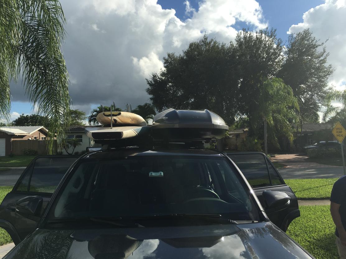

I run the 53" Aerobars and I think they are perfect. You don't even know they are up there, virtually no loss in mpg and nowind noise. unless you want to load stuff outside the frame of the roof. Below is a picture with a loaded Skybox 16 with a 10'6" paddle board and 9' longboard on the bars. Check out the etrailer website. The usually have video reviews with most products.

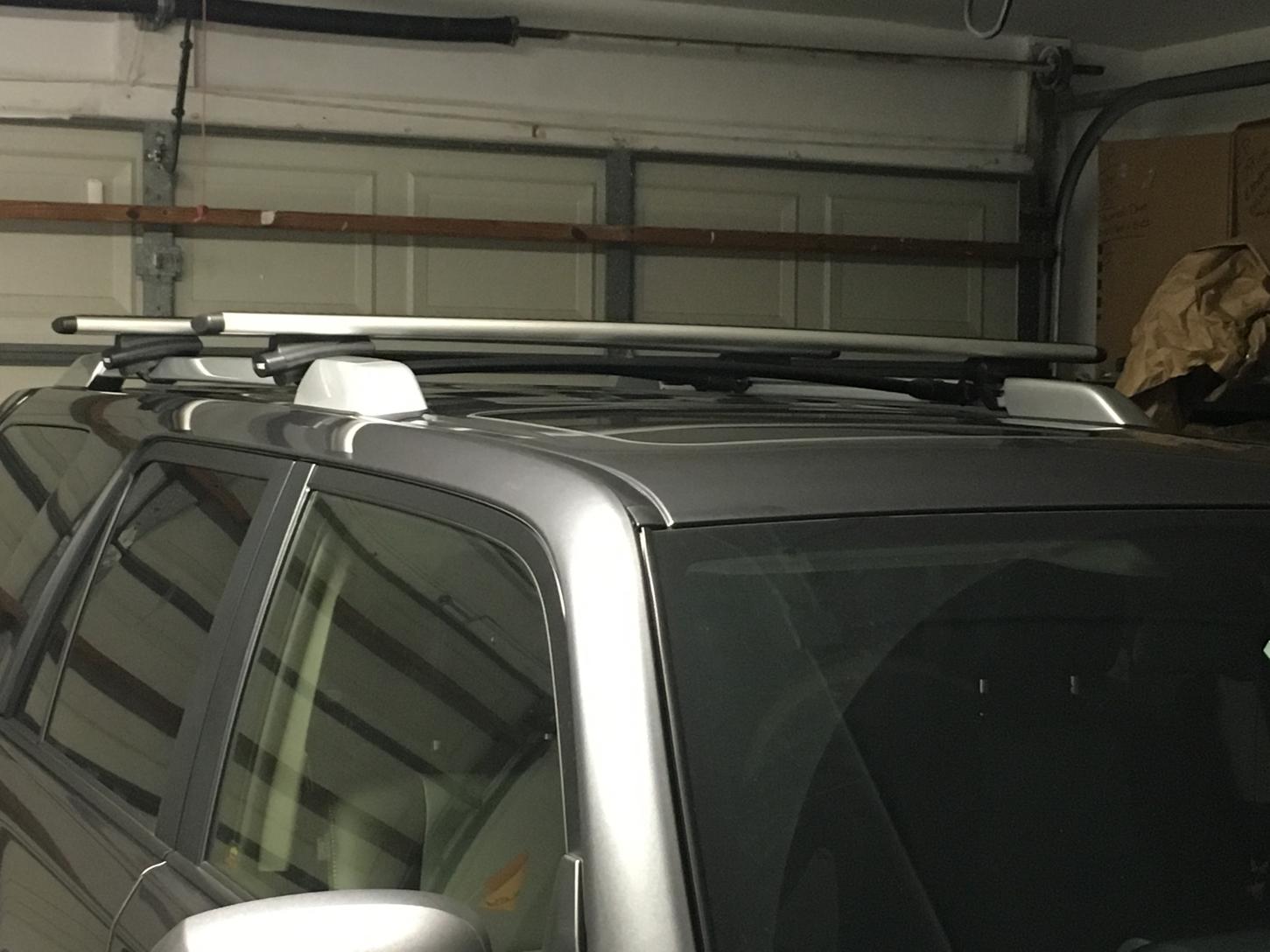

Here is a pic of the 53" unloaded like Wingsuit mentioned.

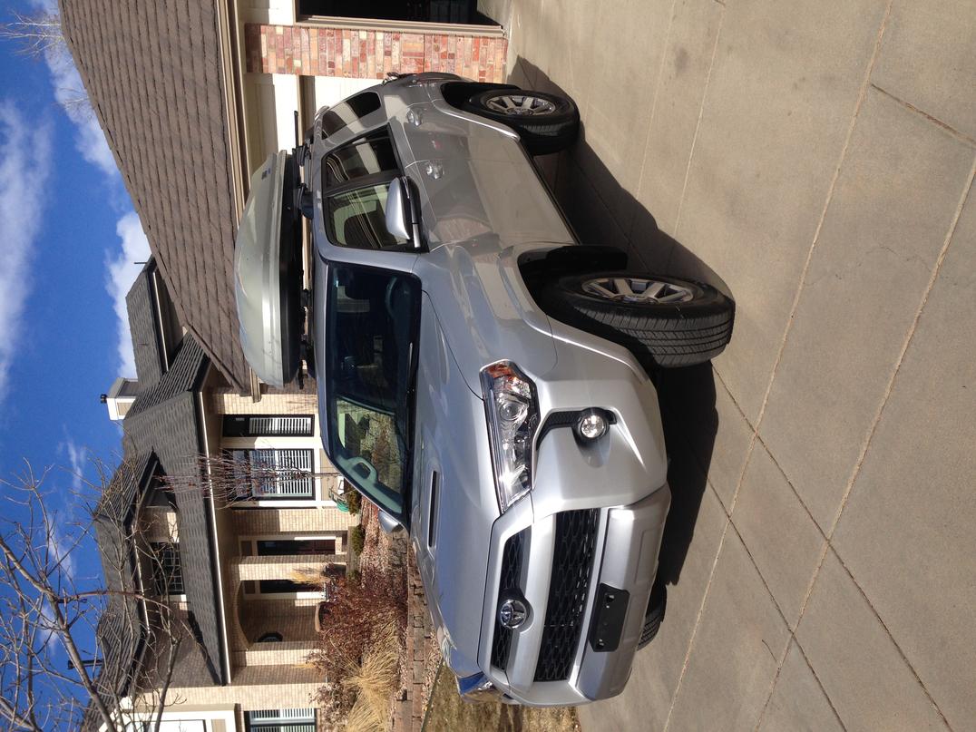

I have the 65" Thile square bars on due to needing the extra overhang for certain configurations (e.g, roofbox, bike mount(s) and fly rod box). Overhang is about 9" on each side - no problems with entry-exit from rear doors. (Sorry if the photo is sideways - can't figure out how to rotate from phone)

Also, if you are carrying kayaks/canoes, it's easier to tie the boats down with them closer to the ends of longer bars, and if you load from the side as opposed to the back like I do, it's way easier to lift a kayak up there if you don't have to set it too far inboard.

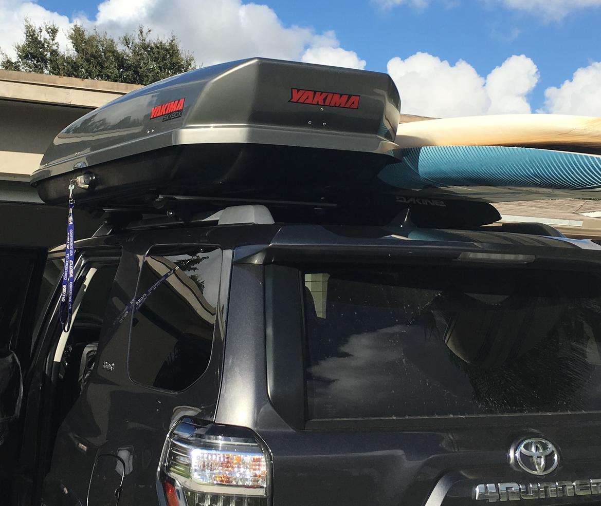

Do you have a side pick of your box on the truck? I have a yakima lo pro. I can't open the hatch fully. I hoping by adding aftermarket bars I'll get the height I need to open the back.
I can open the hatch fully and have no issues with the "shark fin" with this setup. I'm sorry I don't have any straight side pics, but here is on with a rear angle that might show you what you want to see, there is plenty of height vs the factory crossbars. Usually I run the box in the middle of the rack unless I need to put the boards on the roof (this picture was just to prove to the wife I could get it all up top).With just the box on the Aerobars I averaged about a 2-3 mpg drop at 70mph highway (approx 18mpg) from South Florida to Maryland last month. Noise is also very low, almost unnoticeable especially with the radio on and kids in the back.
