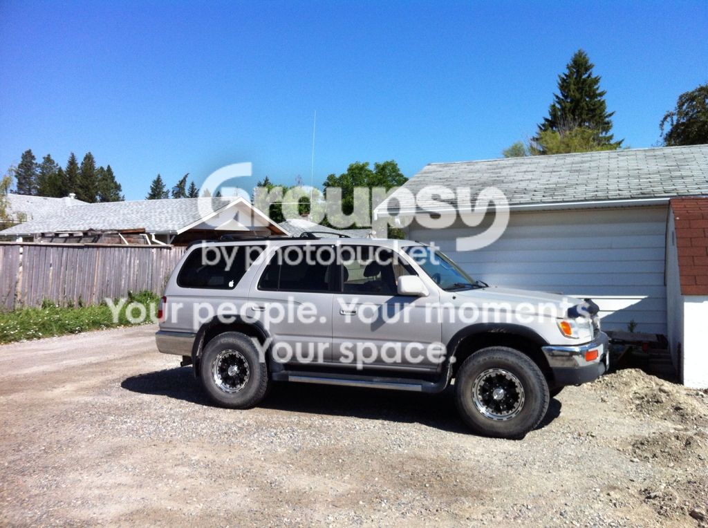

this is her taken today with about 150lbs of gravel in the back, i am also trying to get a bumper for the front in the end of this, so that has to be taken into affect.
