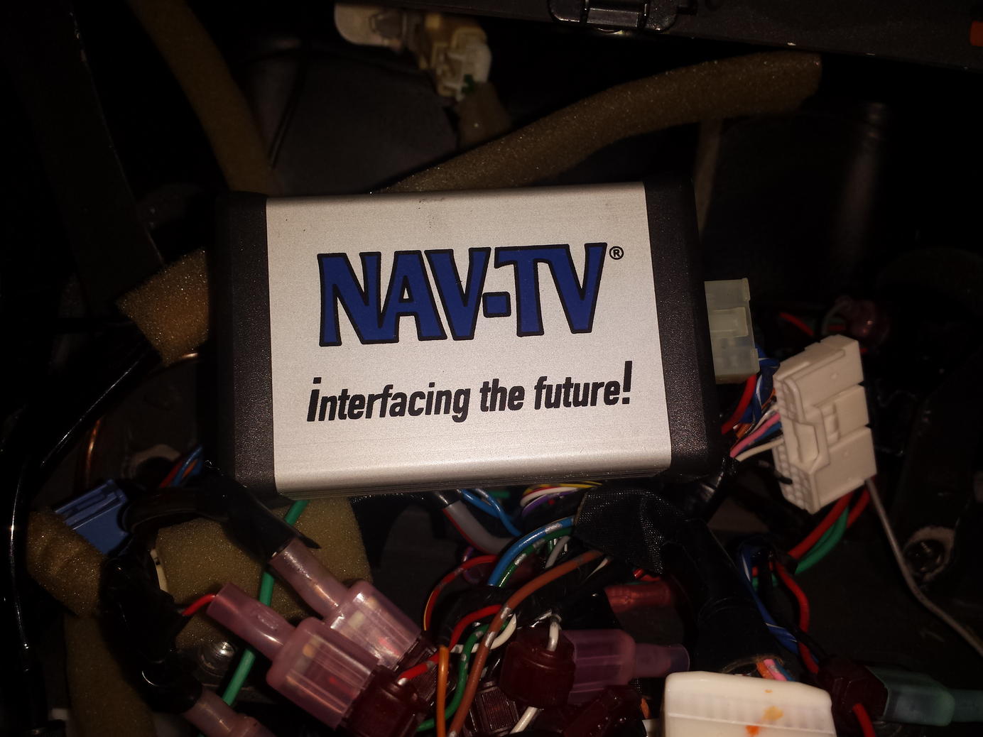

Pulled apart the dash, and there were lots of "taps" into the factory wires.
I suspected these might be the culprit, and they were.
The truck had two relays added to allow the navigation to be operated while the truck is moving. The relay was activated by a tap on the ACC line, only the tap
was loose, which caused the relays to cycle on-and-off rapidly.
This caused the ACC fuse to blow.
I fixed the tap, and replaced the fuse. Now the radio / Nav works, and the power mirrors work too!
I also saw wiring so that the rear seat DVD can be shown on the factory NAV display and the sound comes out of the JBL system. It looks great and sounds awesome !!! (when the engine isn't running). With the engine running, there are lines on the screen and the sound picks up stray noise.
I will straighten this out... I think there are some ground loops, plus I don't trust the taps. Fixing the grounding, soldering the wires, and adding some shielding to the audio and video wires should clean it right up.
