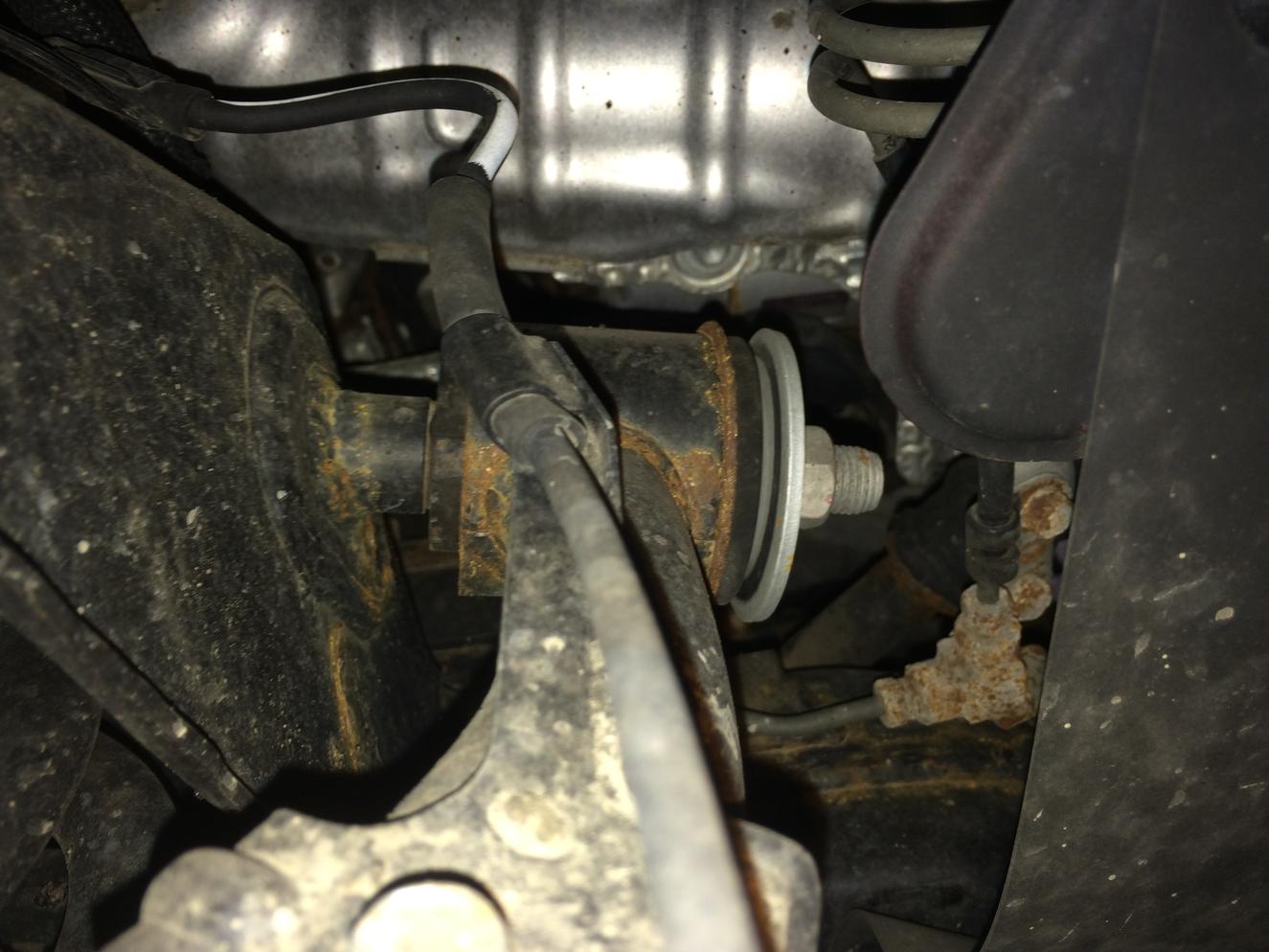

Can anybody post a picture of their stock UCA? I'd really appreciate it, as all of my searches only bring up upgraded UCA's.
I was searching for anything that could be the cause of my wheel vibration (just got new tires and still same vibration...pretty much) and metallic clanking sound when going over bumps, and I noticed that the outer washer on both arms of the UCA are a good 1/8-1/4 inch away from the rubber bushing. Is this normal?

Can you take a pic of yours for us to look at? Are the washers just flopping around on the bolt?

That doesn't sound normal. Do the washers wiggle at all? If you grab a couple 19mm wrenches you could see if you're able to tighten the bolt. Should be able to do it without even taking the wheel off. A possibility is that your UCA bushings are toast which is causing your UCA to slide back and forth a bit when you accelerate/brake. That could also cause the vibration.

The washers are pretty solidly in their place, but there is just a serious gap there. I do not have a lift installed as of yet, but I will be installing one in the next week or two. I couldn't justify spending money on UCA's for the lift alone, but I can if they really are dangerous at this point and are what are causing the vibration and noise. I'd be pretty happy if that was the case lol.
Trying to post a pic, for some reason they're not showing up when I click manage attachments.
Here's some pics of a stock UCA, since everyone else has pimped their ride already.
Here's a pic of mine. This side doesn't seem to have much more of a gap than mattr's. The passenger side of mine has an even larger gap. I'll get a pic of that one.
