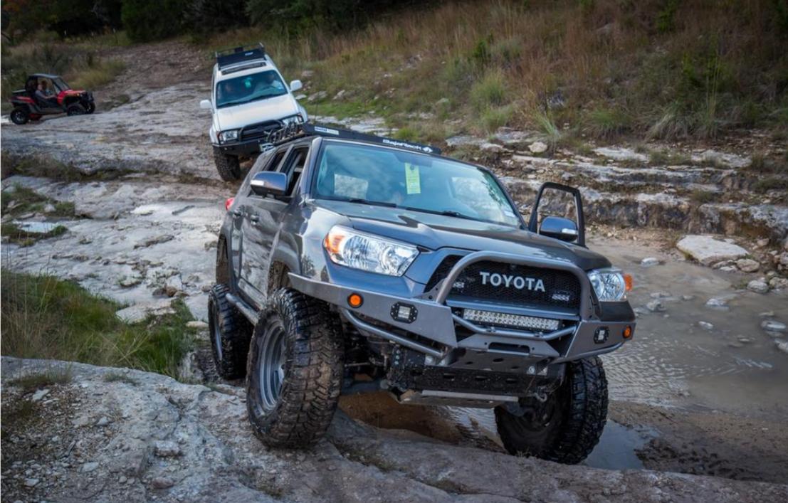

This is the bumper with the fogs they offer, and the picture I saw with the light bar installed.
There's plenty of places I could have mounted them, don't get me wrong. I already have a 20" mounted behind the grill which was my backup option. When I said I needed to find another option, I should have said I have to pick another option.
Looking at their website, that 20" bar is mounted where the winch would go. So if you're skipping the winch that might work fine, although maybe a bit high for on road use. I see the brackets there as well. You'd probably still end up blinding the idiot Prius driver in front of you. I would suggest a 20" bar mounted down from the 2 sets of 4 bolts that hold the bumper onto their front crossmember, which would be much easier to do during installation.
If you're looking for simple fog lights, I'd use a tube mount on the bottom tubes in close to the center of the bumper. Just my opinion, hope it gives you some ideas. Best of luck!
It does help, thanks a lot. I'll bring those ideas up to the shop installing the bumper and see what they think. Thanks very much and I'll post up some pics when it's installed.
