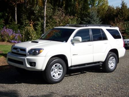

Here's a couple pics of my 08 Urban Runner with 17" 2006 Tundra Limited silver rims with Michelin LTX AT/2 tires.
I actually like the looks of these over my stock 18" rims.
I had another set of these on my 2000.

Yes both the tundra and sequoia have the same wheel, however, the sequoia version is gunmetal, and the tundra is silver.

Do those wheels have a different offset? They look to have a wider stance on 4Given's 4R.
Yes. the offset is 15mm vs 30mm for the stock wheels. Overall the track increases by 30mm (15mm/wheel). 25.4mm is about an inch... The track increase is less than the Spidertrax spacers but wider than stock.
