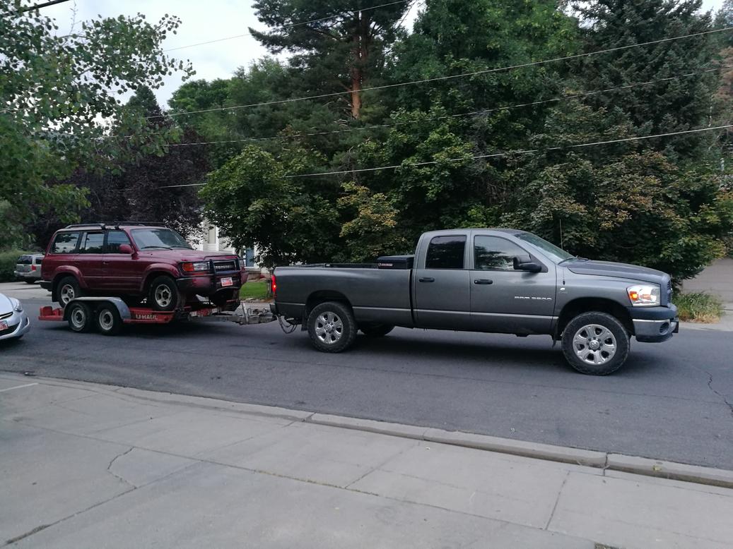

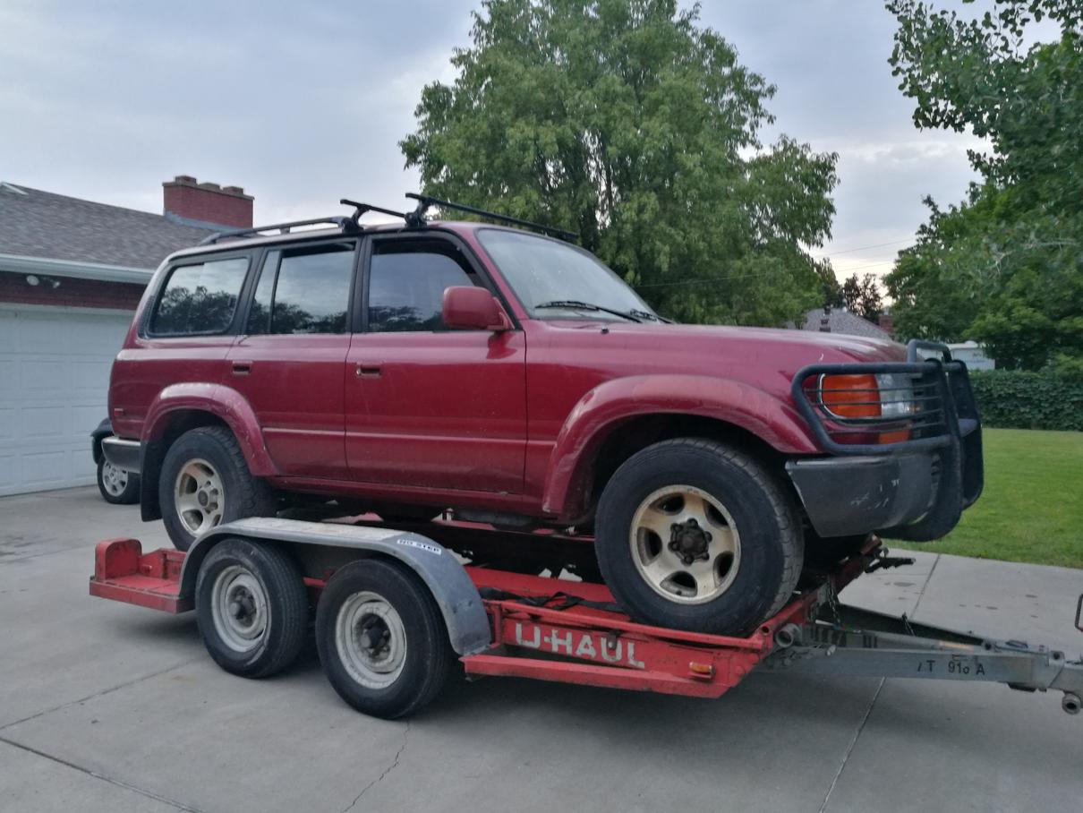

Got it home safe, it's certainly not pretty by almost anyone's standards... Now making all the tough decisions on what to do!
