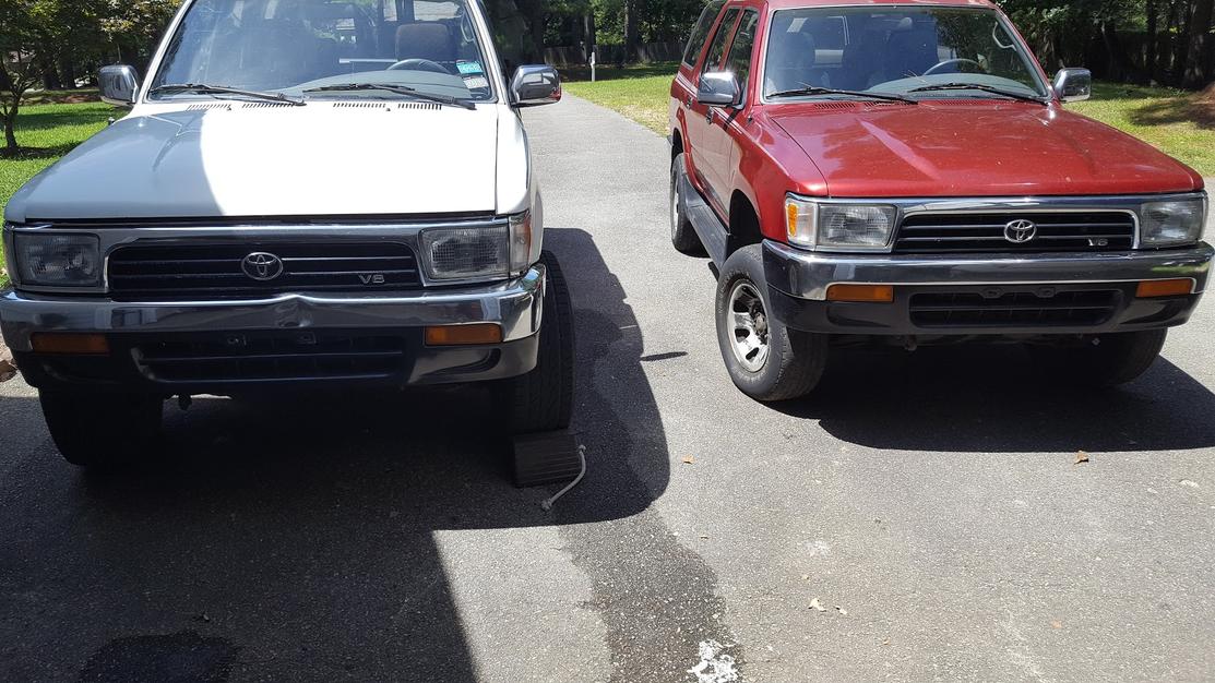

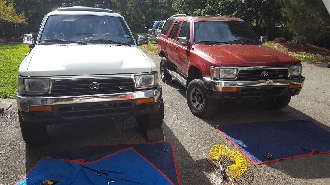

Found what I thought was the PERFECT vehicle only to arrive and find it was 2WD not 4x4. The price was right though so I bought it any way. I subsequently found a 4x4 and the 2WD has made a perfect donor vehicle.
The 4x4 had a CEL with code 24 & 52 so I need to look into those but I started with some interior/exterior swaps
Before:
During:
After:
Swapped both the front & rear bumpers since the donor ones were in much better shape
Also. the factory power antenna still worked on the red runner and the white one was broken, so I swapped them and now I can listen to the radio without static!!

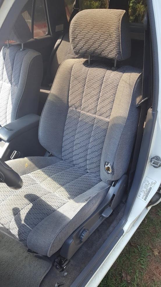

Next, I did some work on the interior... Moved the upholstery off of the donor passenger seat to the 4x4 driver seat:
Before:
After:

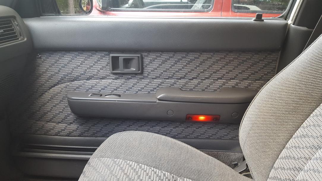

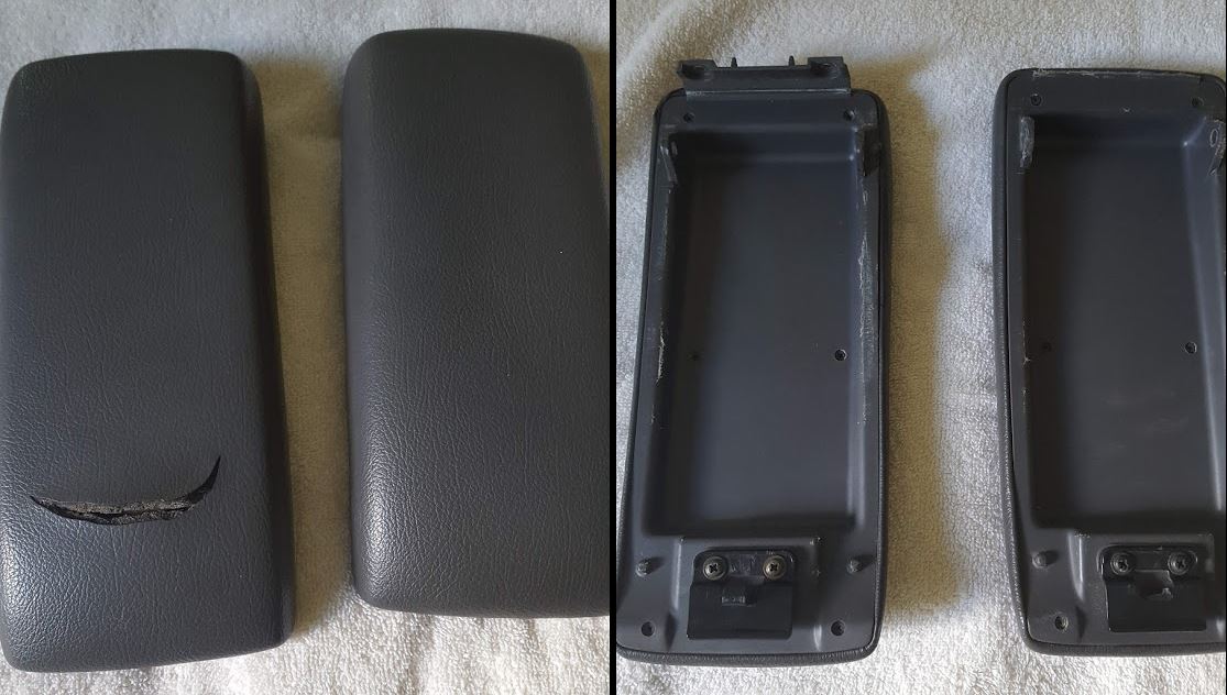

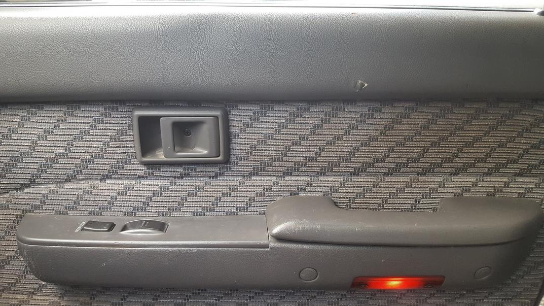

The passenger door panel vinyl (by the window) was ripped on the 4x4 but the arm rest on the 2WD wasn't in good shape so I pulled both panels and put all the good parts on the 4x4:
Bad:
Good:

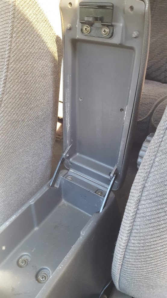

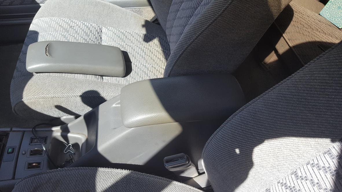

Did the same with the console lid. The vinyl was ripped on the 4x4 but the hinge was broken on the 2WD. Pulled both console lids and swapped the parts to make one good one:

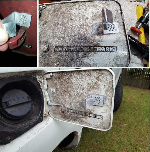

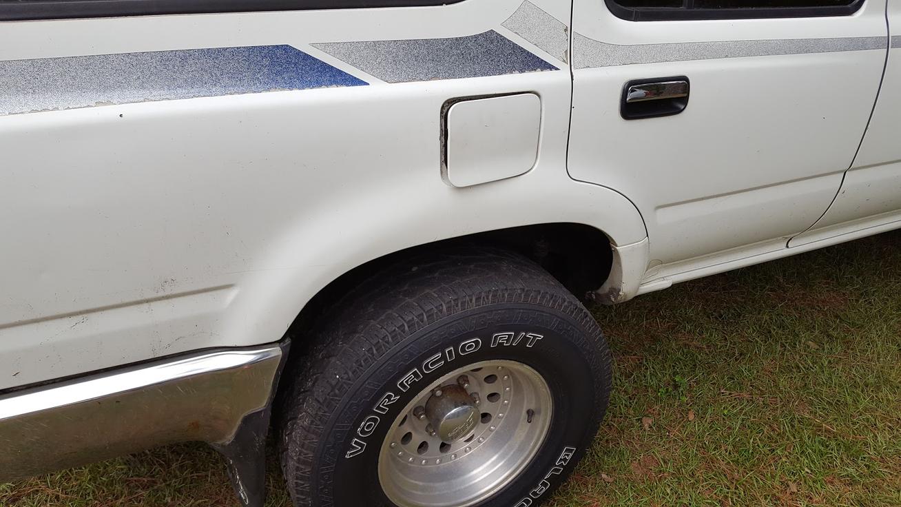

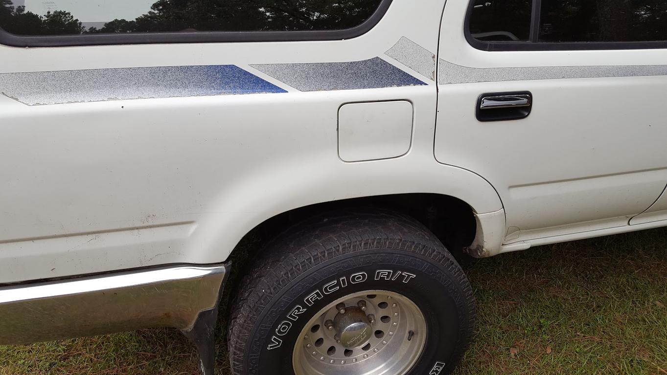

The fuel door latch was broken so the door was always open. I considered cutting the latch off the donor and epoxying it to the 4x4 door but decided to make my own. Used a small piece of aluminum stock and bent it up to match the latch. Works GREAT!!
Before:
During:
After:

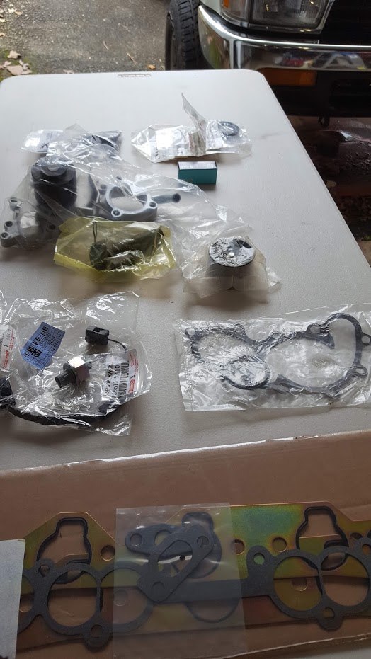

The breakdown escalated my decision making and I have decided to:
- Replace the Knock sensor and harness (bought a $13 knock sensor but have subsequently decided to get an OEM). All this work and I DON'T want to have to go back in there again if I can help it
- Replace the timing belt, water pump, tensioner and bearings

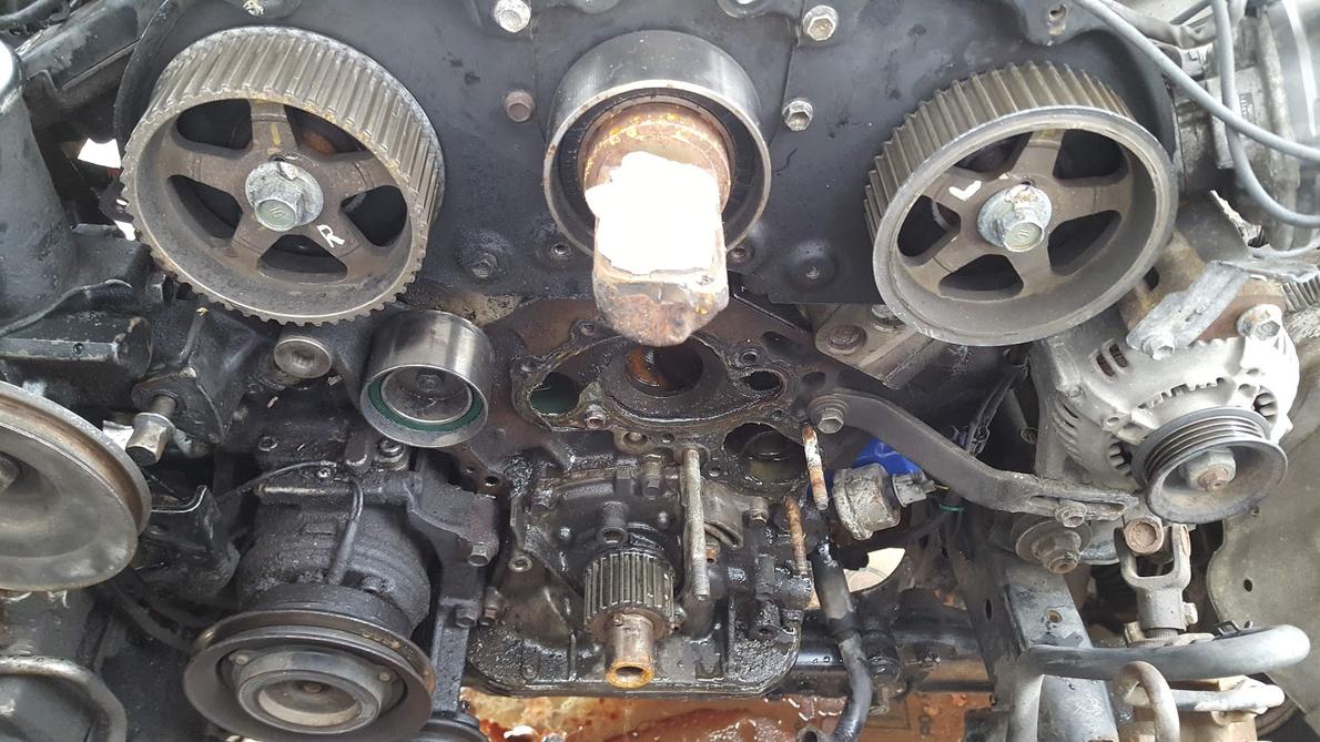

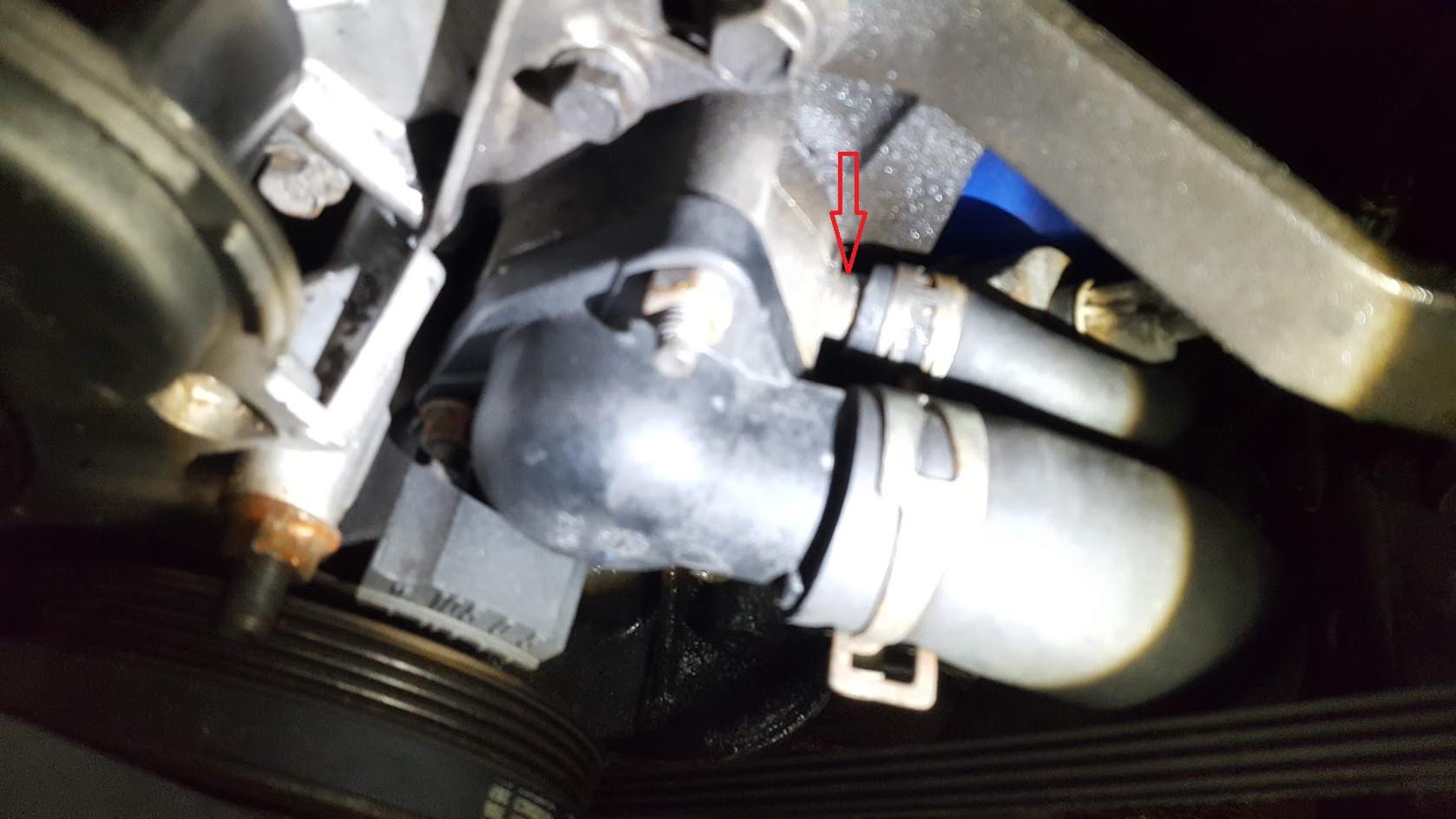

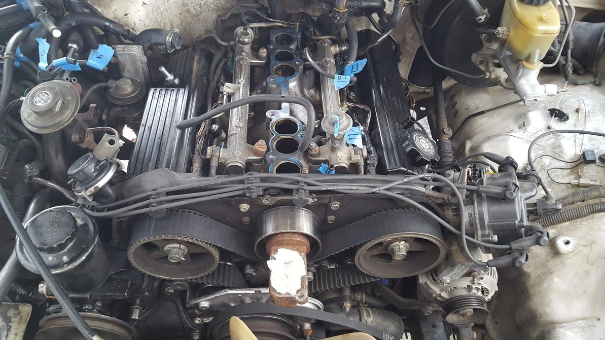

Had to open the timing belt cover to determine which timing belt kit to order ( the water pump comes with or without an extra outlet. Red arrow shows I have the extra outlet
- EGR delete
- Haven't decided on the injectors yet. Was considering sending them to Witch Hunter for testing/cleaning but they are at a 2week turn-around now. I'm not in a hurry so I may do it; just didn't want this to drag out forever...

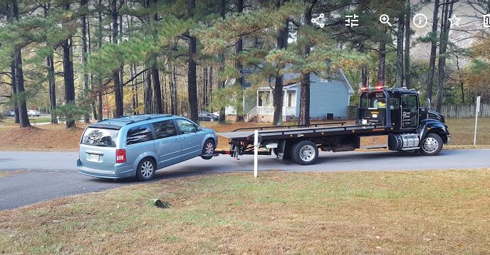

Well, as luck would have it... the 4Runner has to move to the back-burner for a bit. My wife's munchkin-mover started showing signs of possession. Random things would and would not work intermittently. After some research, it appears this is a pretty common problem with Chrysler/Dodge products and the TIPM (Totally Integrated Power Module) [the thing under the hood with all the fuses/relays] is to blame. $700 for the part :jaw:
Found a TIPM rebuilder (less than half price of new) and ordered one up. Installed it over the weekend and the van died a few miles from the house. Had planned to pull it back home but the transmission wouldn't shift out of park, couldn't remove the key - nothing worked... it was just dead. So I had to have it towed home. Have another TIPM on the way and hopefully I can get back to the 4Runner

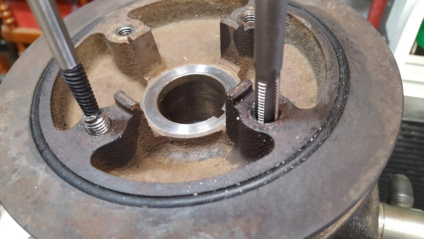

Got the crankpulley off, PO broke a bolt off so I got it out and cleaned up all the threads...

Almost got everything torn down, just need to get the intake off now...
PARTS!!

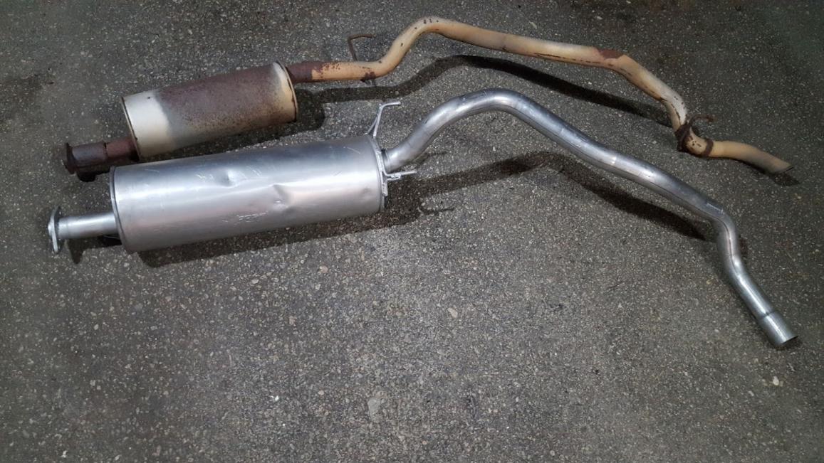

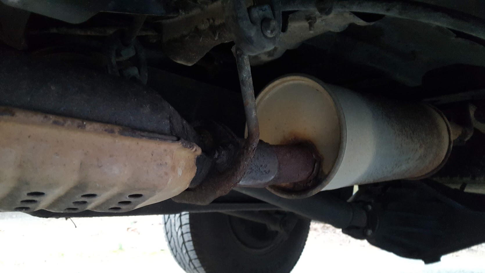

The muffler has a few rust holes so I've ordered a new cat-back exhaust - delivers tomorrow. I'll get some pics posted after that. Now I can focus more on fun mods rather than all the repairs. ...although, I'm getting the itch for a FJ80

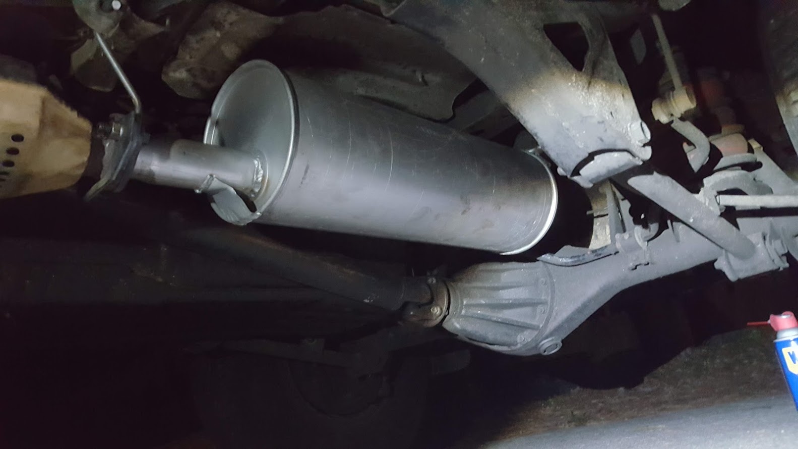

Muffler DONE!! :guitar3:
Here's the old one with the exhaust leak
I got the replacement from Advance Auto; <$100 for the whole cat-back system. Note the significant muffler size difference
