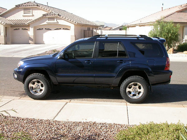

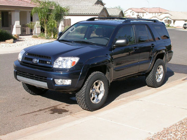

Pics of lifted 4th generation 4 Runner
Do you like the 4th gen with a lift??

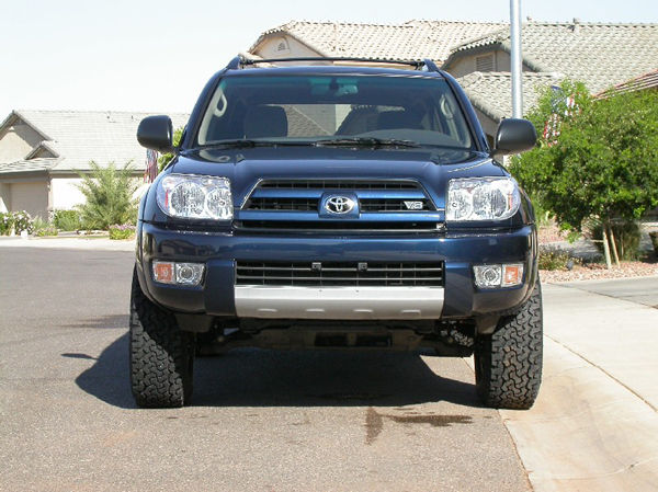

Front
