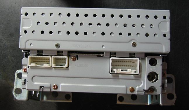

picture of the back JBL stock radio anyone?
mole177
Does anyone have a picture(s) of the back of the stock jbl radio?
my friend would like to see if it matches close towards an eclipse head unit.
TIA!
btw, is the stock nav unit for the 06 or 07 4runner an in dash cd changer or just single cd and single dvd ?
Here's the rear of the '04 JBL 6 Disc unit:
(Refresh this page...I replaced the pic with a better one.)
