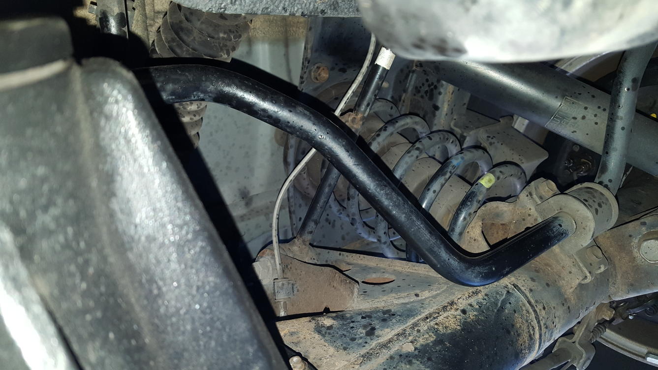

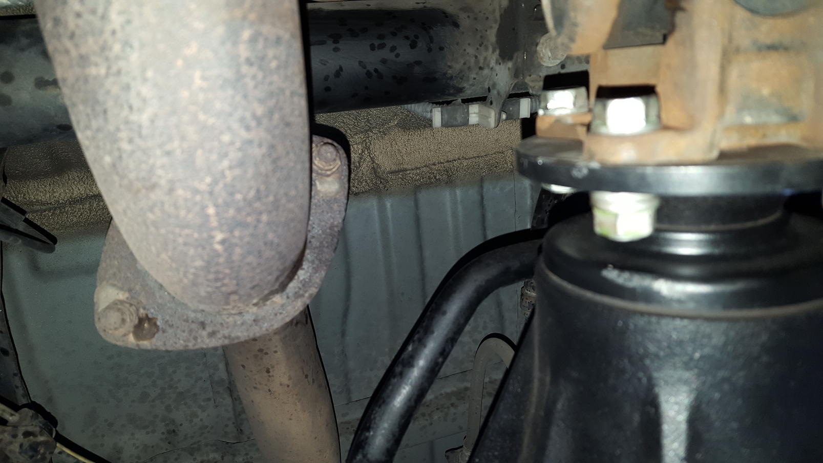

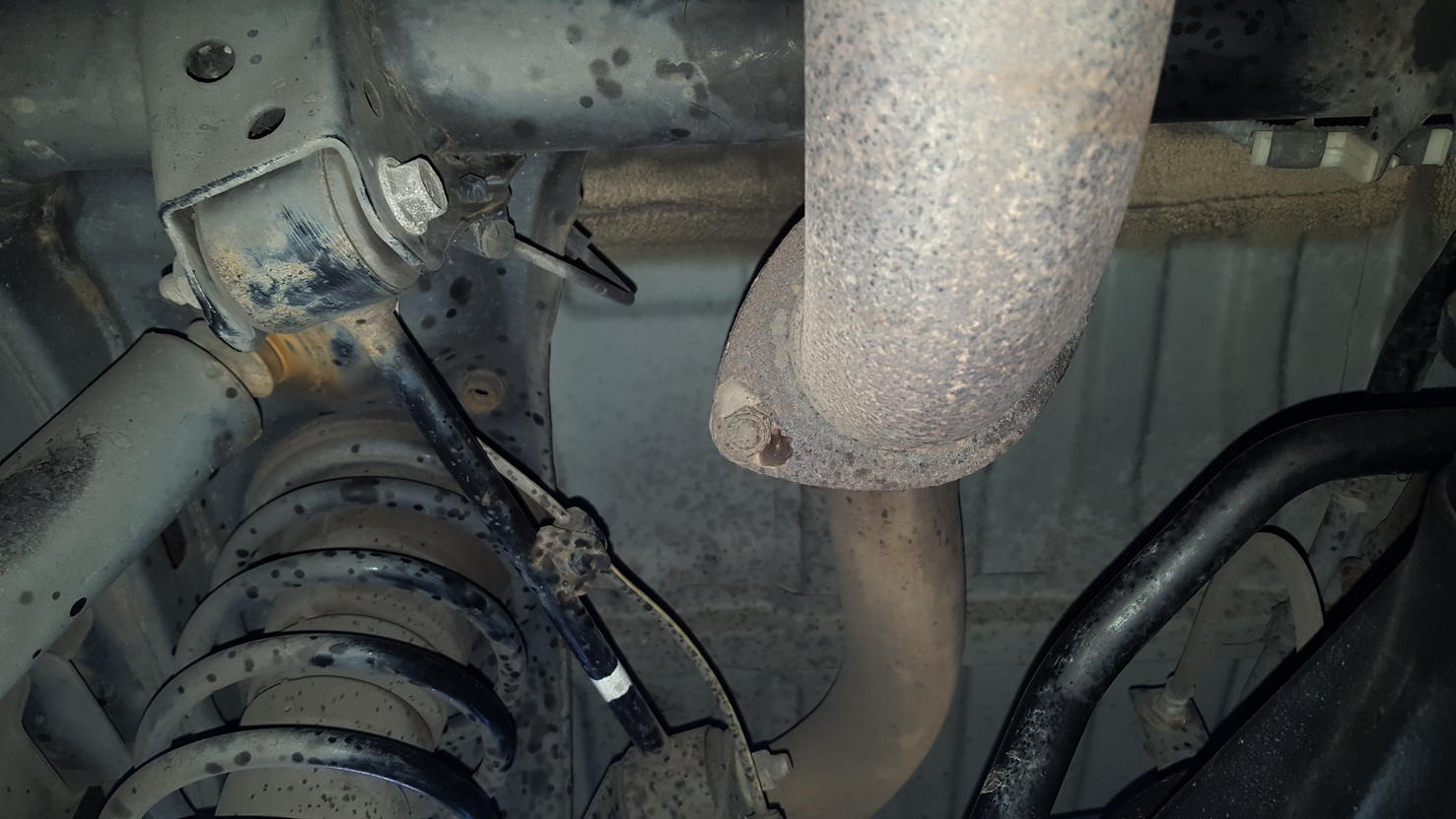

New breather, no pressure and still flinging oil....
Attached photos show the fine oil spray dotting the underside components.

Undercarriage very clean! I don't know how many miles you have put on since the new pinion seal was installed but would suggest you let it seat in over a little bit of time. Good idea to keep an eye on fluid level as you suggested.
Seems like you ought to be able to see some fluid around the outside of the seal if it was leaking although wouldn't take much fluid to make those spots. If you are having trouble verifying the source, you could take some aerosol foot powder and spray it around the seal and on the flange to show the track. I guess I would replace the pinion seal if it persists but would really like to see you verify exactly where it is coming from.

Immediately started spraying after 40 miles of driving.
I know a marlin crawler seal was installed.
Also, I can SE some slight oil at the flange side with the dust cover next to the diff.
I wonder if oil got pushed past when the old breather was there and now it's sitting on the outside of the seal.
Like you said, it's not very much coming out, as I checked the fluid level again today after 80 mikes driving and still just below the fill hole.
