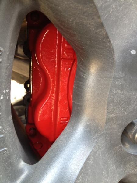

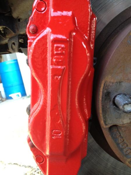

I didn't have spacers at the time, so something had to be done for clearance. I read about some folks cutting down the wheels a little bit but I didn't like the idea of weakening them or putting them out of balance. Instead, I took a little meat off of the reinforced portion of the calipers. Call me crazy but I would rather a brake fail than a wheel on the highway, at least you would still have the E-brake. Now that I have spacers I need to return back to the stock Tundra calipers, but they have performed beautifully so far.
You can see the clearanced part of the caliper here.
Of course I had to paint them up purdy.

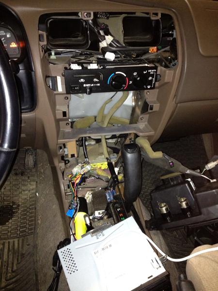

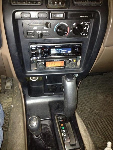

Next up was tearing out the old stereo and amp, plus the DRL's. Went back with a kenwood head unit and a 2 meter radio below it.

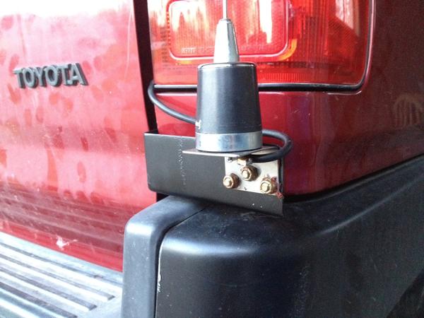

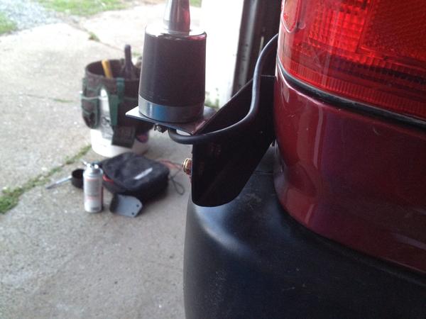

I also fabricated an antenna mount like others have done, and mounted a 5/8 wave whip to it.
