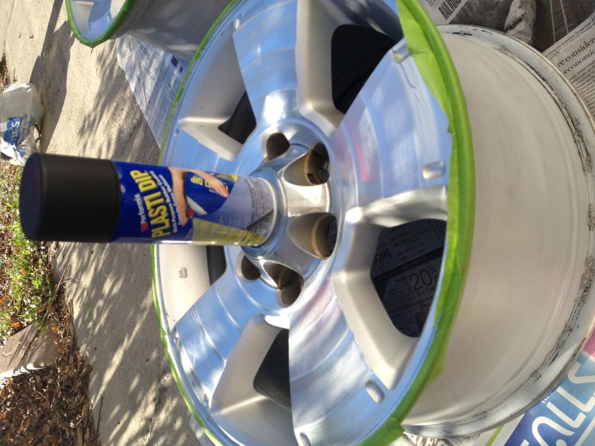

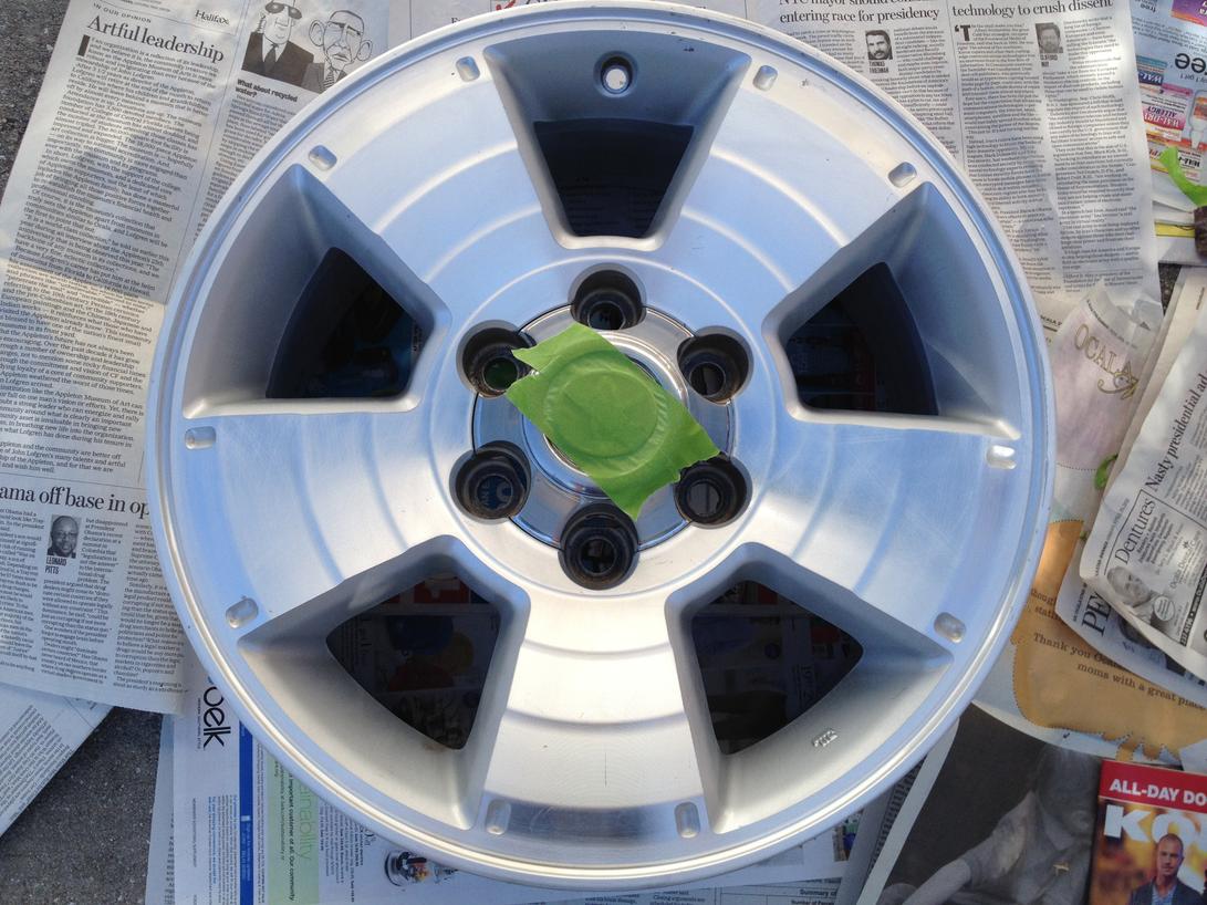

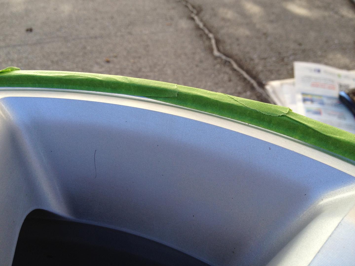

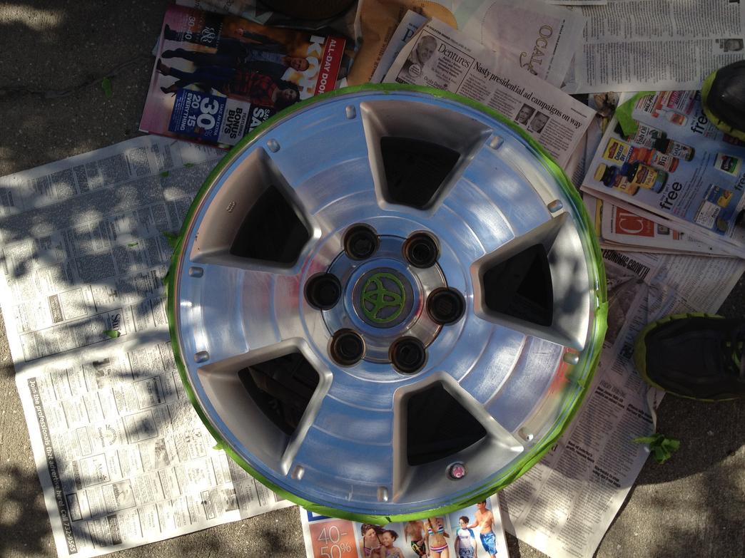

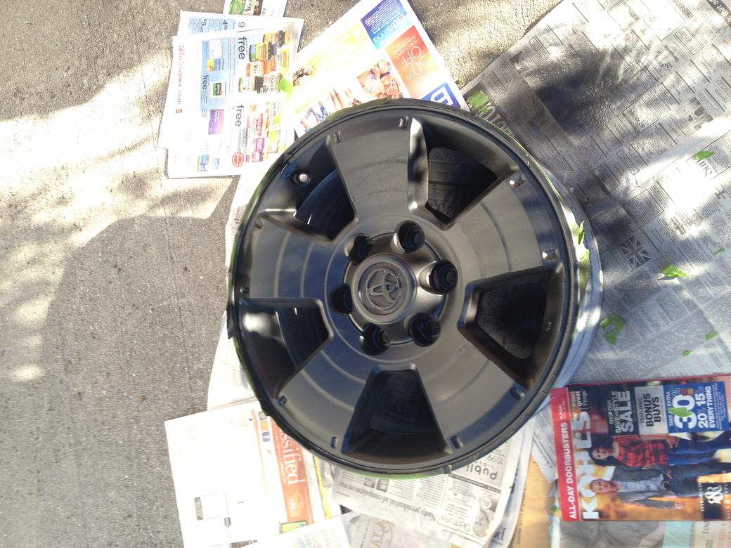

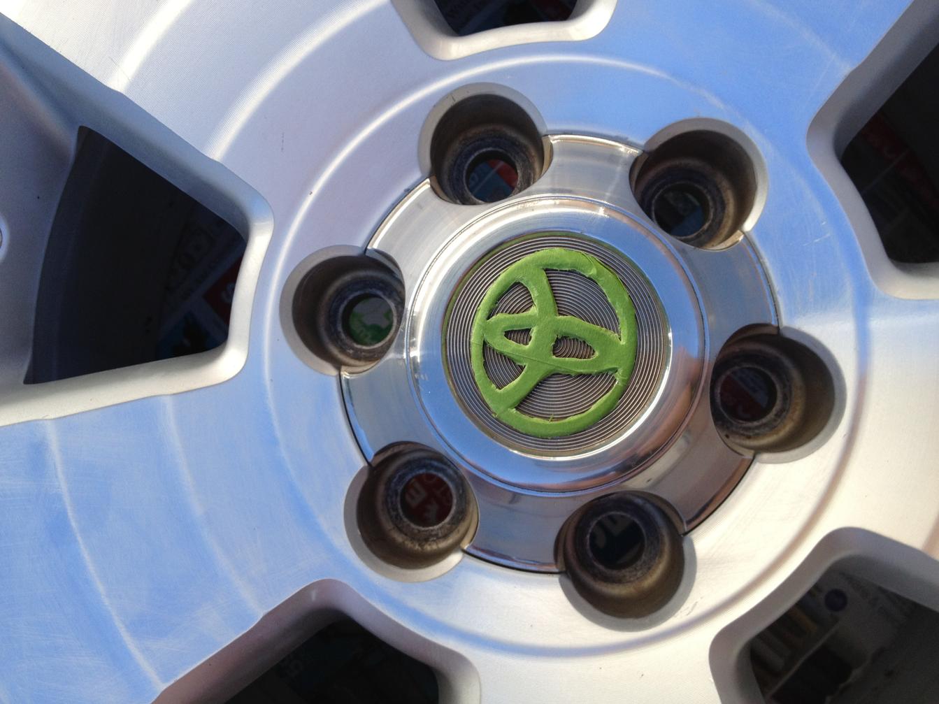

The first picture is taping over the Toyota Symbol. We then used an exacto knife (or a razor blade) to cut it out. Then we taped off the lip around all 4 rims. We used Plasti dip, found it at Lowes for 5 bucks a bottle. We did 3 coats (I had the best luck doing the first one rather heavy and using the other 2 to more touch up the thinner spots).

Tomorrow i will be taking off the tape around the Toyota symbol and lip, then re-taping AROUND it this time to prep and paint for the white or silver. Still haven't decided. I'll post how they look tomorrow when they're fully dried. Also painted the backside of them just real quick so help get the hard spots on the front.

Thats true. One day im going to upgrade rims, but not anytime soon. Im BROKE, so this definitely needs to last. I have nothing but good things to say about plasti dipping right now. They have covered the scratches pretty well, and i really like the flat black look. My real test right now is if itll pull off the tape.
