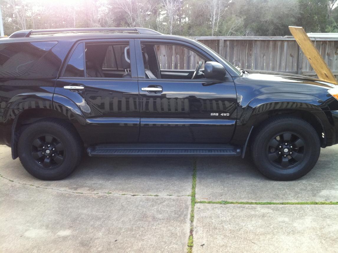

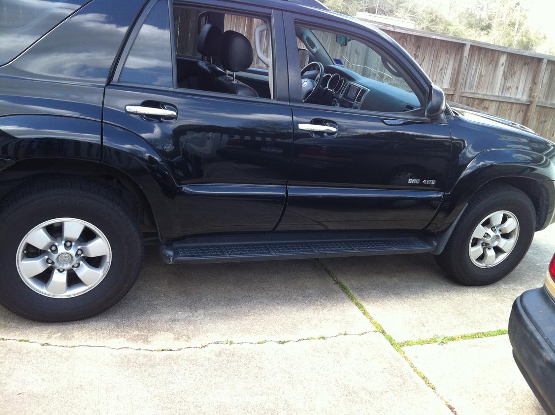

First I was just going to do my emblems, then I thought that the silver insert on the front and rear bumpers didnt look right so I did them too. The wheels are next once I get new rubber. What do you guys think?

:cool: I love the blacked out emblems, mine are "black chrome" right now but I think I'm gonna redo them w plasti-dip or matte-black paint.
my whole runner used to have the silver accents / chrome trim/letters..... ive stripped and painted all silver to flat black and de badged the whole car.... black looks way better than any other accent color IMO
I've been thinking about this for a while and plasti-dip seems way more appealing than sanding and painting, how did you detach and reattach the emblems without messing anything up? Any tips?
I didnt detach anything, thats the great thing about plasti-dip, taped a square shape around emblems and coated the whole area, paint and everything. Peel the tape and paper off and the excess plasti dip will pull off clean around the emblems, just make sure its dry and peel slowly. For the insides of the emblems I used a tooth pick to puncture a hole in the PD and pull it out. If anything be sure to coat the area you have tapped off thick around the edge of the tape, its easier to pull off the paint the thicker it is.
WTH is this plasti-dip stuff? Those emblems look great!! I just bought some black bumper coating to redo that step on the rear bumper that's fading pretty bad, but I might do with this stuff instead.
Looks really clean man. Is it permanent, or does it chip easily?
Well from what I understand its permanent until you peel it off. As far as durability I havent read any thing negative on it thus far. Im sure I will find out with having that piece on the front done, Im sure it will see its fair share of rocks. Also if you dont like it, it will peel right off, kinda like skin after a bad sunburn :) I got mine at home depot for $6 a can, didnt use but maybe half a can for all I did.
