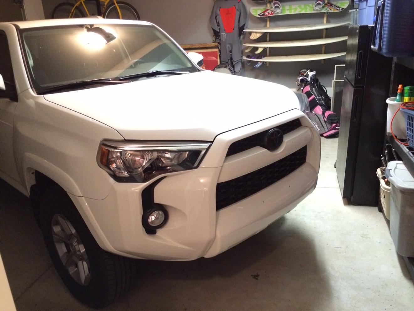

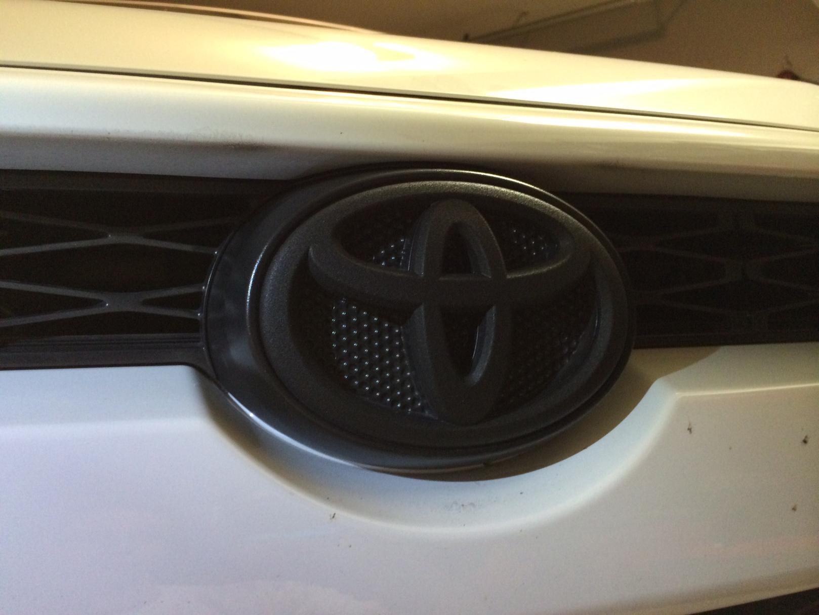

Sweet, thanks! Mine is textured but not rough as well so maybe not far off from you. From photos I'd seen I may have overestimated how smooth it's actually supposed to be. Here is the proof...
looks great, I'd like to do this on my white, along with the rims...stormtrooper style
Native, photos for your benefit also... Also, post pics if you do the rear black. I'm really happy with the front but am debating if I want the rear as obvious as black-on-white will look. I'm wondering how closely the white would match and am debating using that instead...

looks great from distance, yours does look a little more textured then mine does getting dark here now, i will try and grab a really up close daylight pic tomorrow. the only thing i could think of is the temperature (never mind that now i just saw you are in SOCAL) and it taking longer to dry each time, when i did my Titan in the colder months i gave it about 30mins between coats.
