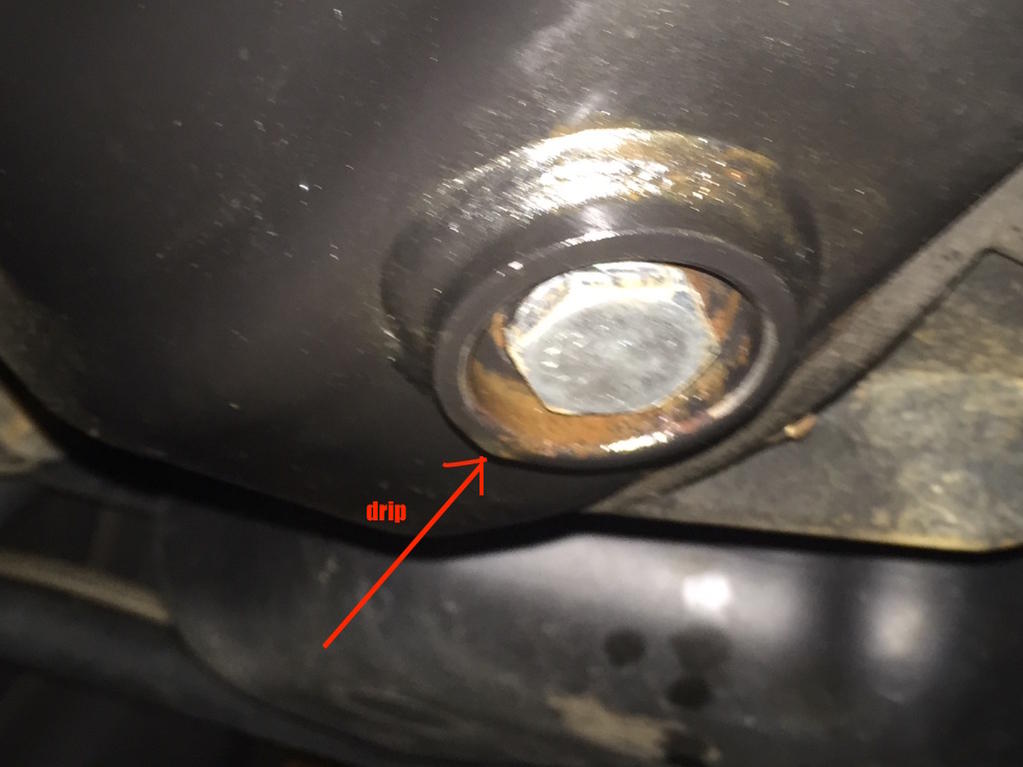

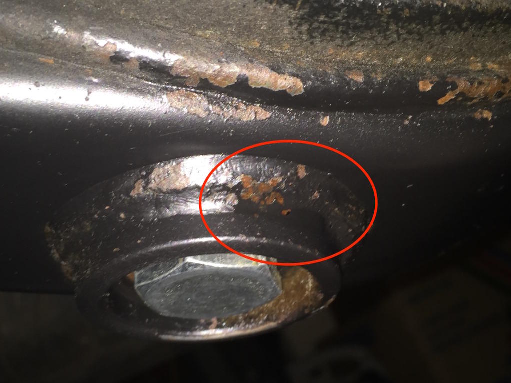

Leak not coming from plug but from weld around outer ring. Seems to be seeping through a bad weld. Pictures show plug dry and area on outside of ring oil drip. Wiped it down took picture, circled area it is leaking from in red.
I'm guessing it will have to be ground slightly then welded. Any thoughts? Thanks

As a first attempt I would sand the affected surface clean and then apply some JB Weld as previously noted. If that does not work then you can grind it down more so and weld it with no problem. Seems to be an easy fix. Start with the easiest/cheapest option and go forward from there.
Are you positive it's leaking from the weld?
Try spraying it down completely with brakleen so it's dry and oil free then monitor where it's leaking from.
That's really annoying, and super rare I imagine especially considering that diff looks like it's never been offroad. I'd be prone to send an inquiry to Toyota corporate about it simply because we have no idea what the rest of the welds look like (not to blow a small problem out of proportion, just curious what they'd say).
JB weld makes a product specifically for fuel and oil tank repairs. There are several other manufacturers that do also. I remember a thread on here where another member had the same issue and I believe it was covered under warrantee.
If not covered under warrantee I would patch it. The differential is not under pressure and a good stop leak should do it.
I think I remember this too (but not the outcome).
I'd go after this under the powertrain warranty.
I don't see why applying a bit of MIG or even better TIG weld in that area of trouble is a big deal. Drain the differential, grind some of the paint and contaminates off in location of leak and apply good quality weld seam. Correct me if I'm unrealistic but this has to be simplest and the best fix for such issue.
Yes, I would weld it... It's super easy right there and is the best most permanent fix and difficult to screw up.
You can do that with just about any welder (even flux core or stick). Nothing to it.
Yes coming from weld. Hard to see in picture and in person. I will try the brake spray to be sure. Thanks
