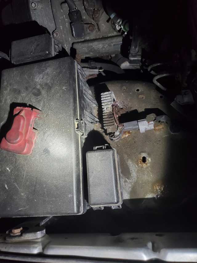

Hello,
Can you be so kind as to please help me identify what this is?
I've searched everywhere with no luck.
its located on the driver side in the engine bay, right behind the box with all of the electronics, please see it here.
Thank you in advance!
[MENTION=150773]nos145[/MENTION] Not seeing any pictures. Can you upload some?
*Edit- see it now. Blended in with the forum-redirect underline links in the rest of the sentence...
That looks like a relocated voltage regulator to me. Normally they are attached to the alternator, but it is possible ti is slightly different in yours. Was the alternator replaced at some point?
*Edit AGAIn - It's the fuel pump resistor, part 23080-50130 courtesy of [MENTION=9776]techno[/MENTION] below.
voltage regulators are always inside the alternator on modern vehicles.
