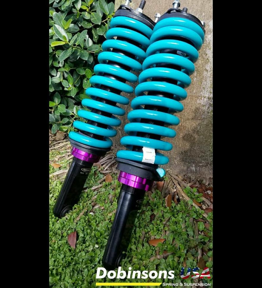

We have a few shock projects running right now and one is the monotube non-resi strut version as well. I've attached a photo. These are for a Hilux, but they give you an idea. Resi's are great and all and help with big travel suspension, like solid front axle trucks, and on the rear ends of most 4x4's, but on IFS vehicles it may not always be needed based on the limited amount of wheel travel. Plus, depending on the type of driving that people want to do, they simply don't really need it. Also losing the resi costs less, so it can be sold for less.

For the OP - this is what I would seriously consider ^. Buy the two fronts in non resi version when they're available for the 5th gen for $520ish, buy rear shocks for ? and rear spacers for now. Then upgrade to rear springs as you can afford it later. Correct me if I'm wrong, but the GX470 probably doesn't fit due to the lower control arm bolt being 12mm on the 120 platform and 14mm on the 150. I don't know what Tacoma's use. So you'd need a 5th gen specific front set.
