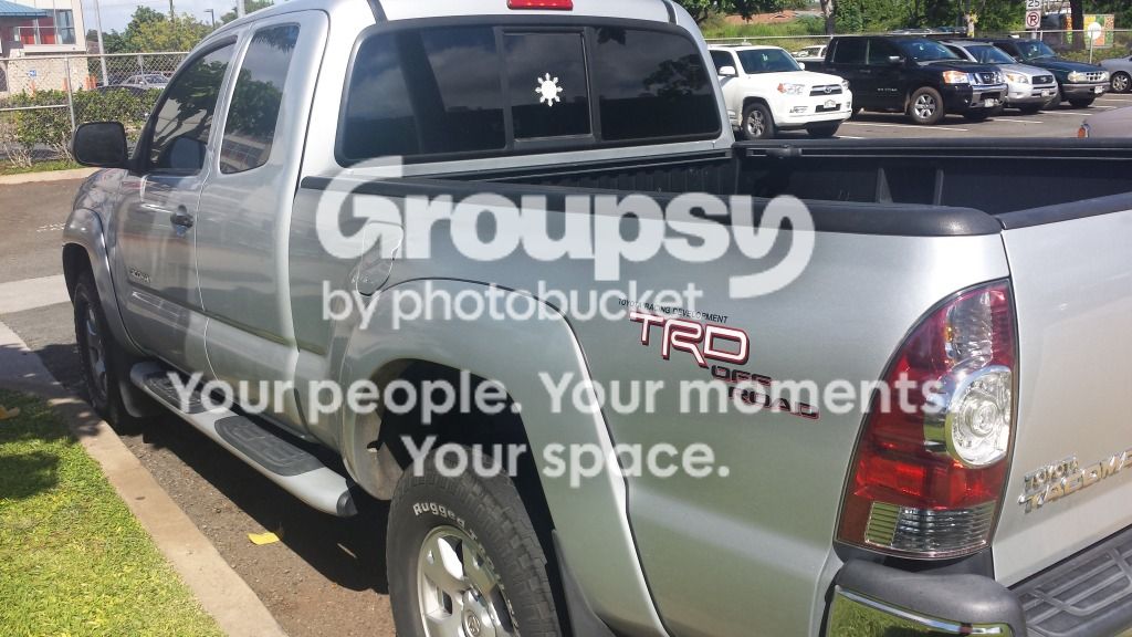

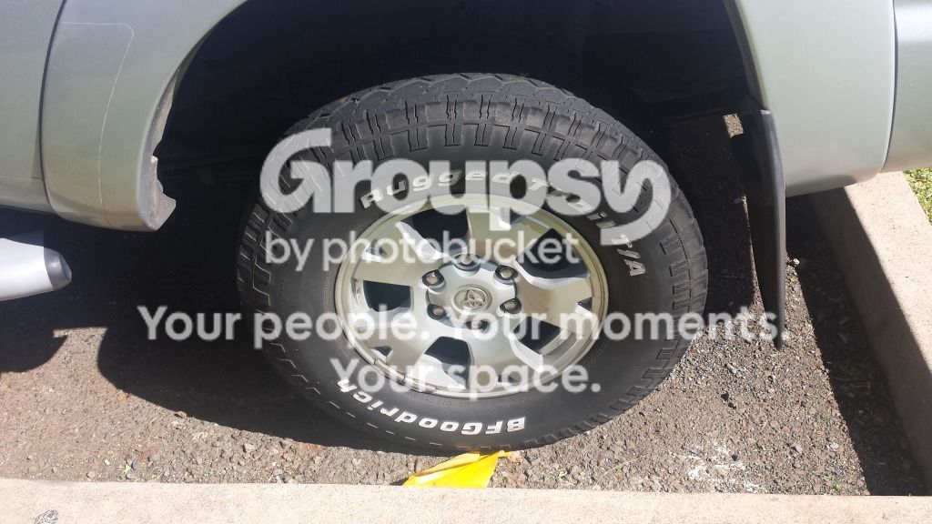

Please help me get a new tires for my tacoma
I bought a brand new tacoma last 2009
Its a offroad prerunner trd rear drive
It came with stock tires
225/70r16
20141121_113021_zps198ec8ac.jpg~original
20141121_113012_zpscc3b945d.jpg~original
its about time to changed tires
I called around for the same stock tires
And all of them told me I have the wrong size tires on my truck
So I begin to search online for a tacoma with the same tire size
To no avail.
Can someone help me with the correct size tires?
Good year tells me I can use
Goodyear duratrac.
265/75r16
Or
245/75r16
Can I use any of this tires on my stock tacoma?
Thank you for all the help
Much appreciated
John
Yes, you can use the sizes you posted however, the 265/75 will be a tight fit and may even rub just a bit. You can also use a 265/70/16 if you find them.

Anyway, [MENTION=117100]Hardrive[/MENTION], your OEM tires that mentioned have a diameter of almost 29". If you were to purchase the Dura Trac (which, by the way is a fantastic tire and I run them on my T4R) the 255/70/16 has a diameter of 30.1" and the 265/70/16 has a diameter of 30.6". You could absolutely install the 255/70/16 and have absolutely NO RUBBING. If you bump it up another half an inch to the 265/70/16, you may have to do some very minor modification to prevent rubbing, but you could do it. Good luck, from your cousins over here on T4R.org!
My friend just installed 265/75r16 Nitto Terra Grapplers on his stock '08 prerunner and they fit fine with no rubbing. We ended up removing the mud flaps because he liked it better without them but he said he wasn't having any rubbing before we did that.
The Duratracs might be a little more squared off but I would think they should fit if the TGs did.
